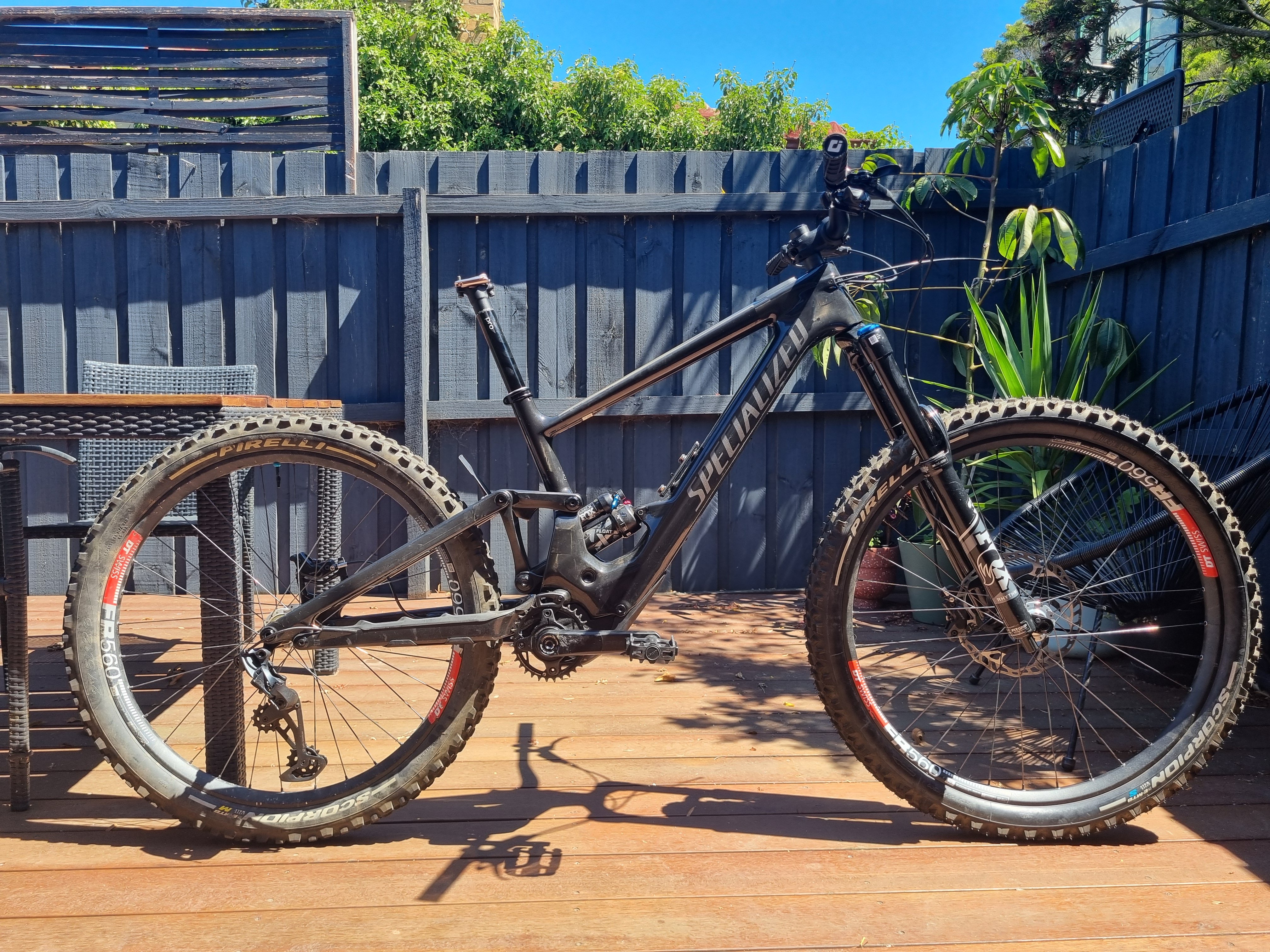

Hi all.
New KSL owner here. Picked up a Comp 22 model cheap last week after riding a KenLevo (Cascade LSK) for the past 18 months. Wanting a second eMTB and a park bike and thought a well priced Kenevo SL would tick both boxes.
Photo below is its current state and how it'll have to stay after breaking my arm riding 2 weeks ago (x-ray attached because it's gnarly).
Current and future plans:
- mullet
- 230x65mm shock (remove Float X spacer) and it'll get my EXT Storia coil off my KenLevo for bike park. Should get 177mm or so travel with that. Same mounting hardware ftw.
- 180mm 38mm fork. Currently keeping an eye on secondhand stuff.
- shorter cranks - anyone got a good lead on 155-160mm cranks for the SL 1.1?
- Lewis LHT Ultimate or LHP U4 brakes so both bikes share common pads and spares.
- rigid seat post. What you see here is what's gonna stay for bike park days. Cutting the post down and slamming it for park. Dropper back in for regular riding.
Anyone else running a similar set-up and have insights?

KSL is a lovely bike especially with a Storia. (And a Zeb) You’ll need the short remote reservoir as the std one hits the frame in the hoop.
275 rear works great. Turns in better in tight terrain. Stringer wheel. More mud clearance. 338BB height with head mid (about 64deg) and chainstays in high BB position.
45 stem cuts the XL nicely. I needed a 50 rise Burgtec bar as the headtube’s relatively short.
Michelin DH 22 front DH16 rear.
160 crank works well
Specialized M30 praxis Crank 160mm bestbike.de
Praxis Works LEVO SL CRANKSET ALU MODEL 20/21/22 SL SYSTEM, M30, 160MM R+L ARM - LEVO SL CRANKSET ALU MODEL 20/21/22 SL

I’m running an S5 with 180mm Zeb and 165mm Alu praxis cranks.
You might find it very slack with 180mm up front and the mullet rear wheel, depending on how steep the trails are in your area? I had to run the headset in the steeper setting to keep the wheel from flopping, but the areas I ride are relatively flat…

180 is ok I think with 275 rear. Head mid. . Sags more. Mines a 180. BB at my target 338mm static.
I’m used to flop as I got the Geometron bug in 2015. Once over walking speed I like it. I rarely get chance to ride proper steep.
