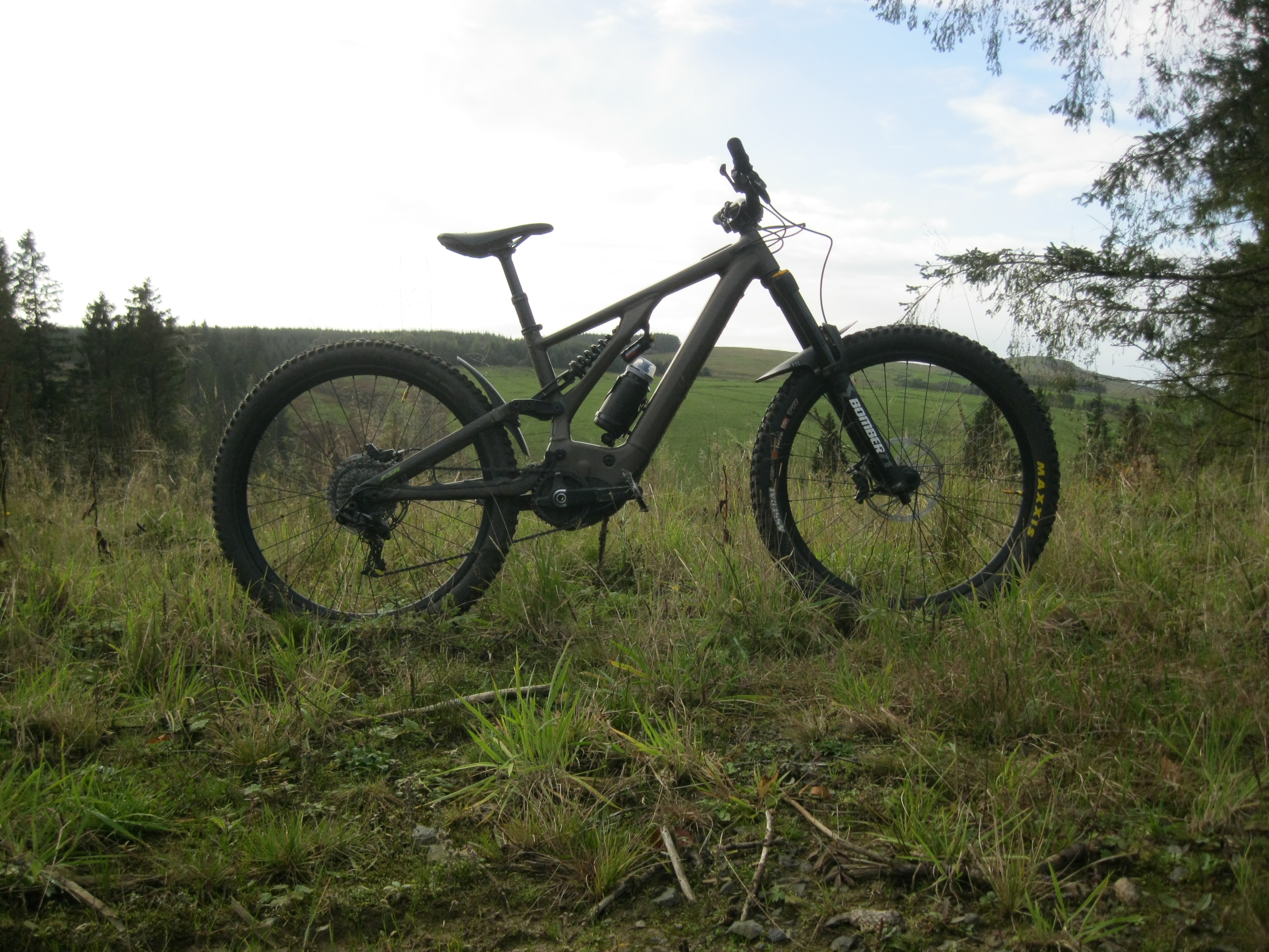

A picture of my 2020 today at the bikepark, just because.
Wearing the 27.5 front wheel instead of the 29 for a change.
3+ years of ownership and still no desire to change it.
