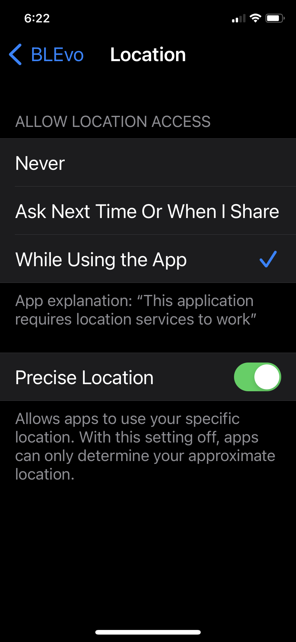

Am I the only one having issues with Blevo shutting off less than a few seconds into a ride? Lately I need to keep checking and restarting Blevo. After the 4th or 5th try it will stay on for the remainder of the ride. No idea what has changed. This is with an iPhone if it matters.

I remember my Android version misbehaved if I didn't set location permission to 'all the time'. Maybe you got an update that modified your permission settings?
I keep my phone in my pocket with the password-protected lock screen active. I guess that means BLEvo is not running in the foreground, which is why the permission needs to be 'all the time'.

Doesn’t even look like that’s an option.

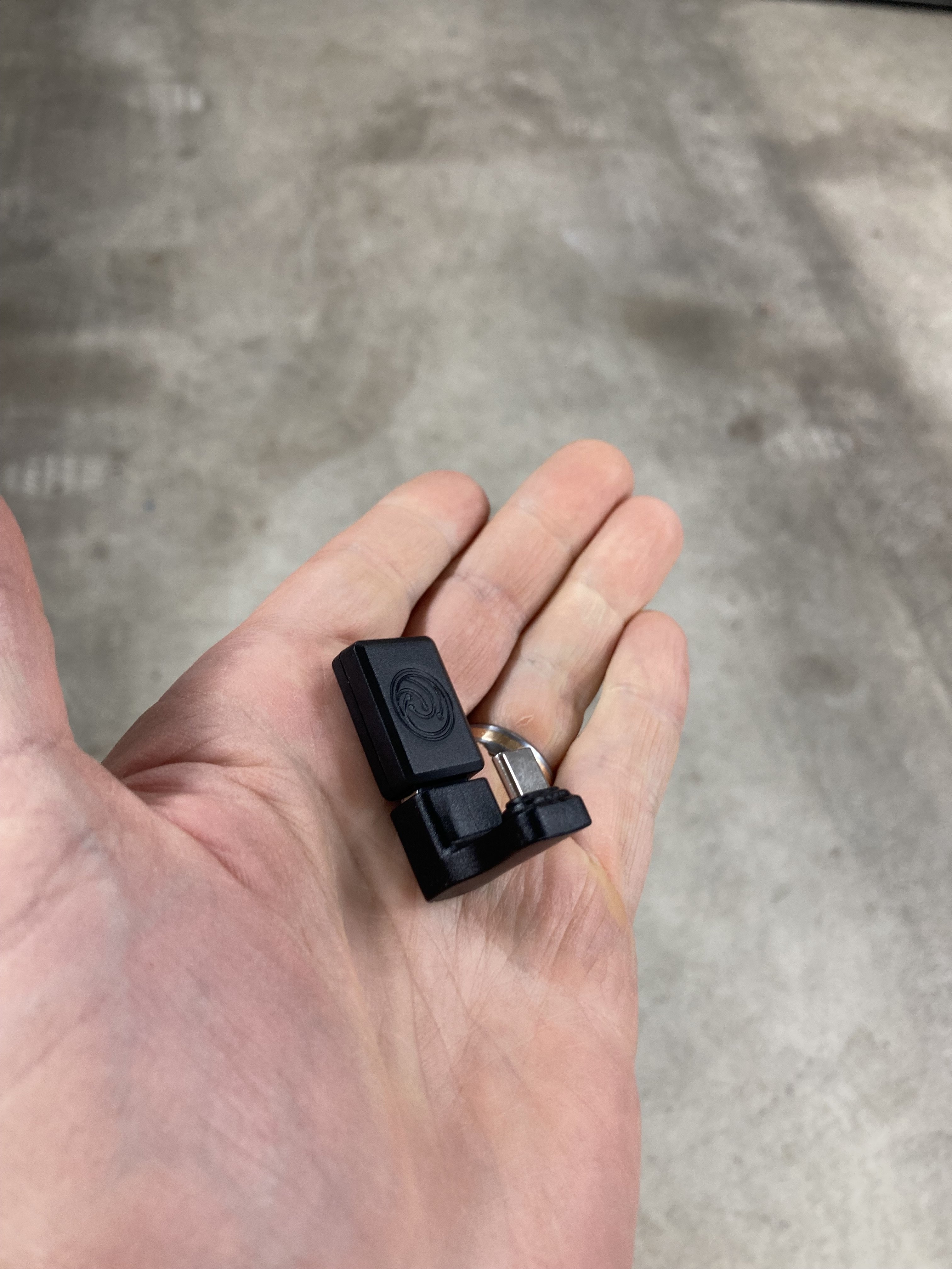

Hey guys,
I have a new Specialized S-Works Levo and I went to install the Levociraptor but the BLEvo app won't pick it up.
I did all the usual stuff with Bluetooth, resetting it and such. It won't scan the bike or ID the unit.
Also, I noticed the instructions are saying that the unit was suppose to have a 6 digit code with it. The only thing in the envelope was just the unit. No numbers on the unit either.
Any help would be greatly appreciated.

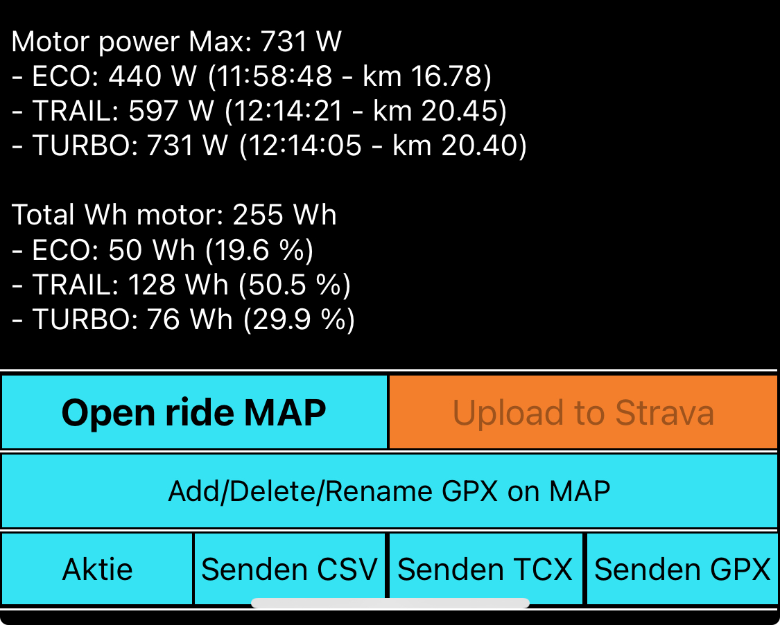

I'm pretty sure that is power delivered to the motor from the battery. Motor power delivered to the crank sprocket will be less than that. I don't know how efficiently the Brose motor converts electrical energy to mechanical torque. A quick search for "typical dc motor efficiency" suggests that the number is in the 85%-90% range for brushless dc motors.
731 * 0.90 = 658

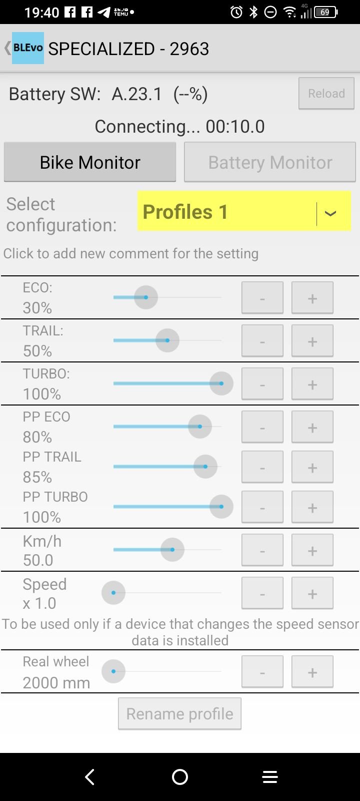

Hi im new to this just got a specialised fsr turbo 2018 model will blevo allow me to move the limiter it's like hitting a brick wall when i get to the limit at the moment
Sparkydave
Aug 7, 2018
80
160
Derbyshire, UK
Yes it will, just search for the bike and pair - look for the speed limit in the bike monitor section and alter it to what you want. Had it since new on my 2019 Kenevo

That's amazing thank you. So do you need to set wheel size to
I think mine might be set to 2300, but I've no idea from memory what that is based on - that's only going to make small differences to how fast the bike (or app) 'thinks' you are going due to a bigger wheel taking less rotations to cover a greater distance. I'm not bothered about it being accurate, just as long as I don't have an actual reachable speed restriction
Yes i don't have a display on mine so accuracy is no issue for me either i will just use the blevo app to record my ride. Thank you so much for the help.
Hi was messing with it earlier and it wouldn't save but can only presume that is because i have the wheel size set to 2040mm . So will set the 2300 and try again.
