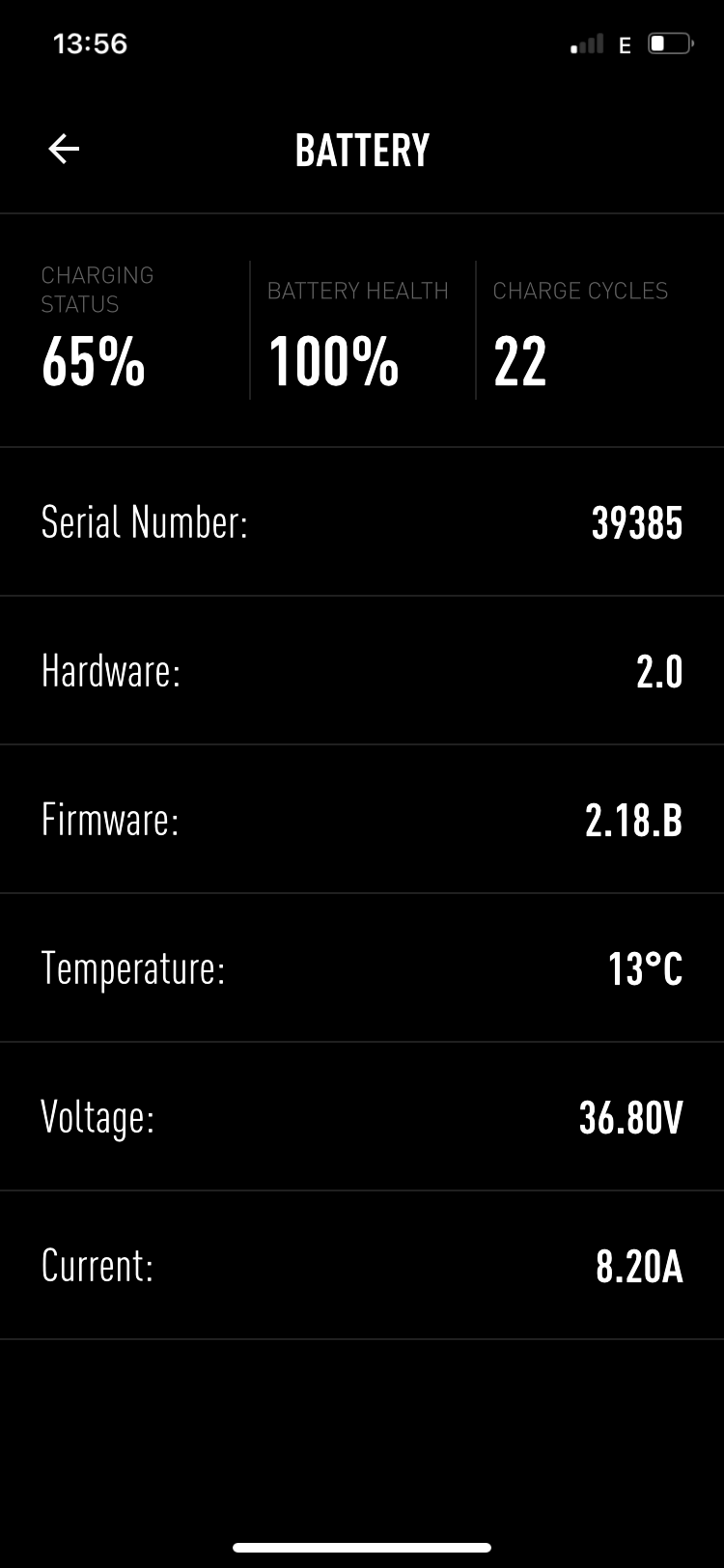

Can you check how many amps your motor's pulling (Run mission control, select battery, pedal hard in Turbo).
Also check all your assistance settings in Mission Control. At the top of that page there is also an option "presets". You could try that and then re-start the bike to set everything back to standard settings.
Could even be something like some cells down in the battery so it's not giving full voltage. Do you know the battery health ?

Cheers for the response zimmerframe. Battery health is 100, it’s been low on power since I got it but I thought it was just me. Having compared it with my partners it’s night and day different. All parameters are set the same.

Can you swap the batteries and see if that makes a difference. It then rules that out as the issue.
Maybe worth also disconnecting and checking the power cable from the motor.

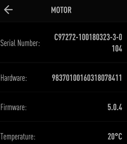

Have you checked the serial number in Mission Control ?
Should start C972, 1.2's will be C911.

Cheers for the response.
I jumped on both mine and my partners and mine kicks out about 10a max compared to 20a with my partners.
I will check the motor firmware also.
