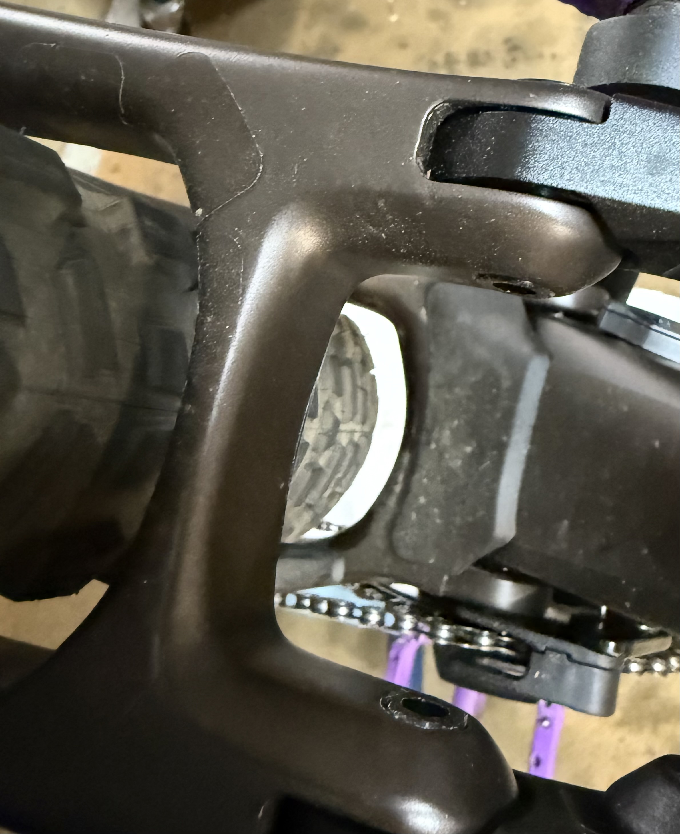

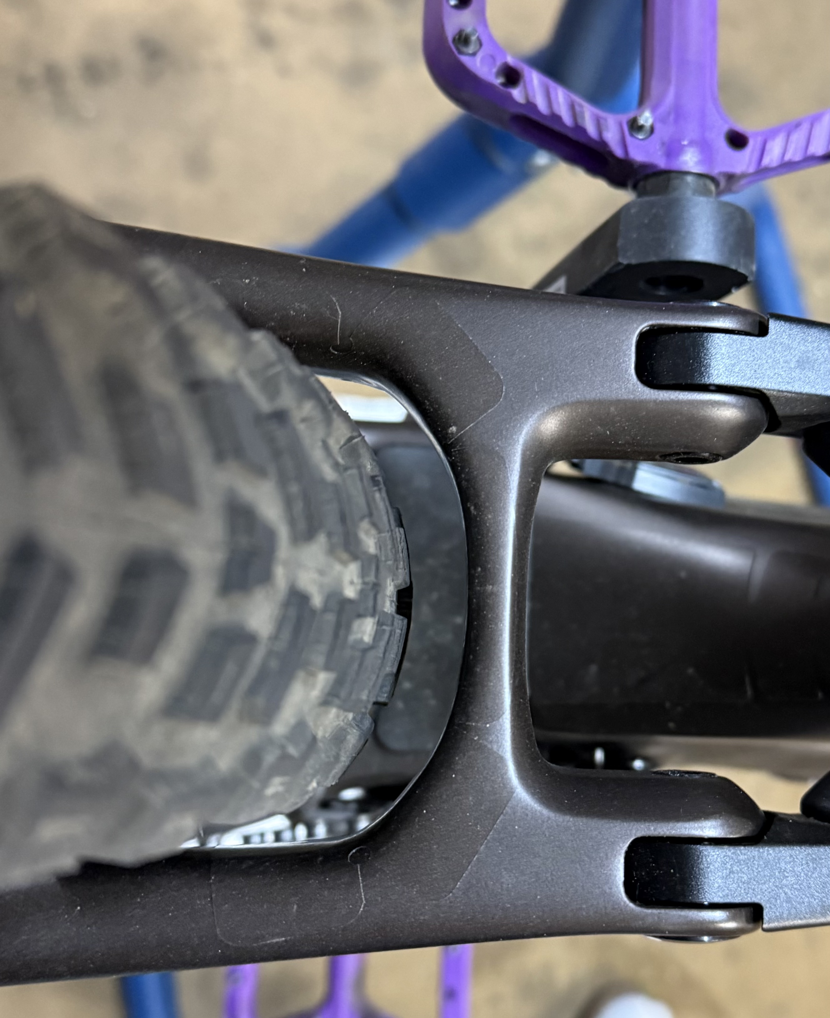

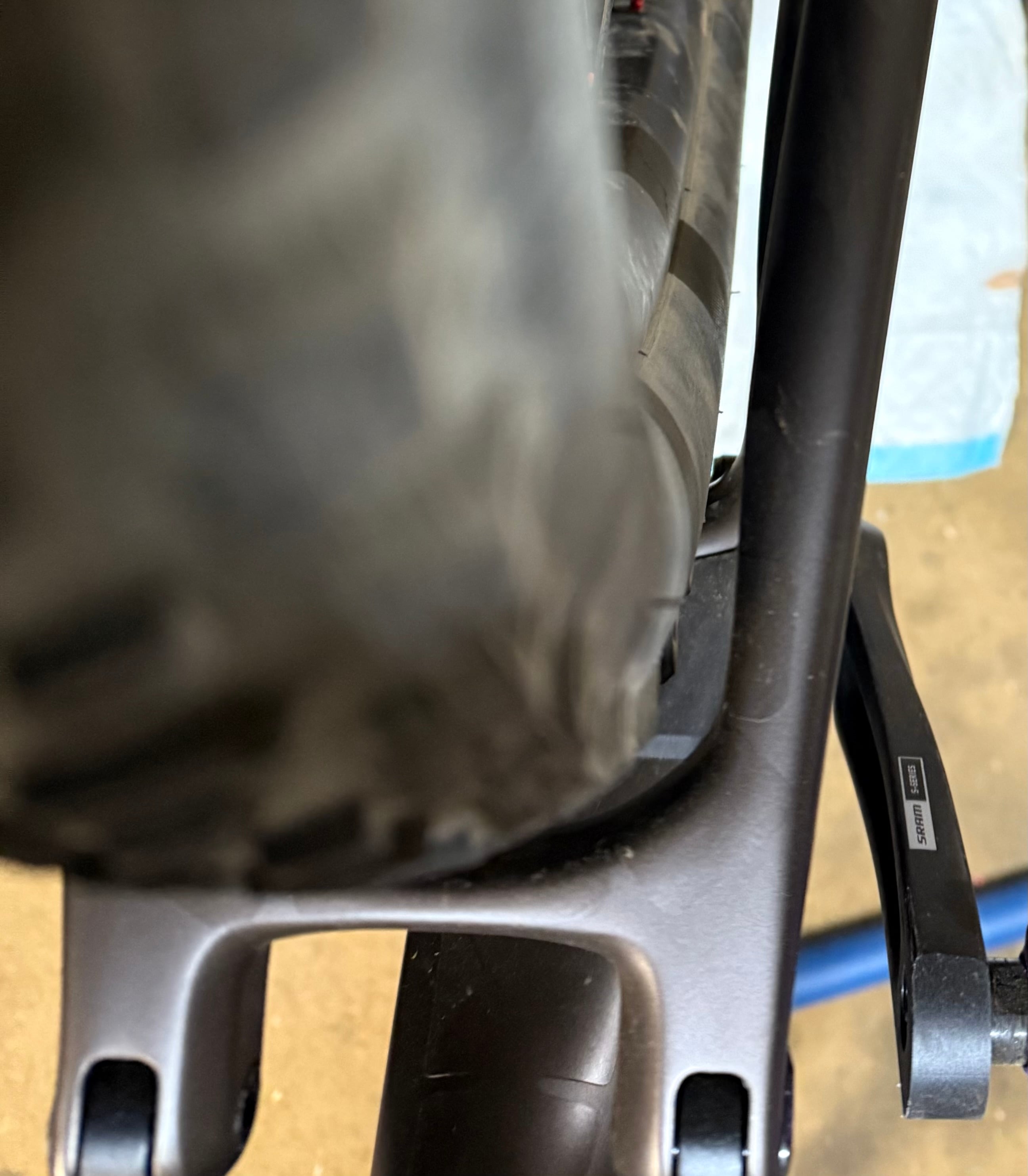

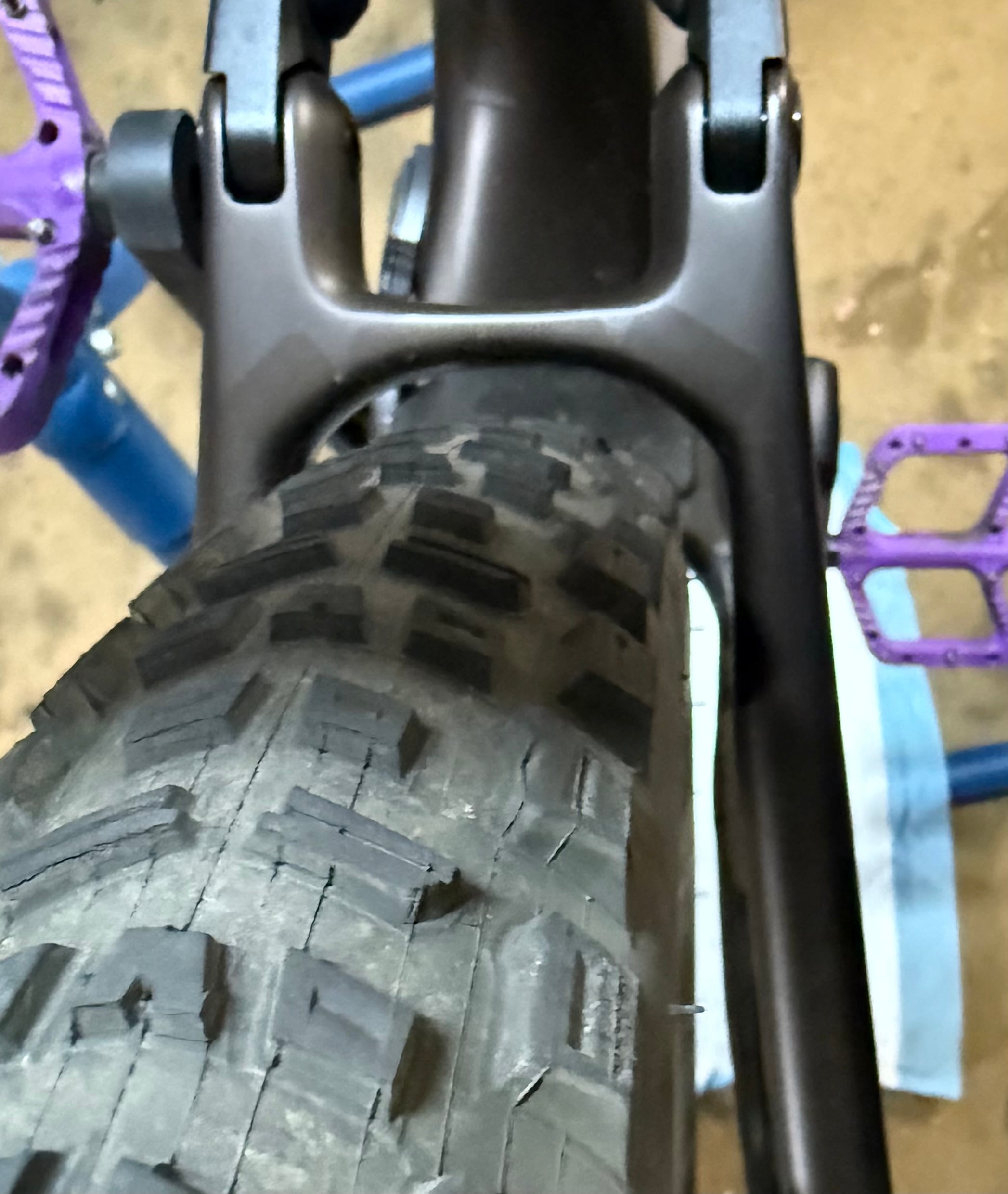

Here’s a Purgatory 29x2.6 that measures 2.66” wide on an i30 rim.
Levo SL Comp with the Horst link flip chip in the long wheelbase setting. There’s about 6mm clearance to the seat and chain stays and 8+mm clearance to the seat stay bridge and bottom bracket.
Probably too close for muddy conditions, but it should be fine for our dry southwest US. IMG_0482.jpeg

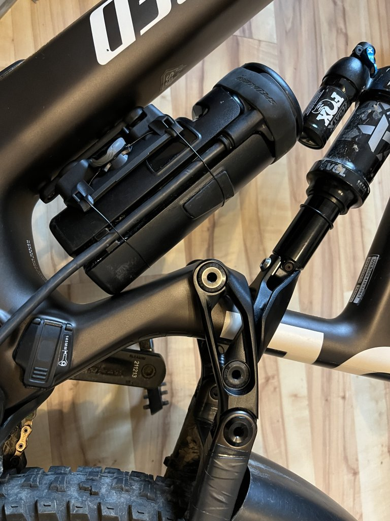

Bottle cage is so low, it's a little bit uncomfortable to get the bottle in and out of it. Can I use Fidlock magnetic bottle instead? There is not so much space around a bottle. My guess they did it because they want to put range extender as low as possible.

Maybe with a combination with this mount it will fit (the mount itself is thinner), but somehow you need to connect the mount to the battery, the included strap will be way too small.

Where did you get that battery extension holder? Mine is just a typical water bottle cage.
It’s a Fid lock mounted cage. You can get the bottles and this version from most shops. Though I would say the extra thickness of that mount has the battery way to close to the piggyback of the shock.
