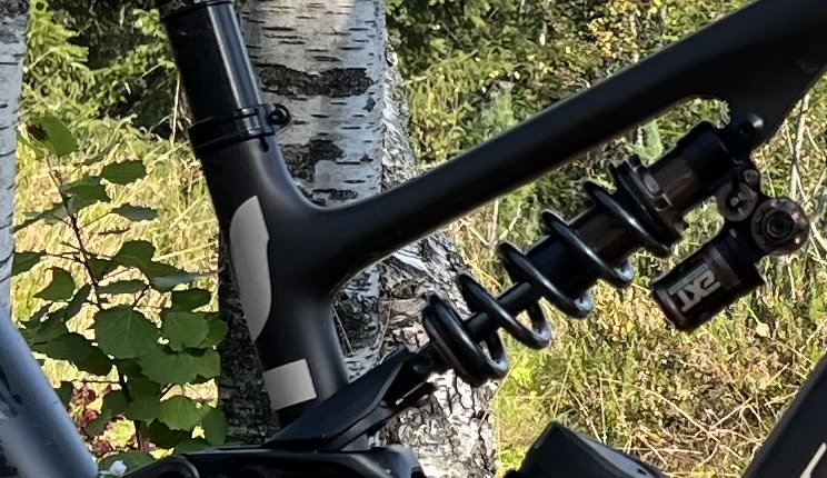

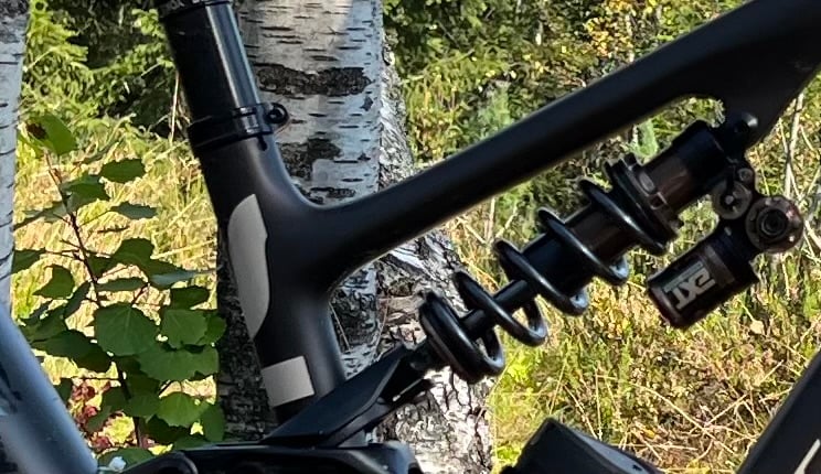

2025 Levo SL will get a piggyback genie shock!
I couldn’t wait so I inserted an EXT 😉

The ext Storia has a hydraulic bottom out, in fact the best in the business. They developed it thirty years ago in automotive. It is the superior shock on the market. Only thing with potential to be better is Vorsprungs new shock. If someone still thought they needed even more progression they could buy a progressive spring instead of a linear one. I’ve never seen a person who needed a progressive spring on a Storia.

I can corroborate. I have the Storia on my SL and the Vorsprung Telum on my analogue. They’re the best shocks I’ve ridden, and unfortunately I’ve tried a lot. They go about their duties in different ways, but both are phenomenal. They cost more, but not having to buy and guess spring rates makes up for a lot.

I had an ext E-Storia on a turbo levo- simply sublime. Tried the tigon which was also a great shock but not as good.
