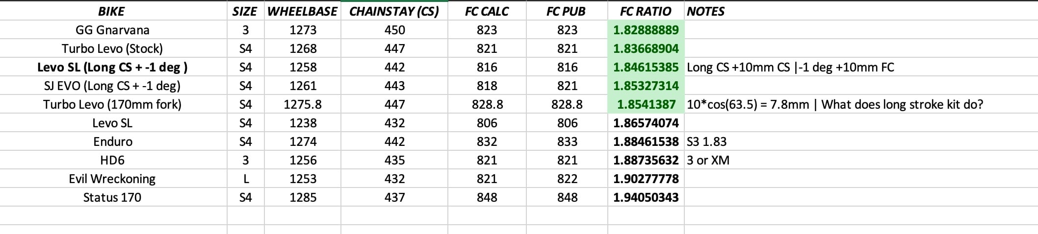

Forgot to mention, I was reflecting on all the bikes I’ve enjoyed over the decades of riding, and they all have one thing in common: a more even front center ratio. I threw this into excel. you can see the “good ones” in green below.
