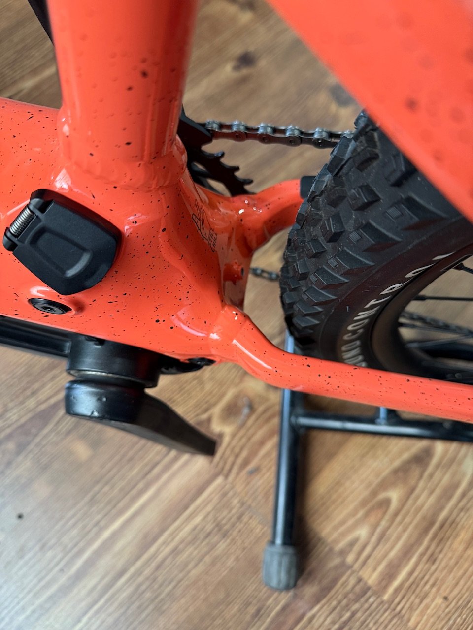

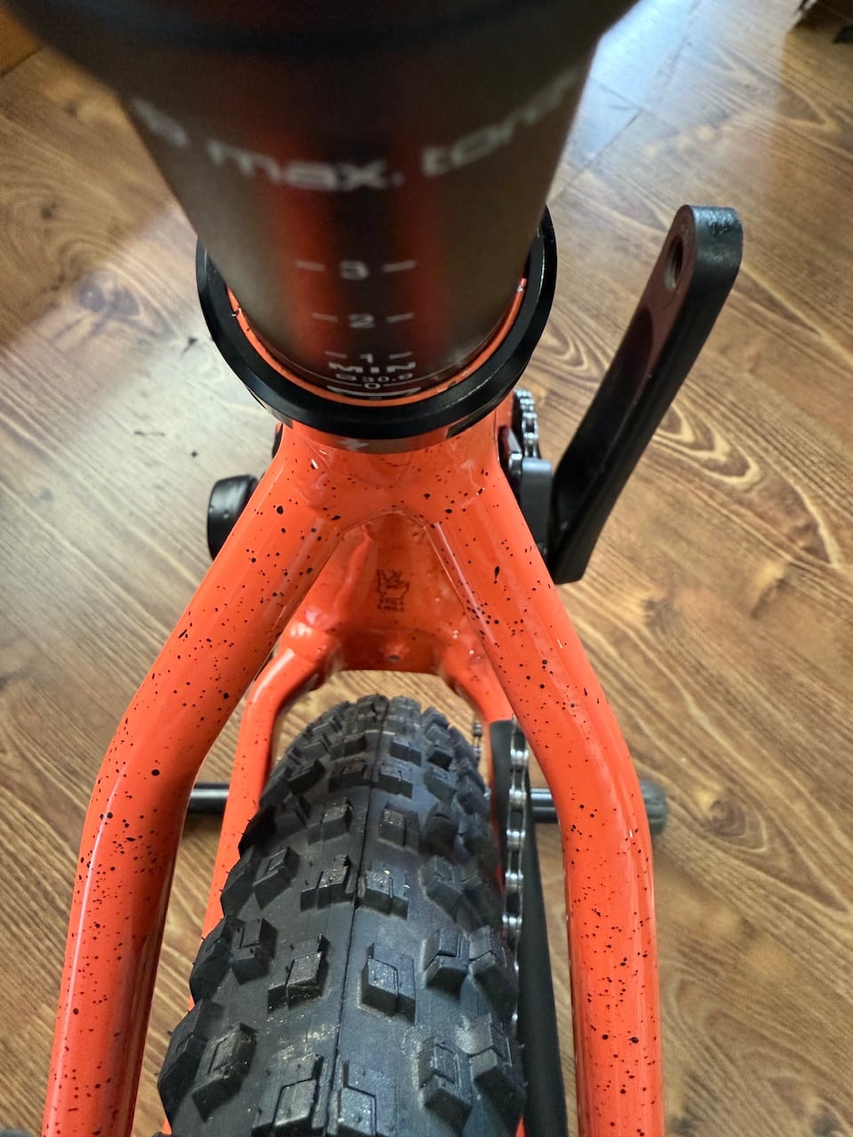

My mrs is though. I’m wondering if a 26” wheel will fit in the back.
24’’ clearance
