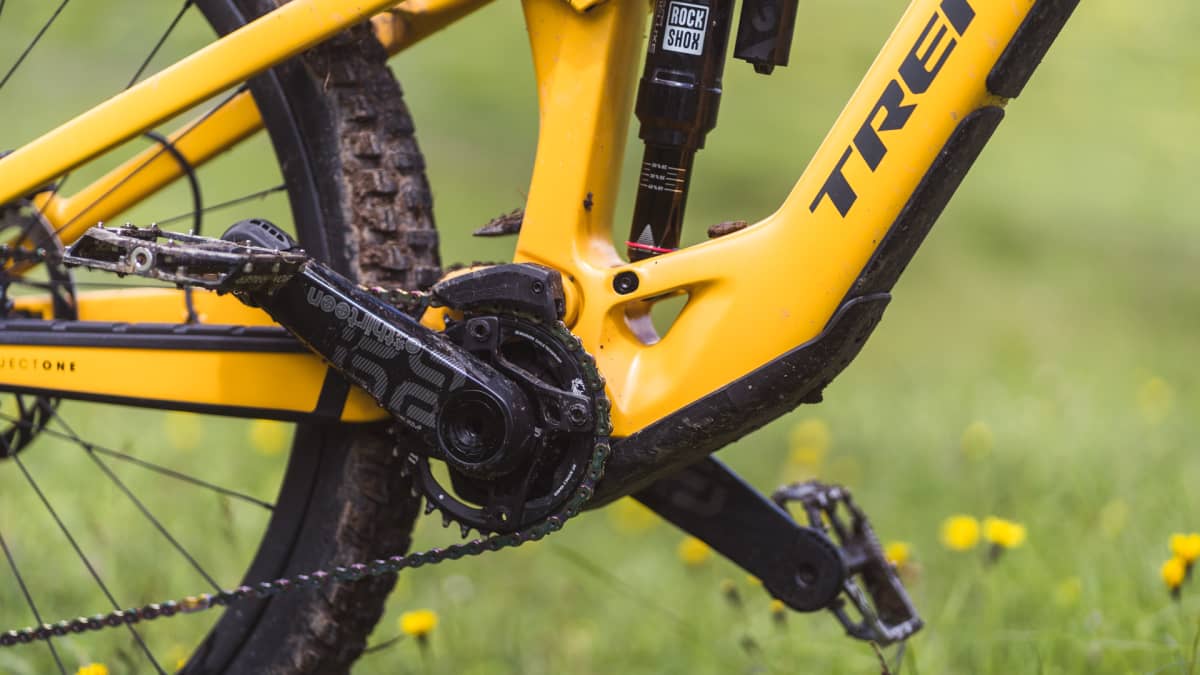

I assume the weight is pretty much the same since Trek was on stock spec but Spec was on DH tires, tire insert + extender. I would assume Trek would do 200-300m climbs more.
In terms of decents, Trek is more poppy and very easy to jump. Maybe it is a characteristic of Float X shock vs .X2 which I have in my Spec. Generally I think Kenevo is more composed and planted but I would need to ride Slash+ a bit longer, taking the lift and change the wheels since stock tires are from paper and with less aggressive tread than Conti Kryptotal.
Overal, I like the Spec package more, especially with a new 1.2 motor.

Very interesting comparison, esp. the heating up even though it's just barely above 15C in forests right now in central Europe. But it does square up with some reports of the engine doing that, delivering less actual output over the whole ride than it does in initial climbs (i.e the reviewers always mentioned it being stronger when doing back-to-back tests, but then eventually finding you have to work for it after bigger ride).

i rather have a motor that is not affected by heat

Has anyone else had issues with their Kenevo SL over heating?
the tq is easily derating*, not the mahle. read properly
Es ist die Paradedisziplin klassischer E-MTB-Motoren: Turbo-Modus einlegen und in Rekordtempo auf den Berg schnurren. Inwieweit ein Light-Motor in dieser Disziplin brillieren muss, liegt ganz klar am Einsatzbereich und den Vorstellungen des Fahrers. Im Falle des HPR 50 gehört ein Dauerbetrieb im Vollgas-Modus nicht zum idealen Einsatzbereich. Bei unseren standardisierten Messfahrten an einem steilen Asphaltanstieg über 410 Höhenmeter hatte der kompakte Motor mit deutlichem Derating, also einer Drosselung der Leistung, zu kämpfen. Nach rund 15 Minuten ließ die Leistung spürbar nach. Am Ende des steilen 400-Höhenmeter-Anstieges (12,2 % im Schnitt) zeigte das Display im Fuel EXe nur noch maximal 155 bis 170 Watt an. Zu Beginn waren es 300 Watt. Die Außentemperatur lag zum Zeitpunkt des Tests bei 25 Grad.
Die anderen Antriebe konnten ihre Maximalleistung über die gesamte Distanz weitestgehend konstant halten. Selbst eine etwas gedrosselte Leistung von 240 Watt konnte der HPR 50 nicht über den gesamten Anstieg halten. Den Hauptgrund für das verhältnismäßig frühe Abregeln des TQ sehen wir in der geringen Fläche, die ihm zum Ableiten der Wärme zur Verfügung steht. Das Gehäuse des Motors erreichte an den außenliegenden Flächen eine Temperatur von knapp 70 Grad. Wer eher im mittleren Modus unterwegs ist und die Turbo-Stufe nur kurz zuschaltet, wird von diesem Manko nichts mitbekommen. Ein hohes Fahrergewicht, lange, steile Anstiege und Hitze verschärfen das Problem.
Im High-Modus erreichten wir mit dem HPR 50 rund 1050 Höhenmeter, bis der Antrieb auf den letzten Prozent des Akkus seine Power drosselte. So erkletterten wir nochmal gut 200 Höhenmeter. Die Fahrerdaten dazu: Fahrergewicht 89 Kilo, 150 Watt Tretleistung, Kadenz 80 U/min.
