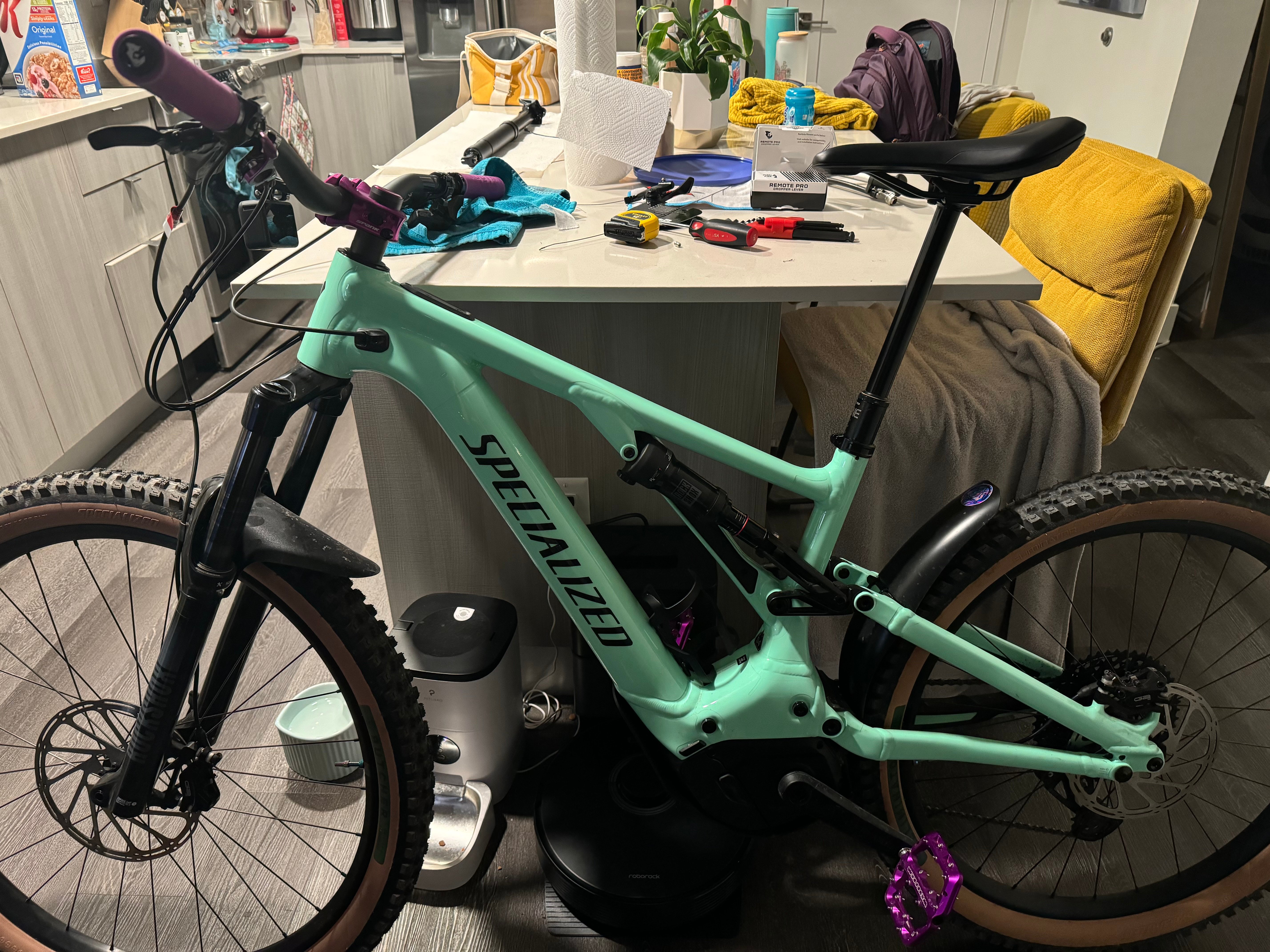

I have an S4 with a Oneup 210 without issue. I'm 6', but have longer than average legs. I have around 40-45mm exposed. I can measure later for the exact number.
For anyone else that attempts to install a OneUp 210 dropper I was able to get it installed and the lowest I can get it is approximately 45mm too.
Originally the dropper was exposed 60mm from the collar but that was because the dropper actuator is offset to the side. In playing with the fitment of the dropper I realized that if it were installed backwards it could drop much better because internal to the frame the cabling is also offset.
I followed the Oneup maintenance video and removed the screw on adjuster at the base of the collar and removed the actuator at the bottom with a wrench and re indexed the shaft backwards. Put it all back together and the dropper fits great. At 45mm collar, that was the lowest I could get it to go, at full extension it puts the collar to rails distance exactly at 11 inches which is exactly where my old dropper was raised to. I am happy this dropper post worked out the way it did.
