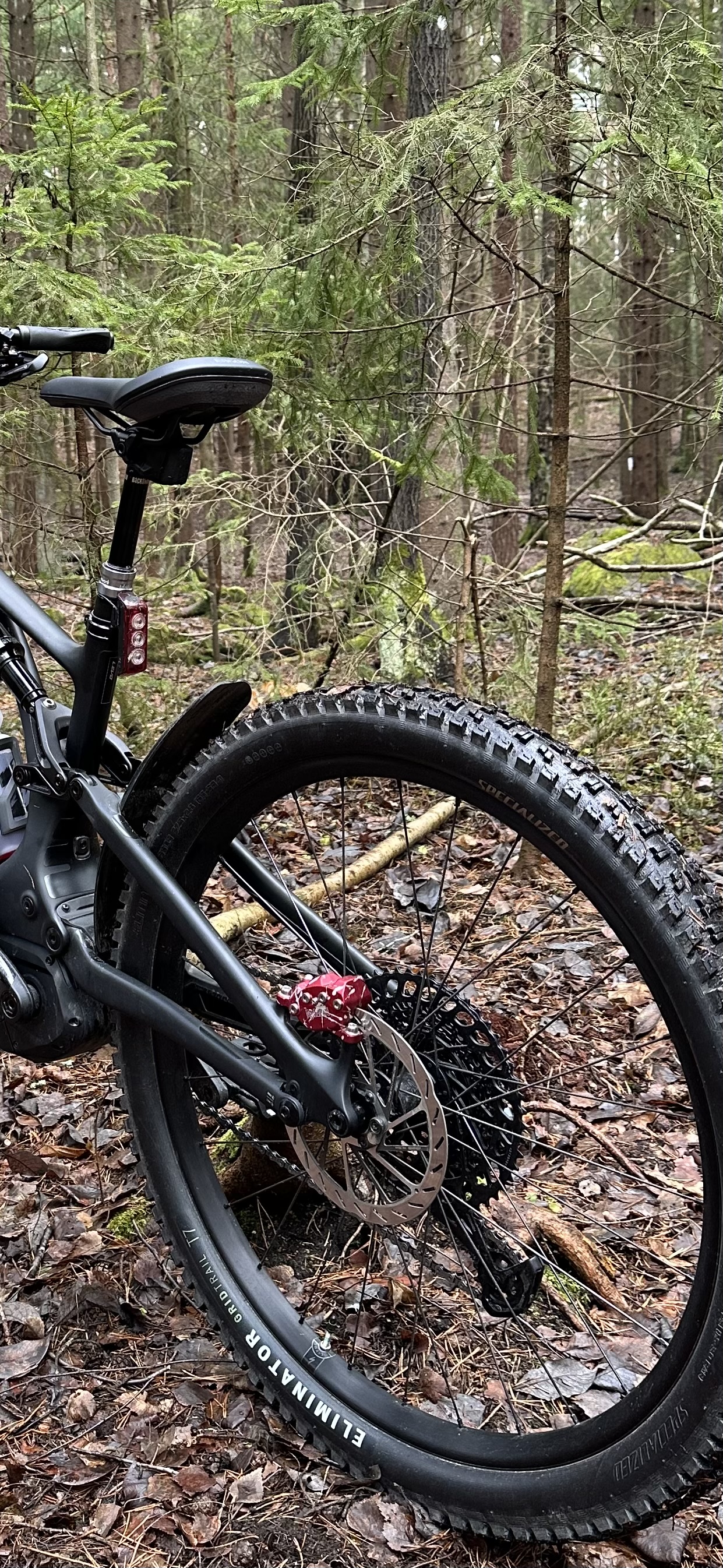

I bought two Maven kits: one for the e-bike and one for the eatbike. The brakes have a slightly inconsistent bite point (a known issue that can be fixed), but otherwise, they're awesome! I tried the 200mm front and 180mm rear combo on the eatbike, but I didn't like it—the 180mm felt a bit too weak. I swapped it for a 200mm rotor, and now it's perfect. The eatbike is a full 29er, while the e-bike is a mullet, so I might use the 180mm rotor in the rear on it.
