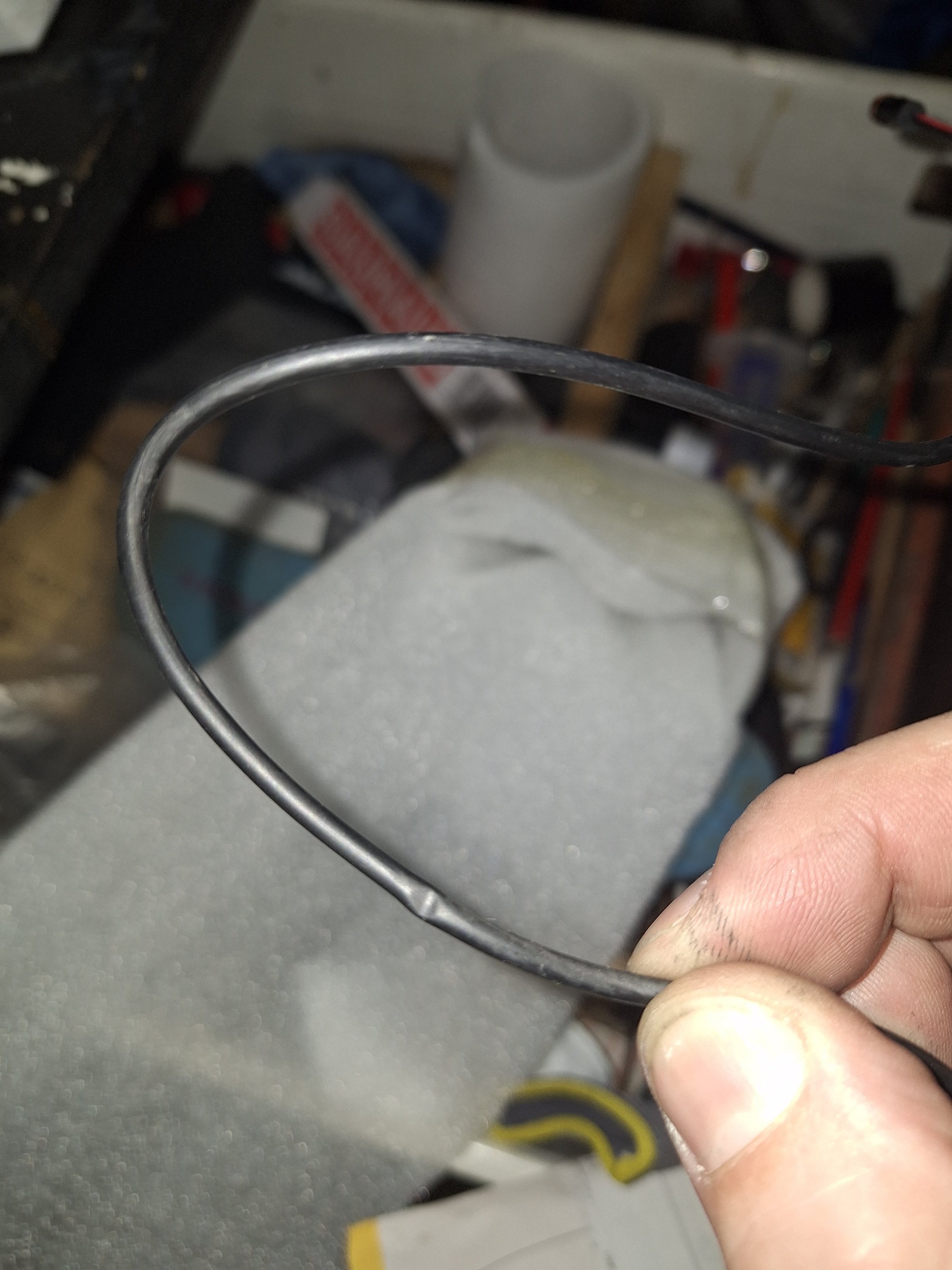

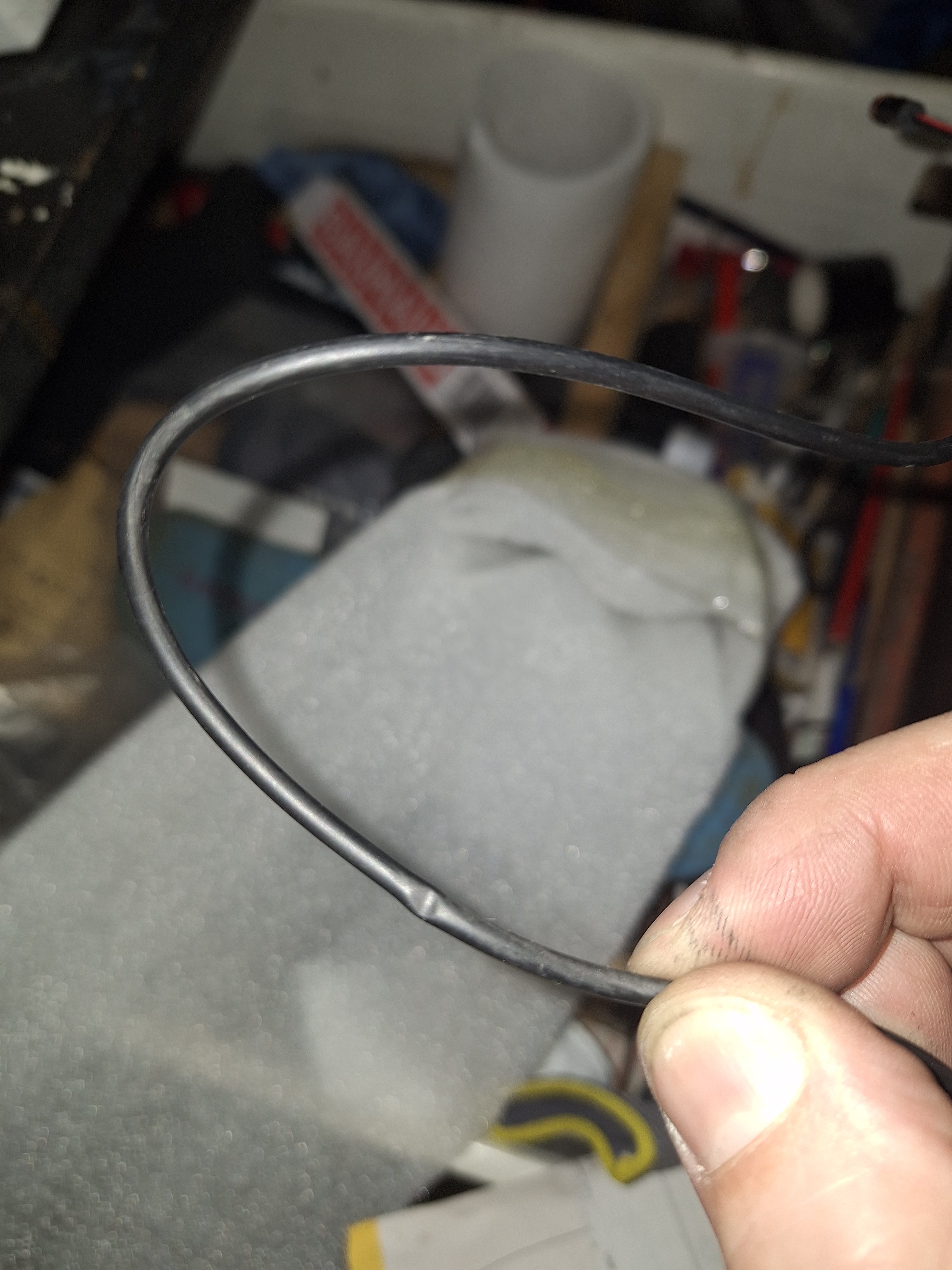

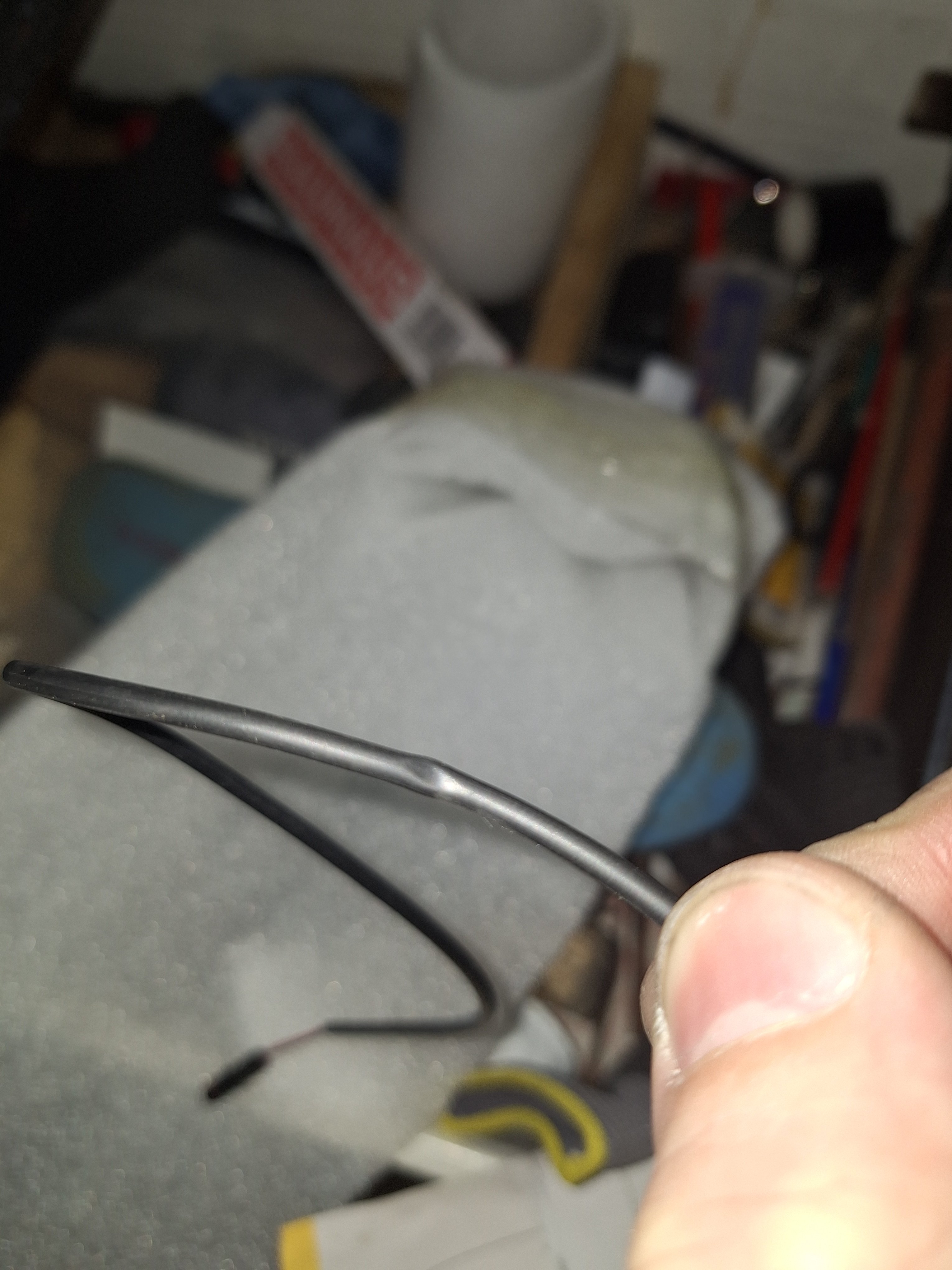

I had same problems and had the speed sensor changed, but I still didn’t have time to test properly yet.
Other symptoms I had was difficulty to reach the 25kh/h limit unless trail tipping downhill, and motor cutting the power when rear wheel looses traction and spins the middle of a difficult climb, this was the most annoying…
I replaced the speed sensor today. the cable was pinched between the brake lines and the frame.

replacing the sensor helped. I've been on 4 rides, no more problems.

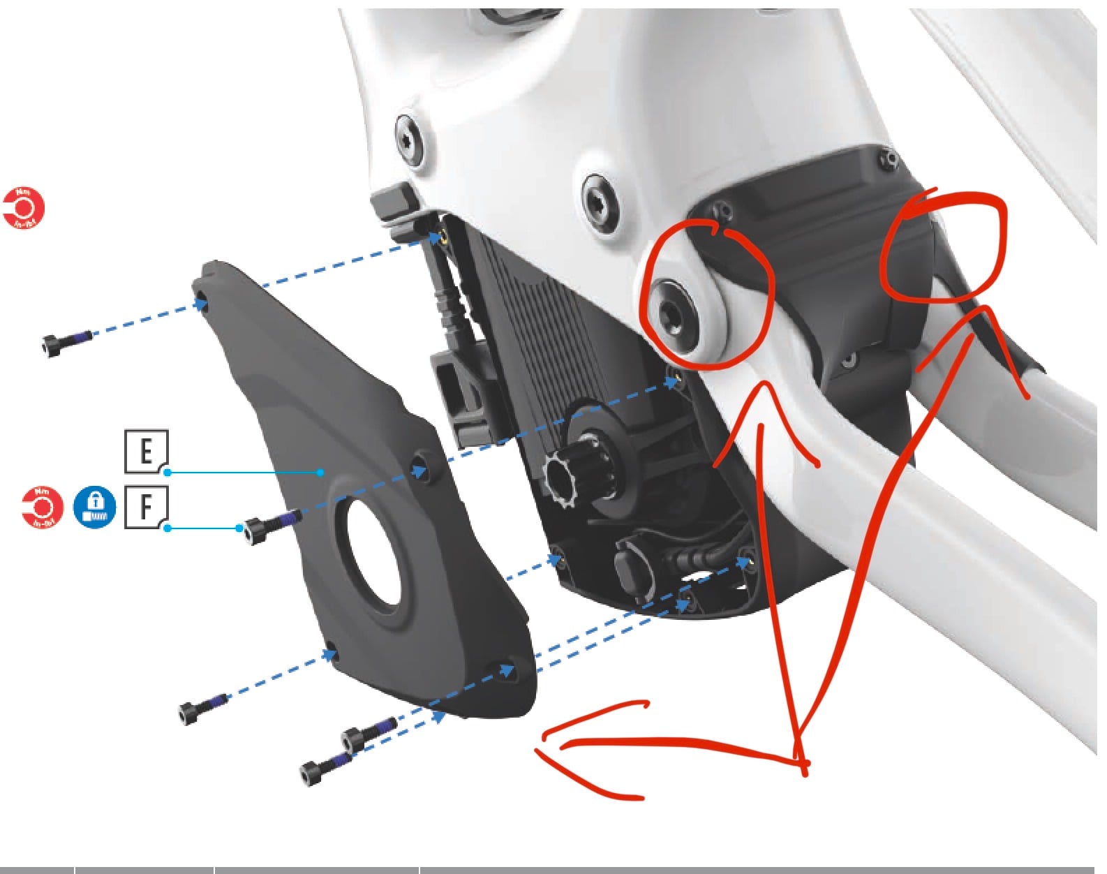

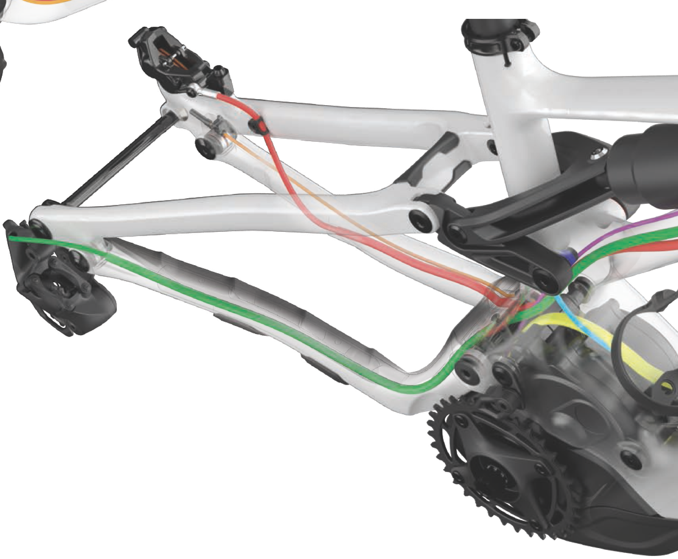

HI,
I also have the same problem with my new Turbo Levo Comp 2023 , purchased 5 months ago.
I wanted to know, did you solve the problem by replacing the sensor yourself, or was the work done under warranty, at a Specialized assistance center?
From what you wrote in your post, after the replacement, it seems that you no longer had any problems.
Correct ?
And ..Were you able to understand where the cable was crushed?
I saw in the workshop manual that the cables (rear brake, derailleur and speed sensor), behind the engine, are fixed to a cable clip.
Could this be the speed sensor problem?
It is the only cable, thin, soft, and without protection.
Thanks

greeting. since I changed the sensor, there are no more problems. I bought the sensor myself. since 2 authorized service centers failed to fix the defect. I don't know if he would write Specialized Eastern Europe, where I report to them that I fixed the problem myself. however, they didn't fix my bike in 2 authorized service centers! I marked in the picture the area where the cable was pinched.

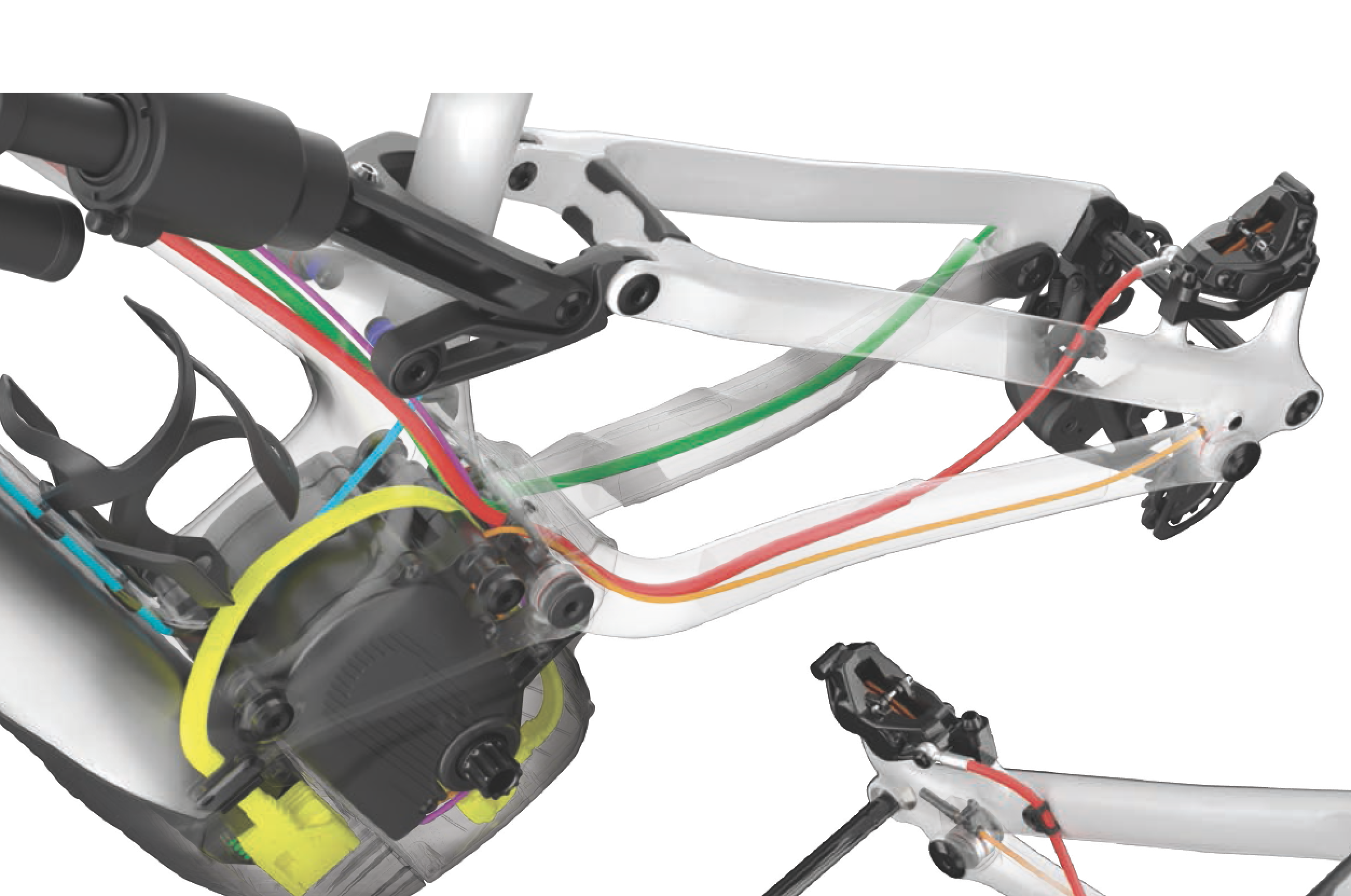

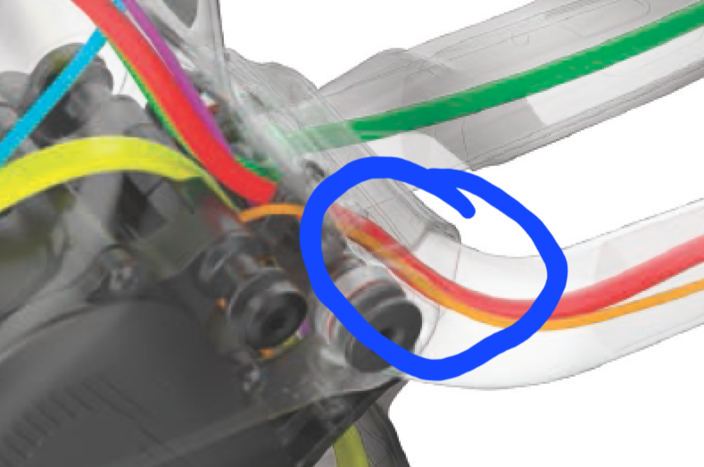

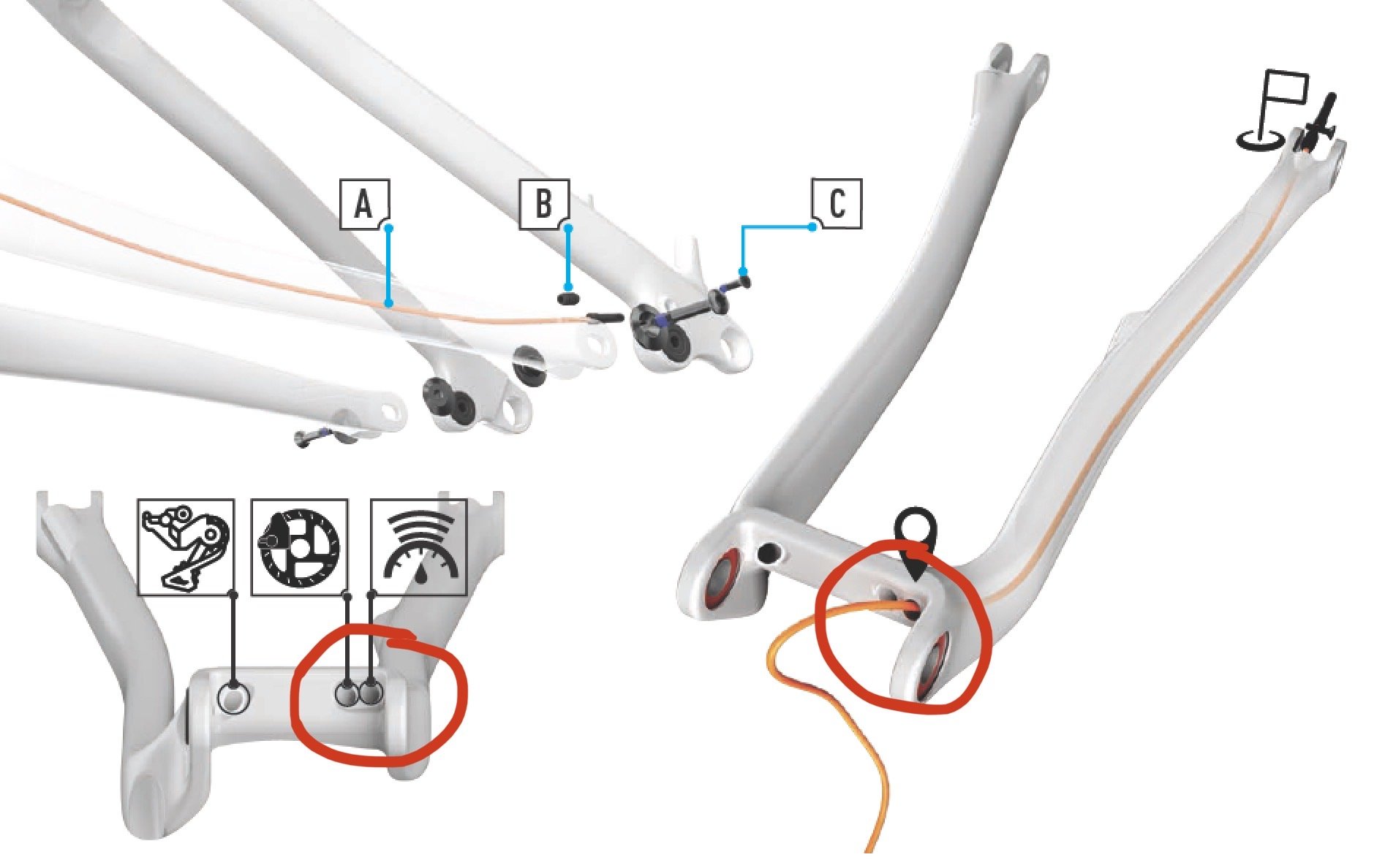

Hi ficorama,
Thank you for your answer .
One last question... to pass the new cable, did you have to remove the engine cover (electrical connector side) and also the chainstay from the frame?
Or, you used a probe, connected to the old cable, to pass the new one (without having to remove the chainstay from the frame).
Because, it seems to me, that the cable flows well, in the hole and inside the horizontal stay.
Among other things, I noticed that on my bike, the sensor cable, instead of passing through the external hole, passes through the innermost one.
They reversed the routing of the cables, compared to the workshop manual.
external hole = rear brake cable
internal hole = speed sensor
And the brake cable ,crosses over ,the speed sensor cable.
It could be that it is the brake cable, which is pinching the sensor cable at that point.
