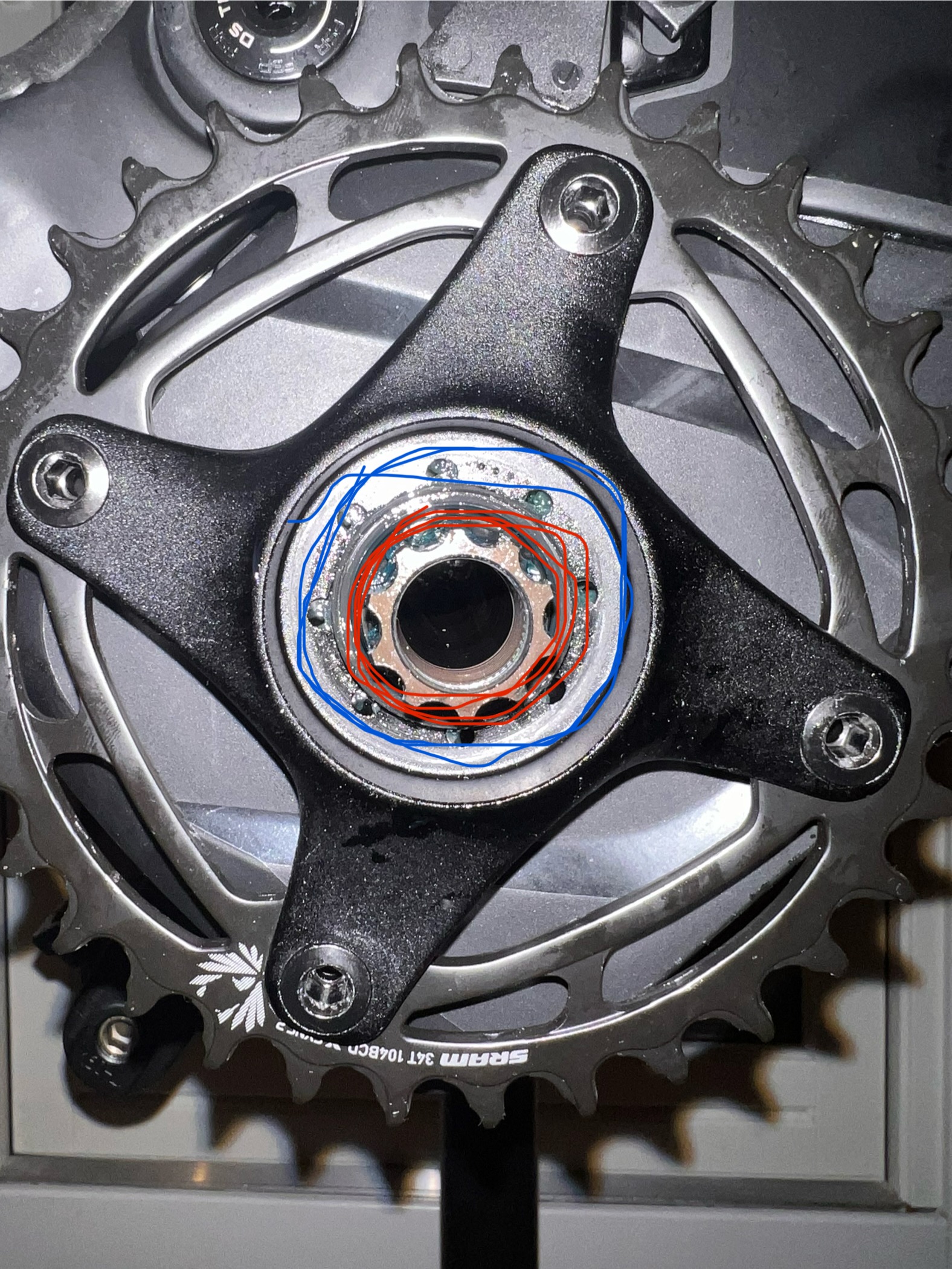

Hi!
Need to remove the spider on my comp carbon, does anybody know for sure if the Park tool BBT-18 will fit the gen 3 lockring / inside the spider? Thanks

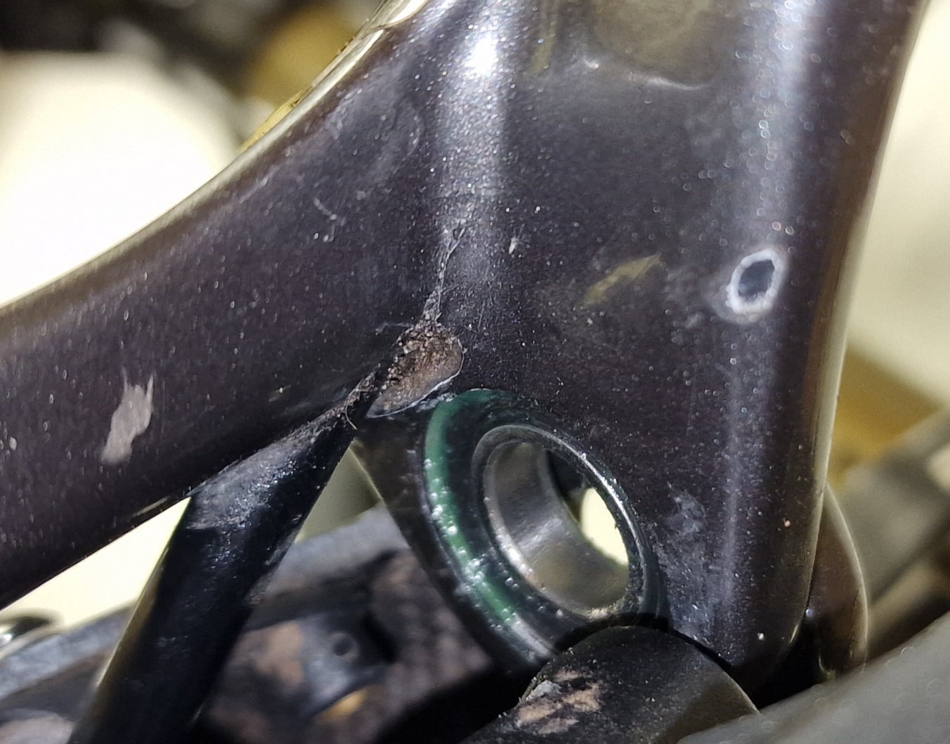

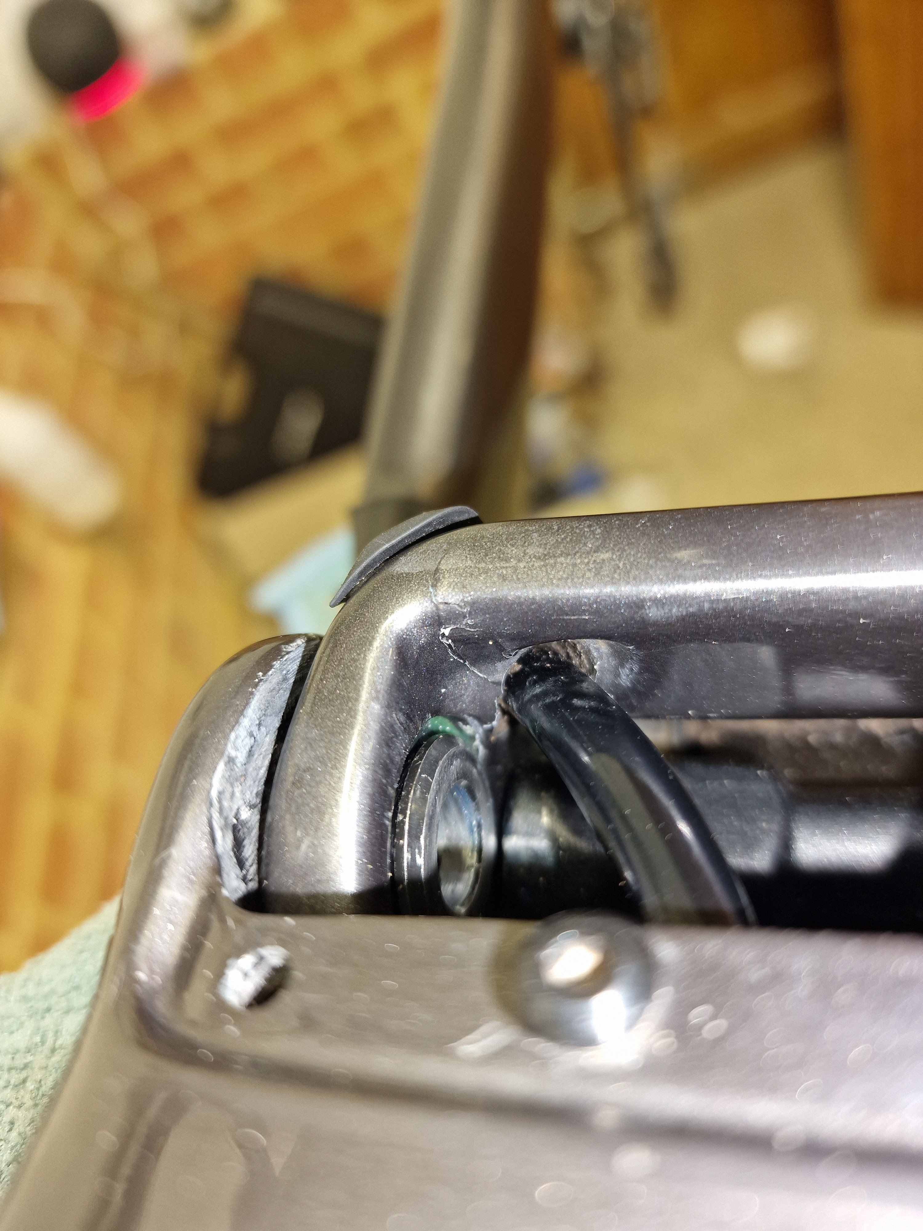

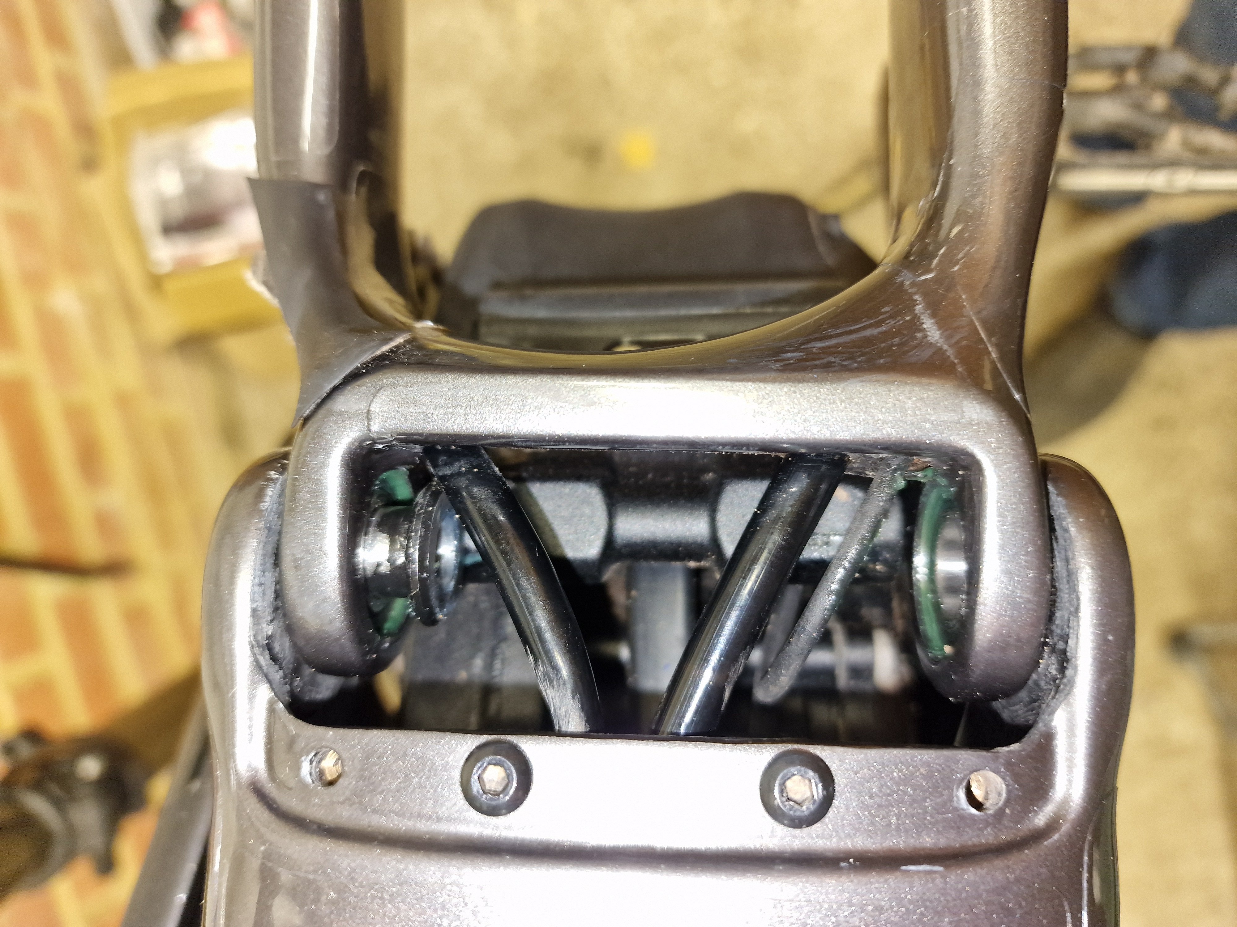

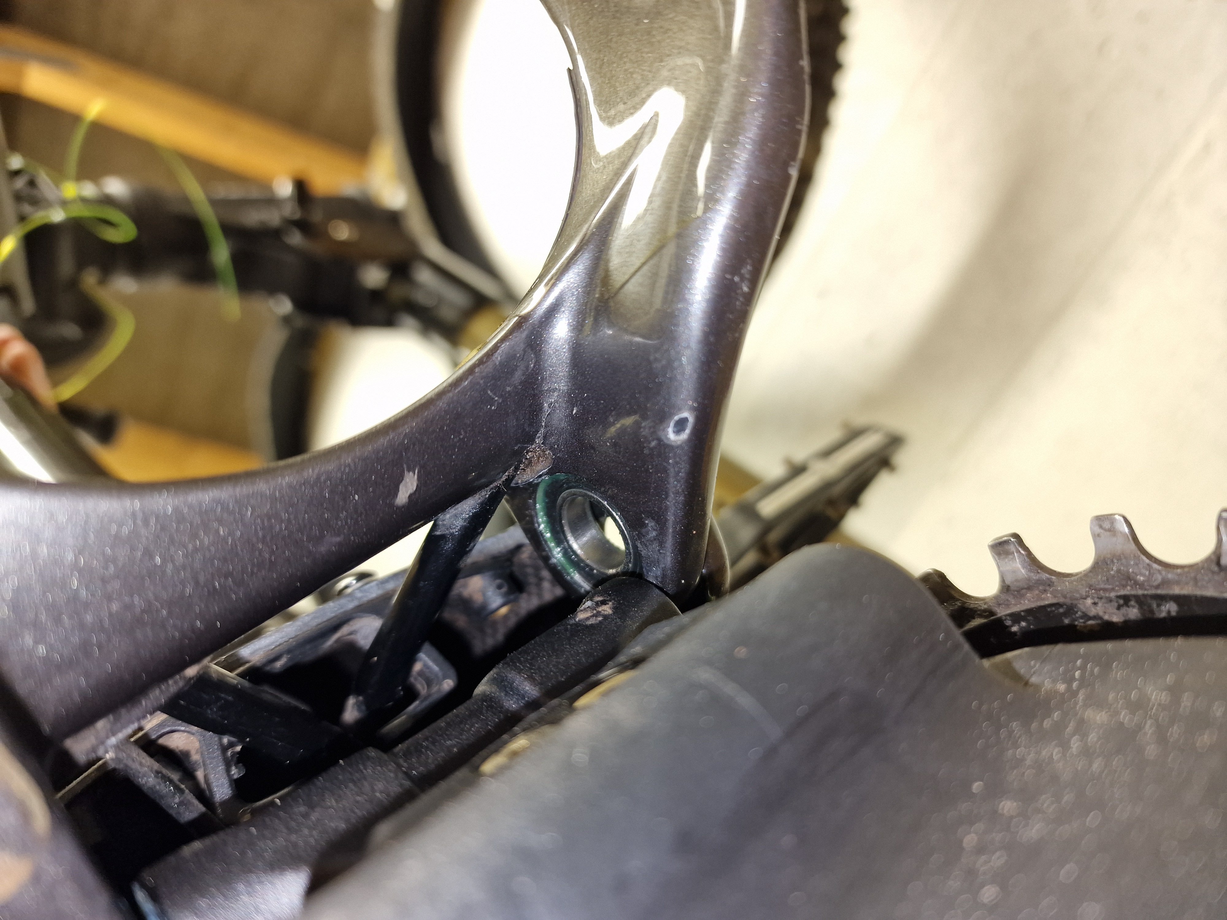

I never resolved it no. It annoyed me so much I barely ride the Levo now since about 6 months when I got an Enduro. Fact, I've kinda gone off e bikes since owning the Enduro.
I'm currently replacing all bearings on the levo as i write this. The cascade linkage has slipped a bearing and the big bearings near the motor and the 4 bearings at the end of the seat and chain stays were toast. Haven't ridden yet so no idea if it fixes it.
I spent a lot of time inspecting the chain stay and couldn't see a crack although I may have another look since Veli-Matti mentioned the crack before the bike goes back together.
My chain stay arms do flex slightly if you push them together but can't work out if that's normal. I didn't press too hard as I didn't want to crack them. But they definitely weren't solid.
Once I've managed to ride it I'll come back and update.
Edit..... yeah its looking pretty cracked. FWIW it flexes only on the right hand/derailleur side. The other side is pretty solid.
View attachment 131762 View attachment 131764 View attachment 131765 View attachment 131766
Thats quite bad pal surely that’s under warranty ? Was it making any creaking noises ?
My Levo was In for a new drive chain but forgot to ask them to take a look to see if they can see anything 🙈 I’ll get it on the stand tomorrow to see if I can see anything.
Hope so, I got the occasional cracking noise but not very often, assumed it was the derailleur.

Hi guys!
Need to remove The spider off my gen 3, I have removed the lock ring, to protect the axle when using the puller I originally bought a 32mm socket, but I'm pretty sure that is just resting on a part of the spider so it won’t move when tightened 🤷🏻‍♂️ Is where I’ve marked red in the image below where the socket need to rest when using the puller? (The blue is where the 32mm socket would sit for reference)
Thanks

Hi guys!
Thanks
Hope this can help you:
  • 2022 LEVO - SCHEMATICS - SMALL PARTS_10_01_2024 07_04_11_1619.pdf
