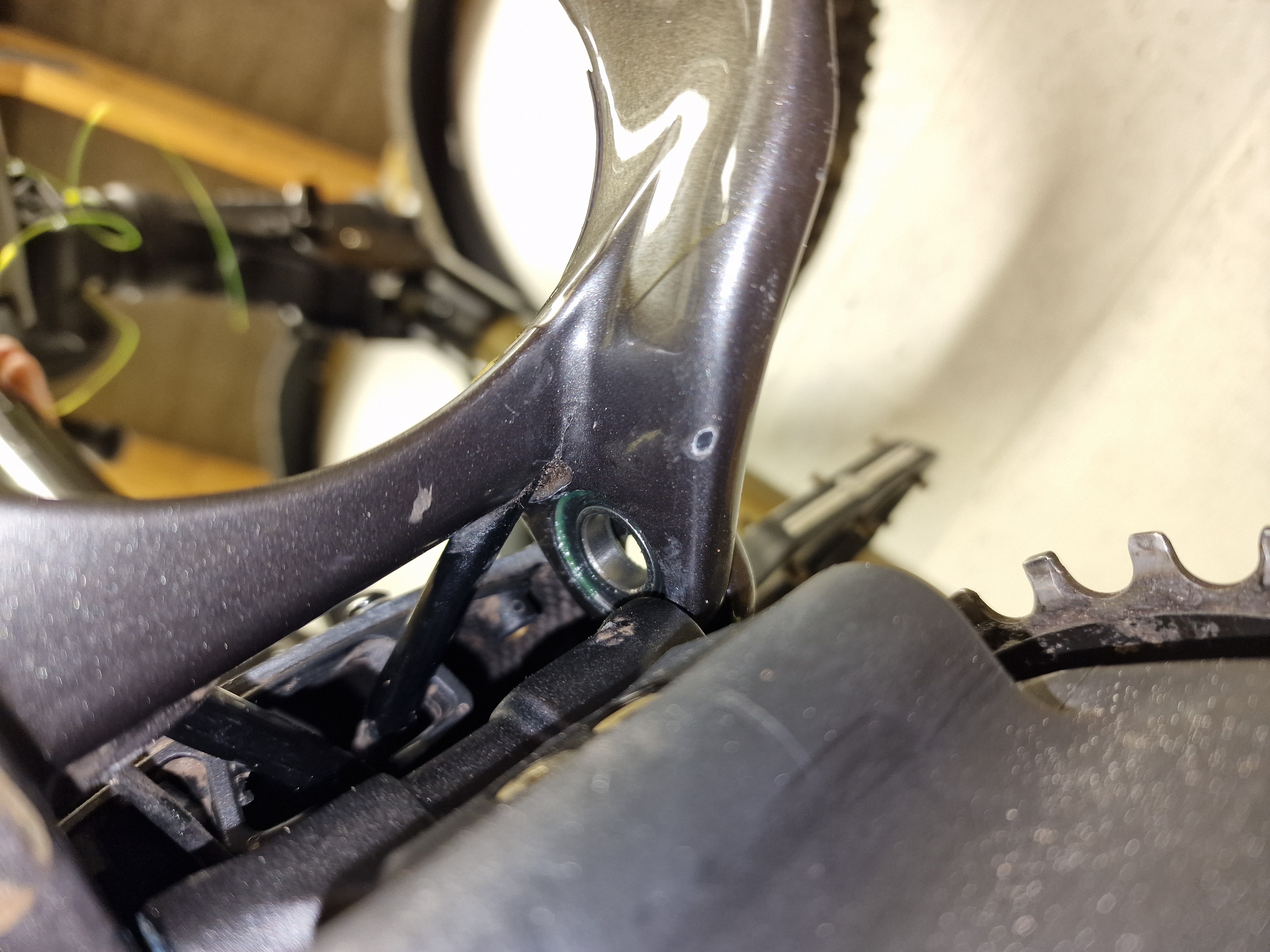

I never resolved it no. It annoyed me so much I barely ride the Levo now since about 6 months when I got an Enduro. Fact, I've kinda gone off e bikes since owning the Enduro.
I'm currently replacing all bearings on the levo as i write this. The cascade linkage has slipped a bearing and the big bearings near the motor and the 4 bearings at the end of the seat and chain stays were toast. Haven't ridden yet so no idea if it fixes it.
I spent a lot of time inspecting the chain stay and couldn't see a crack although I may have another look since Veli-Matti mentioned the crack before the bike goes back together.
My chain stay arms do flex slightly if you push them together but can't work out if that's normal. I didn't press too hard as I didn't want to crack them. But they definitely weren't solid.
Once I've managed to ride it I'll come back and update.
Edit..... yeah its looking pretty cracked. FWIW it flexes only on the right hand/derailleur side. The other side is pretty solid.
View attachment 131762 View attachment 131764 View attachment 131765 View attachment 131766
Had the chainstay replaced under warranty as well as the battery and motor and some other bits, which is a result because the motor was gritty and inconsistent and probably 4 months out of warranty.
Definitely sticking with the Spesh brand now, especially the concept franchises as my nearest store has been great. Quick ride down the street and the difference is stark, I've blamed the clevis design for the flex all this time and it's now almost solid.
