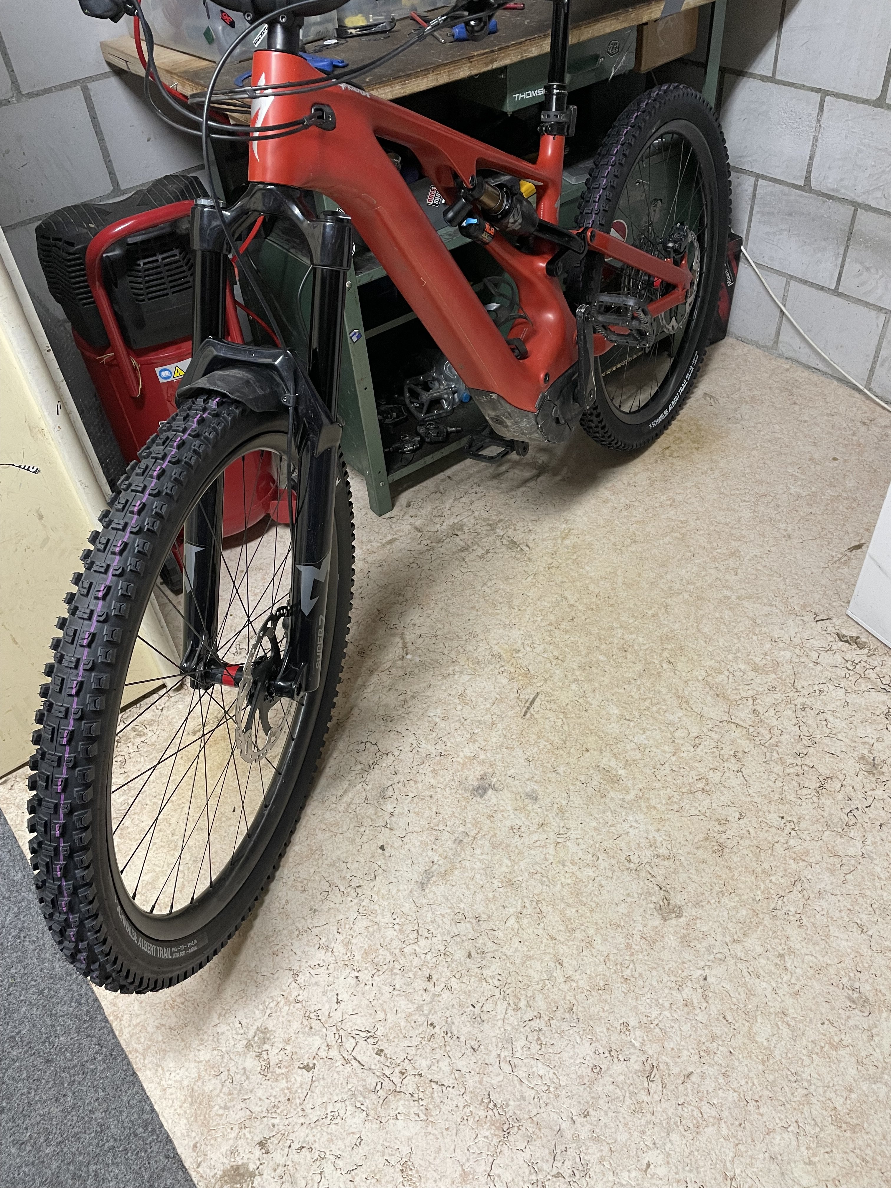

etoni
Sep 3, 2018
430
3,903
Thun Switzerland

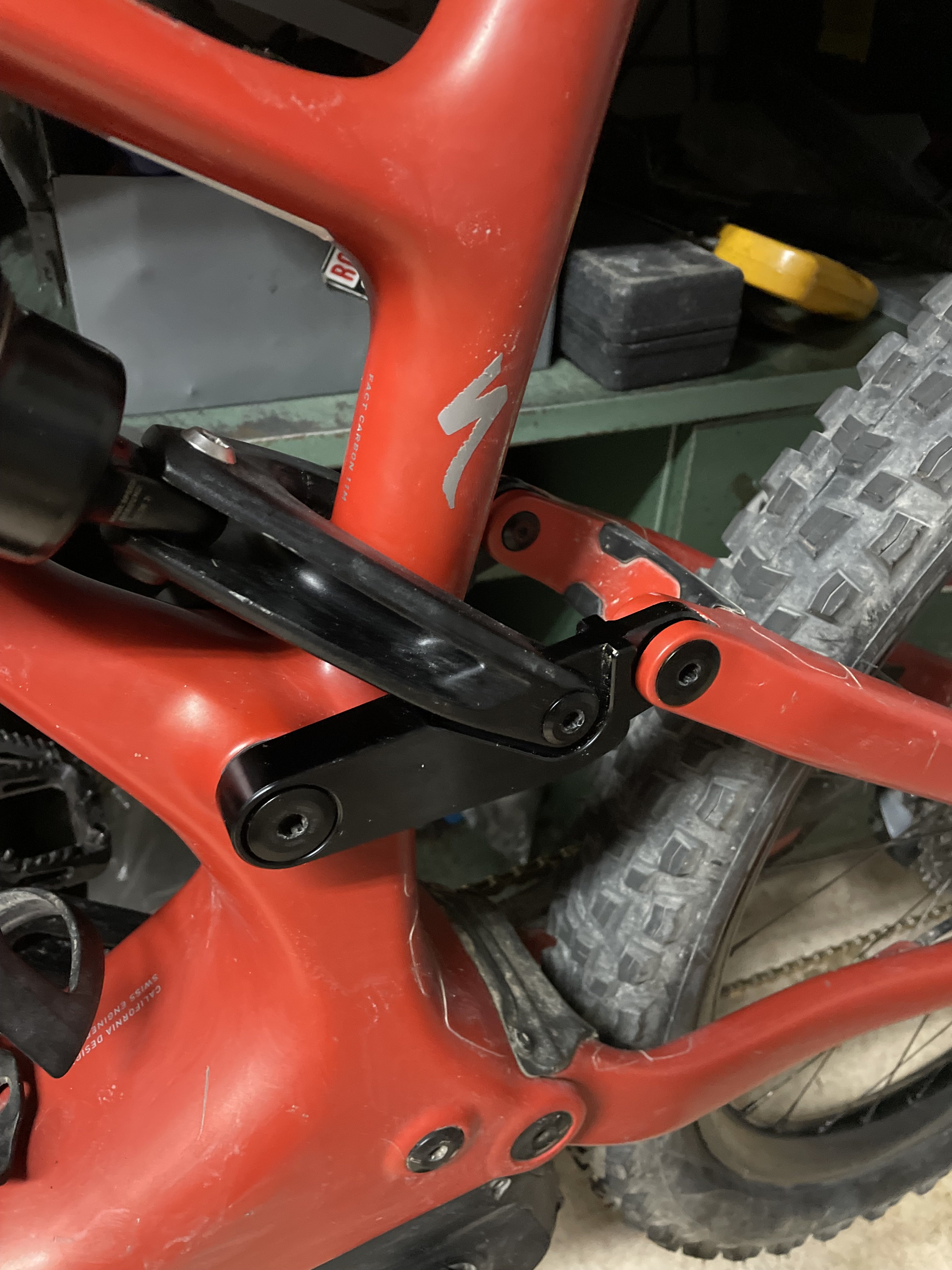

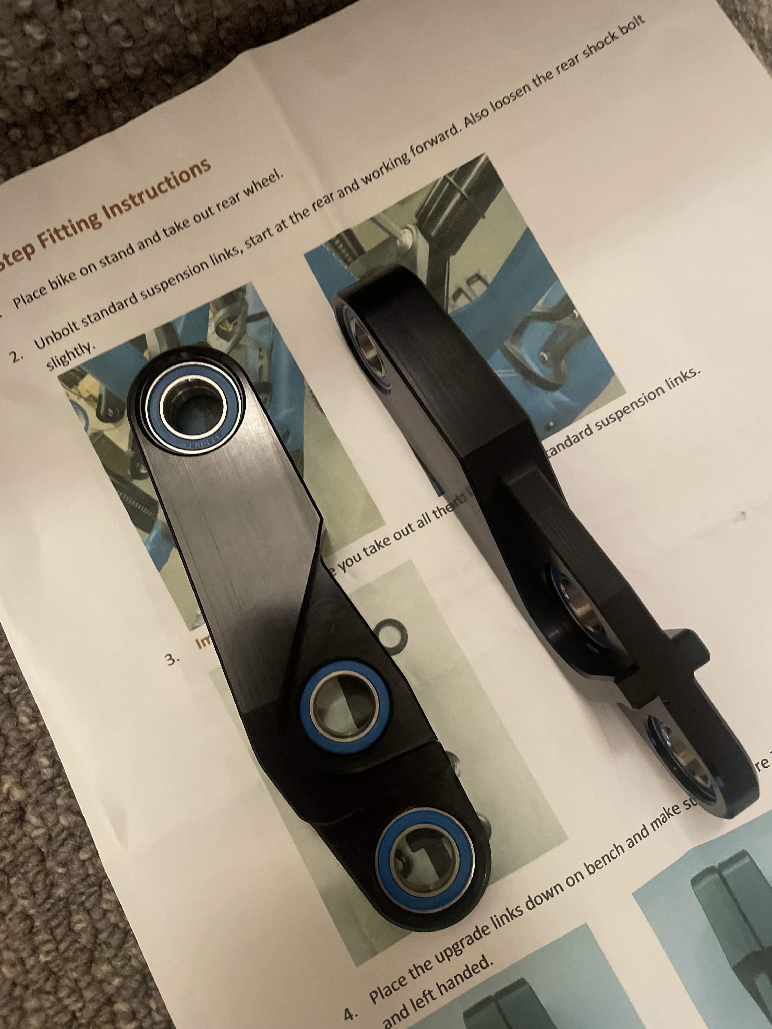

I installed this shock link from England last week, what a difference... I now ride on magic carpet. Also In my opinion the marzocchi super Z 38 gripX is better than the 38 gripX2, more simple.
Since I installed the 2021 tcu and have been riding with BLEVO, I have also had no loss of support and no interruptions to the push assist. I also found a dealer who sells completely overhauled 2.2brose for 379. So I can ride the best emtb on the market for a long time to come.
