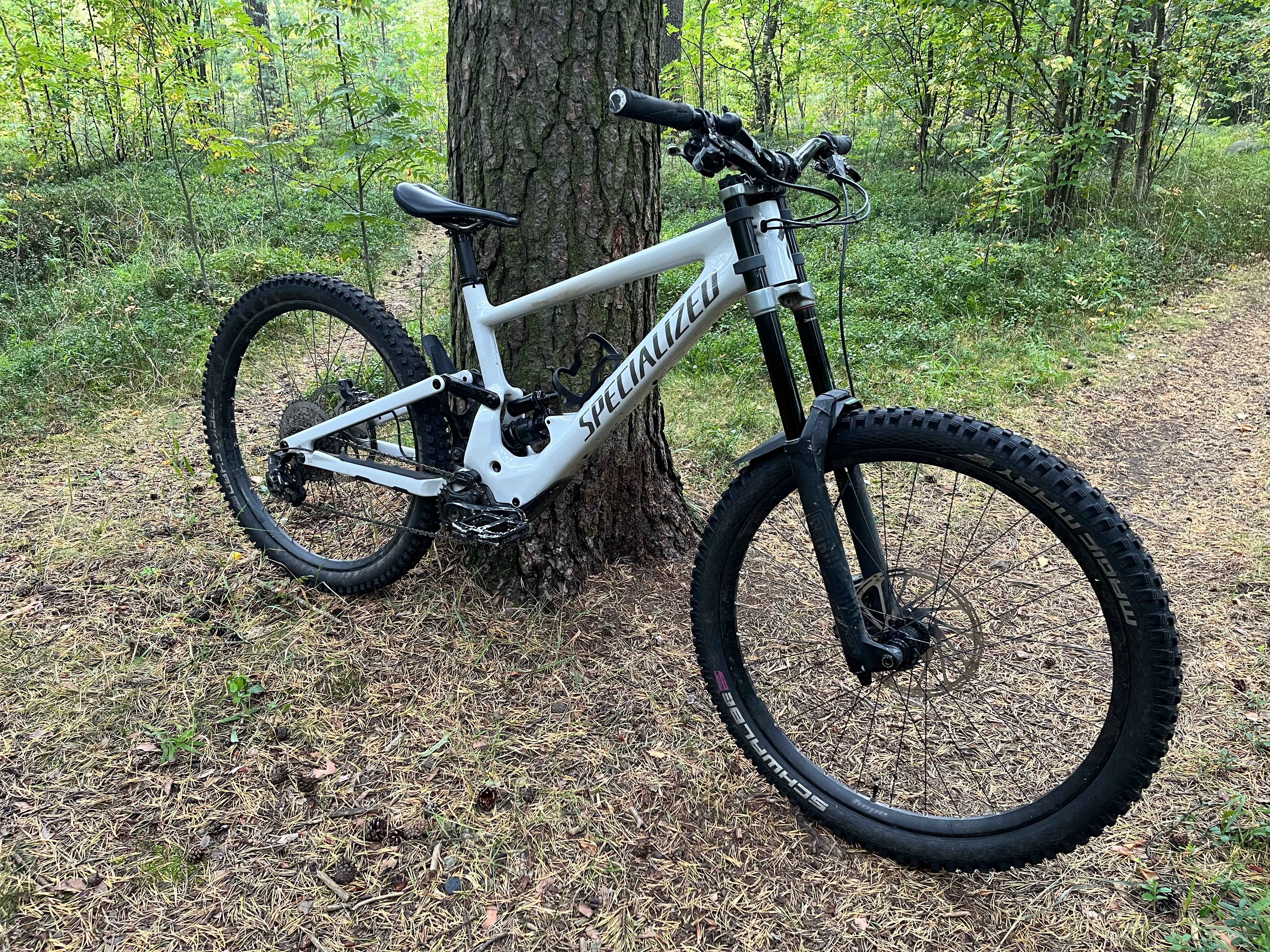

Pretty much the same as mine then. Im also s4, mullet, middle headset, flipchip high.
Just slightly concerned about the extra fork length compared to specialized max of a 170mm in the manual, which would be about 582mm a2c. Having said that they also say single crown only. However i have doubled up on the bumpers to help spread the load in a crash, either that or they will punch an even bigger hole into the carbon downtube.
Lets see a picture then. Dont see many ksl's with the vastly superior dual crown fork fitted 😈
Jul 1, 2022
25
44
Finland
Also double bumpers kitted. The C1 Boxxer with zero offset crowns (46 mm total) is propably the worst when it comes to clearance and turning radius. However, it still is a non-issue in all but the very slow speed tight turns, where you actually need to turn the bars instead of leaning the bike over. I had one lying around, but would recommed a fork with stanchions wider apart and/or more offset in the crowns instead of in the lower legs. I cannot go back to single crown either, but KSL would surely deserve a dual crown and cat 5 certifications from the get-go.
