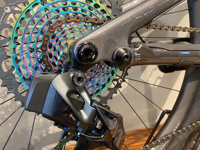

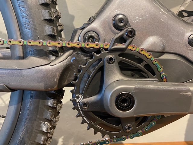

Anybody knows about the chainguide spacers? The manual says it comes pre aligned from factory. But mine was missing the big washer (J) under the black screw that connects the chainguide with the frame. And also the silver smaller washers (H) were placed weirdly. I assembled it like its portrayed in the manual but now the chain rubs at the inner side of the chainguide when the chain is on the biggest cog.
ssp00p10-png.74447

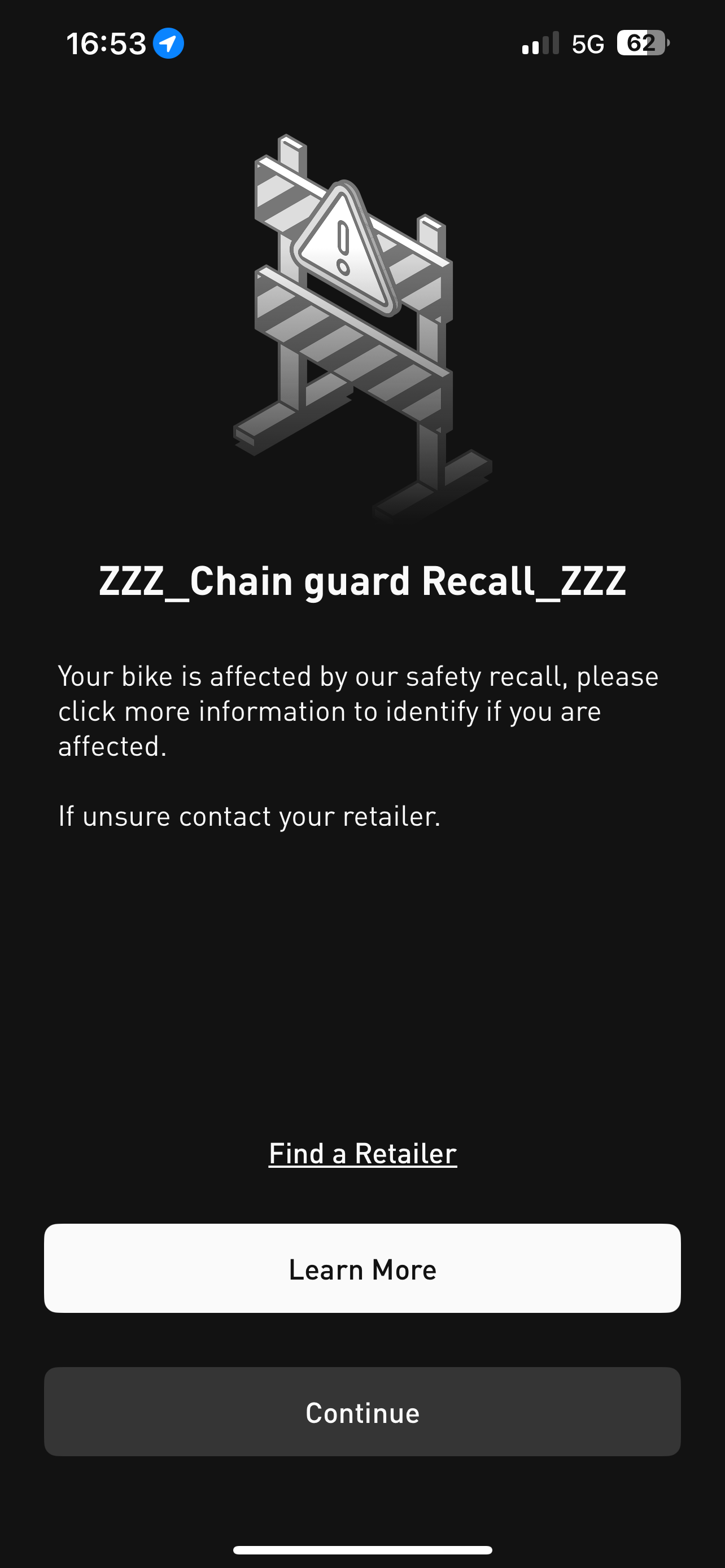

I have this show up on the app today about the chain guard, called the concept store but didn’t know anything about it
