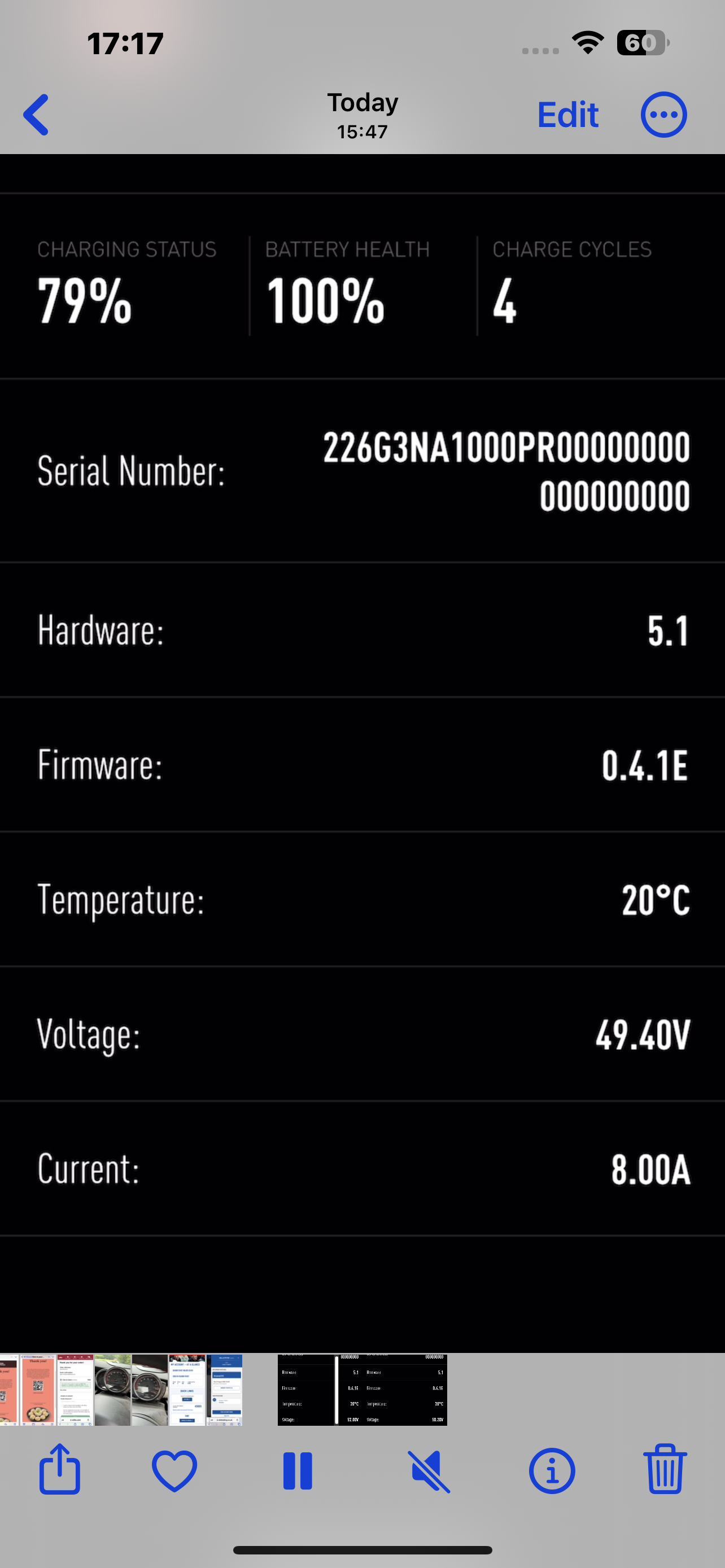

Not wishing to detract from the main KSL discussion, but the power discussion seems relevant ?
There are clearly anomalies between some 1.2 motors. Using the forum base to discover the differences (6 Amp max draw or nearer 8 Amp max draw) is normal and a good use of forum resources.
Some people will consider a new KSL or LSL if it has more power, but will want to be certain it does have more power.
Zimmerframe started a thread to discuss it in May but no one was interested in talking about it in a separate thread. It seems sometimes the discussion needs to stay in a main thread to gain interest.
Wouldn't "Rich people comparisons" only be interested in numbers, not actual performance. The lay man would want to make sure he's getting what he's supposed to get for his hard earned money ?

I have both bikes, and I can honestly say I am a complete idiot for spending the money just for the new motor. It's pointless, what Spez has given us (aptly named as 1.2 over the 1.1) as an upgrade is a joke.
Maybe I'm missing something (I've not really been following or involved), but what you're saying is you think your 1.2 performs basically the same as your 1.1 - which is the main point of this discussion and is what several have found.
Have you done the tests the other have tried above to see if your 1.2 is pulling 7.8 amps (400w), or if it's like the others and only pulling 6 Amps (300w) ?
If you only have the 6 amps, you can put up your firmware and we can compare and maybe work out what the difference is ?
IF these comparisons were done on the new KSL with the 1.2 motor I would say it's relevant to this thread. But again... apple with apples right? You can moderate your own way.
Does it make any difference ? If there's something which makes some 1.2 motors only draw 300w max and something which makes others draw 400w max, then surely it doesn't matter what bike it's in. What matters is that people can make sure they're getting a 400w bike if they buy a 1.2 LSL or KSL ? This is the KSL thread and some people will be thinking about upgrading ?
I ran a LSL gen 1 and a KSL with a 1.2 and they performed pretty much exactly the same as they did with the 1.1 (6 Amps peak). Then got no feedback from anyone else with motor/tcu firmwares so gave up with the whole thing.

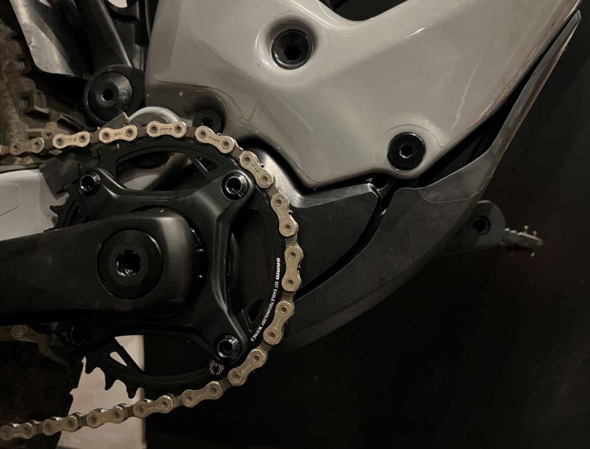

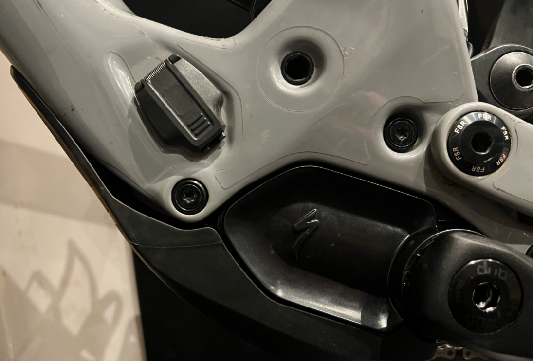

As Zimmer frame has shown in the 1.1 vs 1.2 the motor fits perfectly fine and runs perfectly fine using the matching donor mastermind.
The only modification that needs to be made is to the KSL bash plate. It need a bit of the “guts” to be removed with a dremel as the gen 2 motor case is slightly larger. Otherwise it works.

Your really are over dramatising things. The motor drops straight in, with no “muscling” and the $100 plastic bash guard requires minimal gutting.
If they sold the motor as an upgrade package they would sell a shed load to exsisting SL owners but knowing Specialized they would prefer to force people into buying a whole new bike.
Pity really
Edit, they could even supply you the upcoming gen 2 KSL bash guard and then no “hacking” is required

The motor fits fine. As @CjP says, the bashguard needs minor modifications if you want it to fit perfectly (or it sticks out slightly as in the pictures), but as he also states, you should be able to just buy the KSL 1.2 bashguard which will already have been factory modified/fabricated with the modifications.
