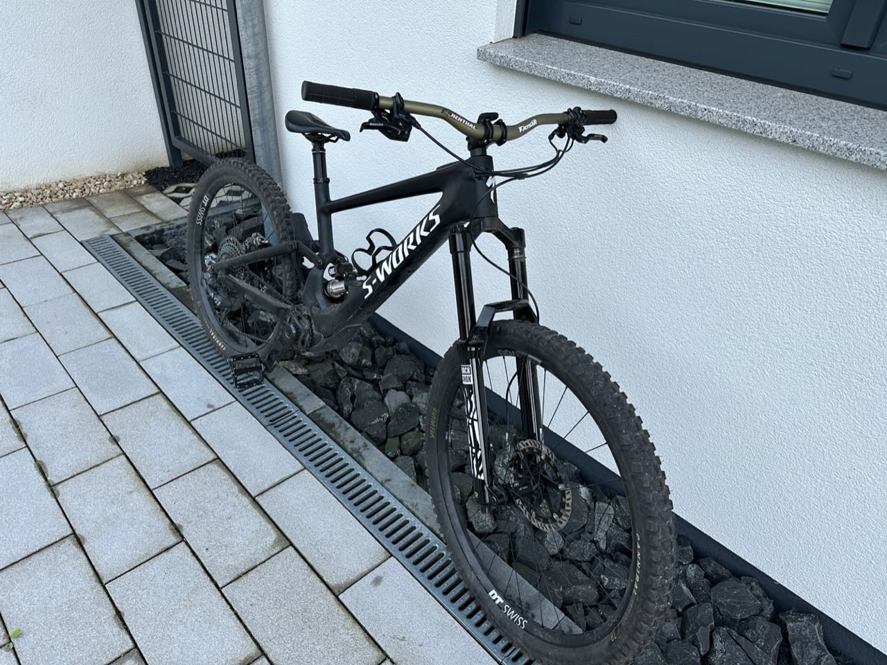

Ride also both Motors. 1.2 is better in all Situations and Settings.
Ksl in mullet is much More playful and for me the better Ride. Use high settings on chainstay and offsetbushing.
Right now i‘ve got a Park Setup with Alu rims and Alu bar.
Fork now zeb 180 and switching back to back with a 38. in Winter i will try a Mezzer from rulezman.
Ksl is an awesome bike

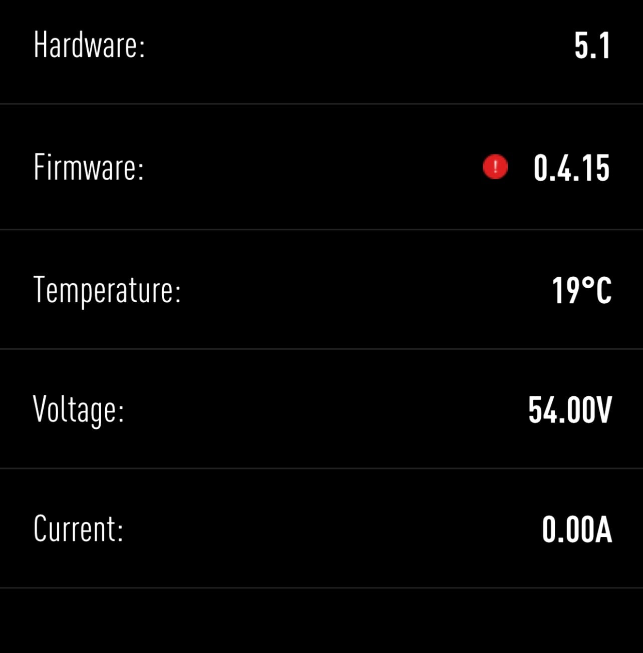

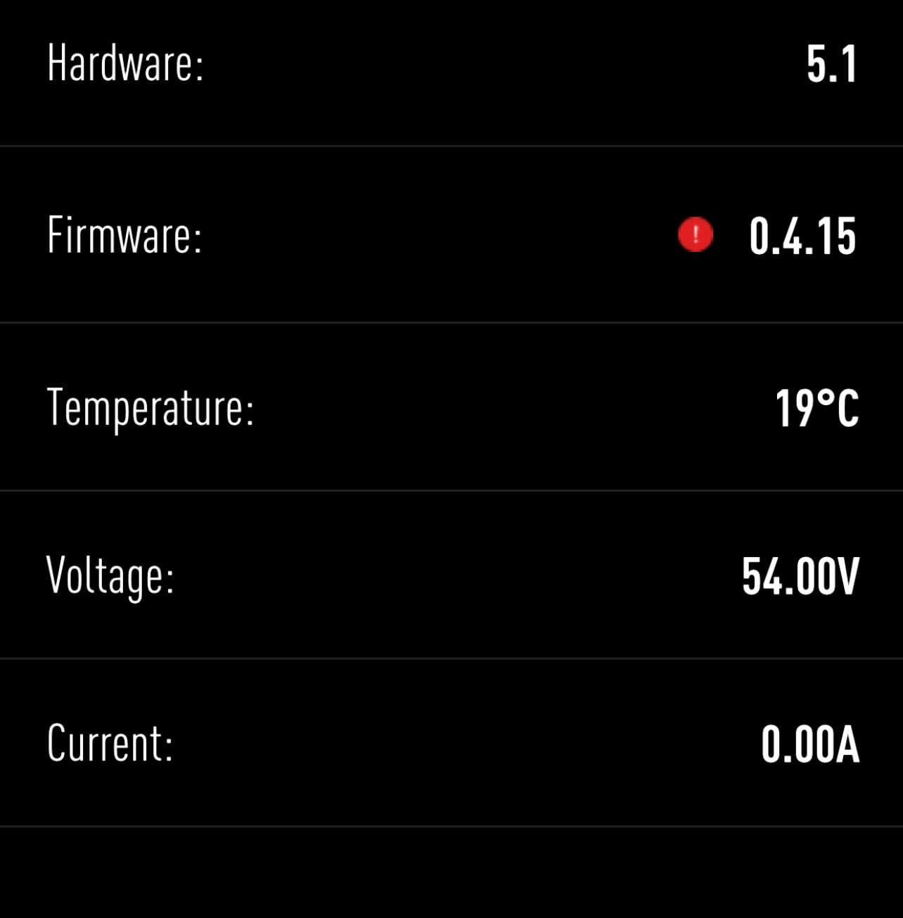

Go into Diagnose, then battery where it shows voltage and current and screen record while you ride the bike up a steep ass hill. Post results so I can compare it to my Kenevo.

Sorry I meant screen record that screen while riding and it will shows the moving data. I have a video of my KSL vs Gen 2LSL to compare to others results.

Is this not just going to show us how much battery / power the system is using? I thought the SL1.2 motor was more efficient - so could perhaps be putting out more torque whilst using less power?
Is there not a way of measuring something like torque or watts that would give us a true representation of what the motor is actually producing?

I could be wrong but I thought it was volts x amps= Watts
In any case I am trying to see if there are differences between what I have experienced and what some who are claiming more power than previous Gen have experienced. Some of which I respect and therefore value their opinions.
I am going to try hire another bike from a different supplier for another comparison.
So we're trying to see if the SL1.2 delivers the 320W it's claimed to? The SL1.1 was 240W?
If you already have the output from your 1.1 motor, how many Watts did you see from it?

I’m sure I read the SL1 morors produce more then the quoted powers from day 1 but for reference my KSL spits about 50v@ 6 amps so according to my above equation around 300w. This was on a short 100m climb in the second biggest cog.
I am going to try pick up a bike this week and get a proper reading of both my KSL and a Gen 2 on a steep ass climb to get a longer more thorough reading.
