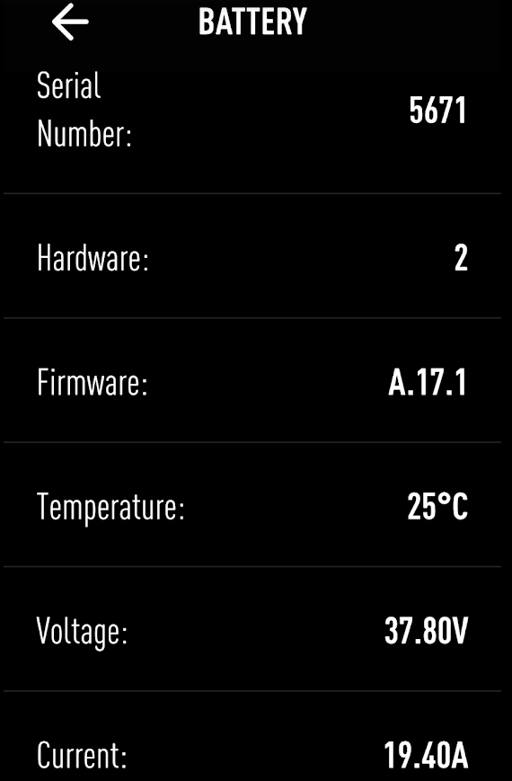

Can't find an upto date example, but this was on a Kenevo FF
For this example, 37.8 Volts * 19.4 Amps, means it's drawing 733 Watts.

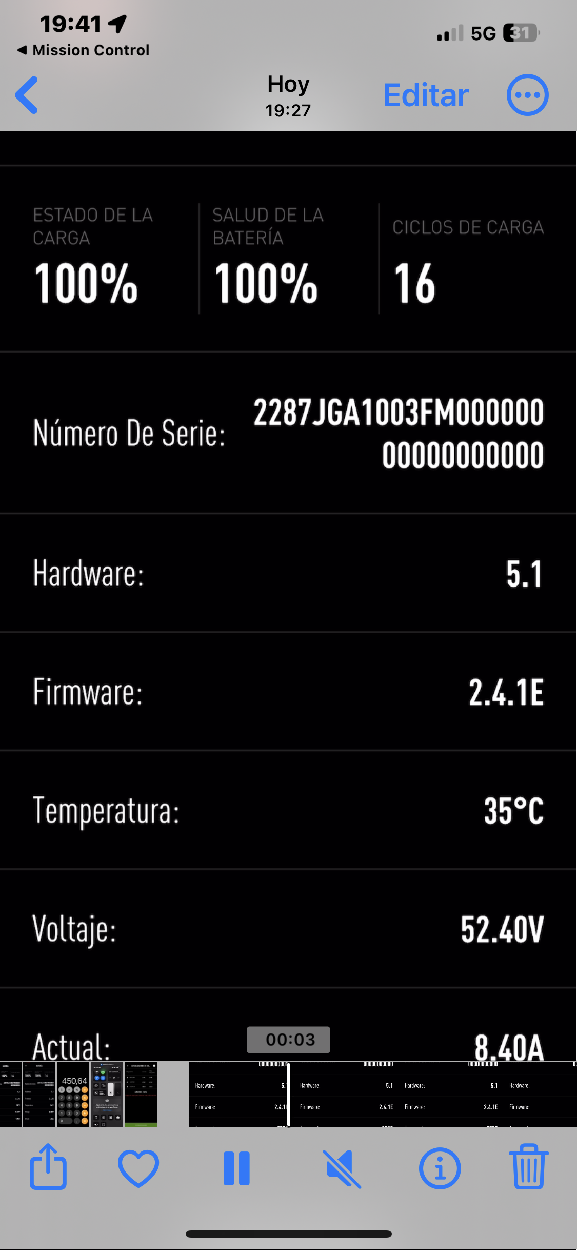

cañonaco
Feb 3, 2020
61
77
España

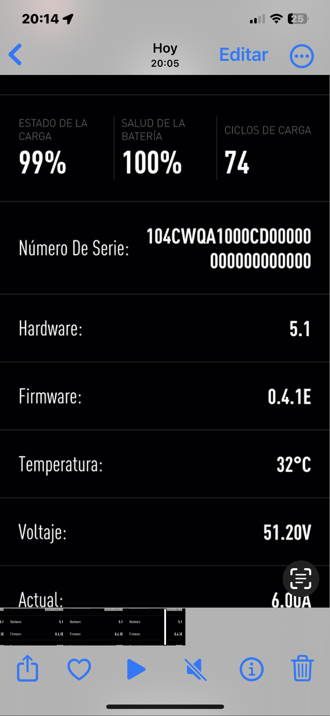

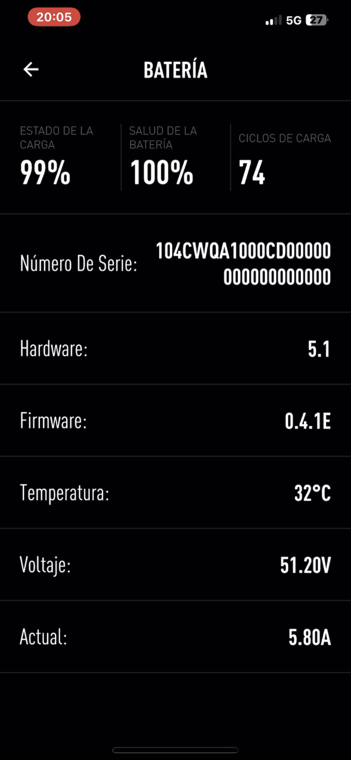

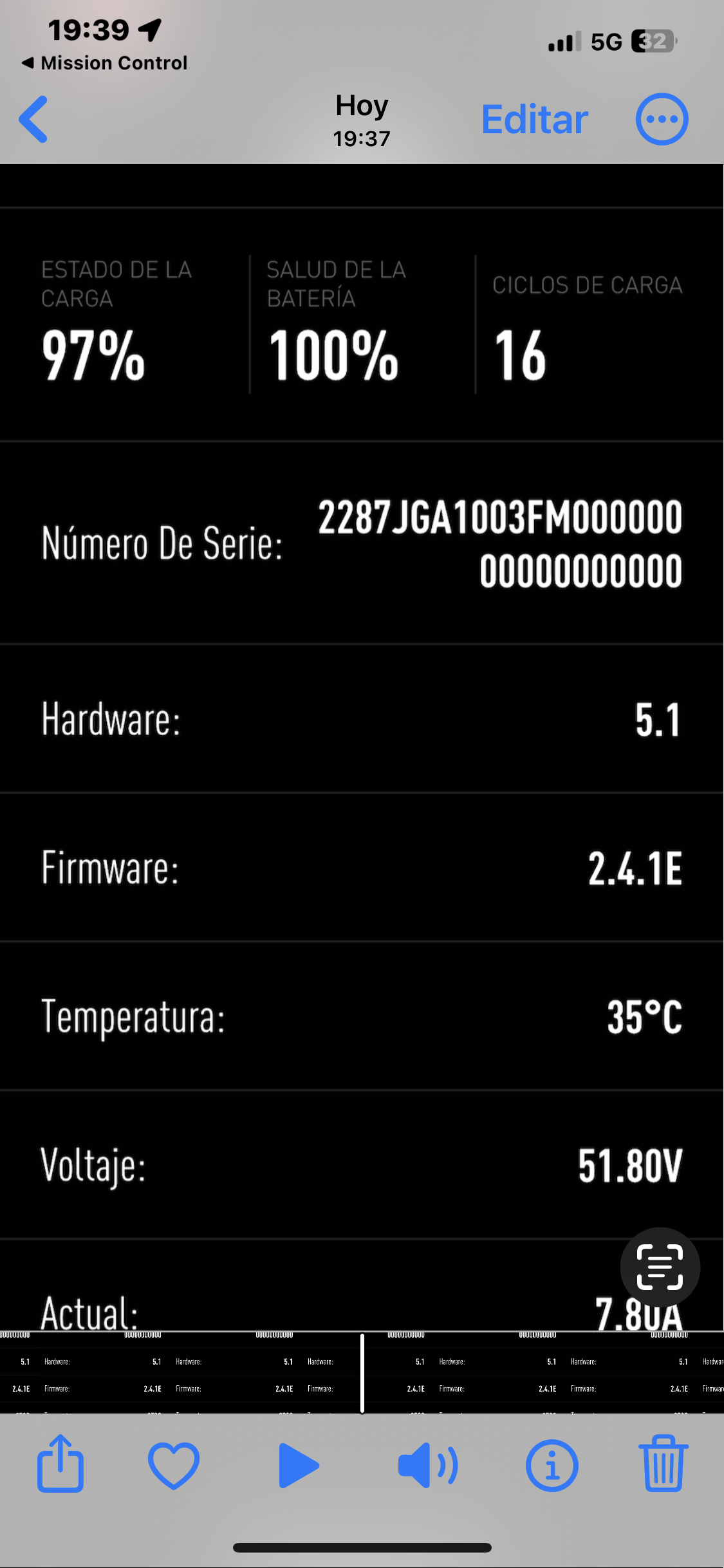

This afternoon, after a while of tests, I have managed to get the motors to give the maximum around 60-70 rpm. To remove it I have placed a medium sprocket and a 100/100 configuration. The slope is not too long but it has been repeated many times.
KSL has not sustained more than 5.80A with 6.00A spikes.
LS2 has sustained 7.80 A with peaks up to 8.40 A.
I think that all of this coincides with the values of the brand, with the dyno test and with the sensations in motion.

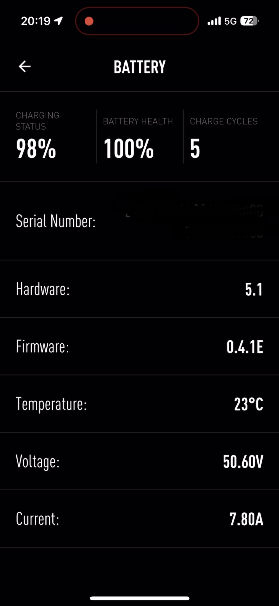

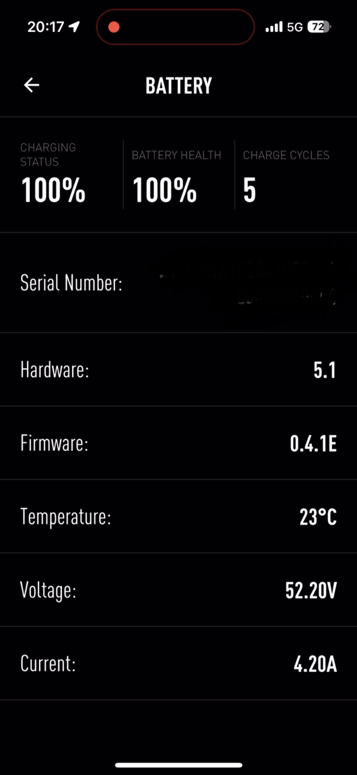

I did a run a minute ago… and am still breathing heavily from it!!
Started at the bottom of the hill with 100%.
I crawled along in 2nd gear up the hill. I must’ve had cadence of about 80 at this point. The motor was whining and giving me good support.
I then upped the pace and went through the gears - getting up to about 8th and hammering up the hill reaching 14mph (and my legs were burning!!)
The battery dropped 2% over this half mile climb, and my heart rate jumped from about 70 to 161 😂
At the peak, I had a steady 7.20 to 7.80A on my recording over the course of a minute or so. Output of 395W apparently, so better than claimed.

Output will be slightly less, 395 is what it’s pulling from the battery, the motor will not be 100% efficient.
cañonaco’s post above has it with 8.40A… which would be 440W.
The motor is listed to output 320W, so even with the claimed 80% efficiency, it’s still producing more than it should (352W). Even at 7.80A it’s just on the 320W.
