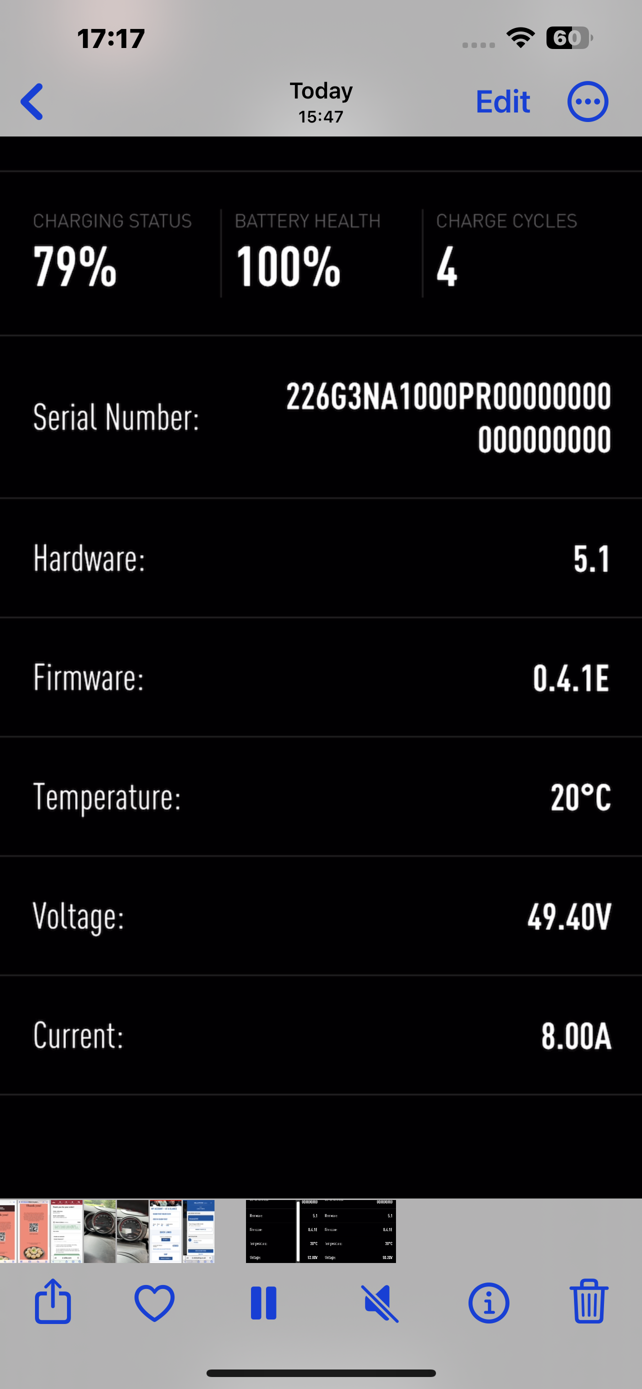

I’ve just found this thread after being asked by CJP to see what power I was drawing from my Gen 2 LSL. I’m happy to post hardware and firmware numbers if required to help those not getting the full power to get it resolved.
For the record, my Gen 2 felt noticeably more powerful straight away when compared to my Gen 1. In fact , Turbo 100/100 felt the bike was running away from me a bit! Screenshot from recording whilst riding. The battery was charged to 80% and I could probably have given it a bit more effort. Bike was ‘shop plug in’ updated from new as the mastermind said it was required.
Have any of those struggling to get the full power out of their 1.2 motors managed to get it resolved?
I do have a friend who works at Specialized UK and can raise it with him if things are yet to resolve for those affected.

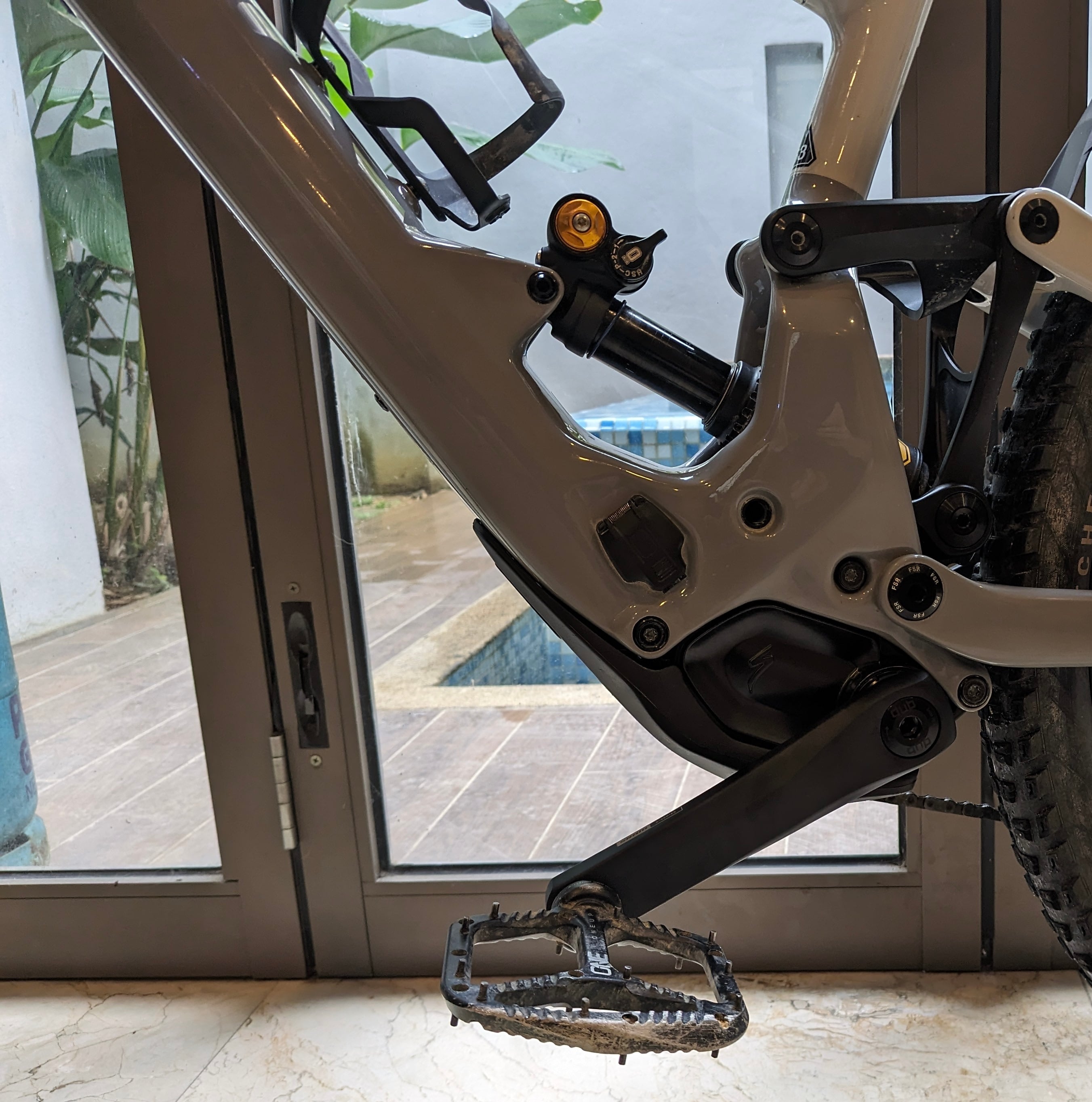

I fancied a bit of a trail bike to go with my kenevo FF And Kenevo sl, so picked up a new Levo sl gen2 comp, but fancied having the more powerful motor in the KSL so did a full internals swap (tech, motor and battery). Took about 30mins, didn’t even need to remove the chain rings. I now have a quiter and noticeably more powerful KSL :), and a less powerful but lighter Levo sl Gen 2. Happy days, KSl with the 1.2 and The t-type transmission has me falling back in love with the bike. The original KSl bashguard fits well with some minor modifications.
