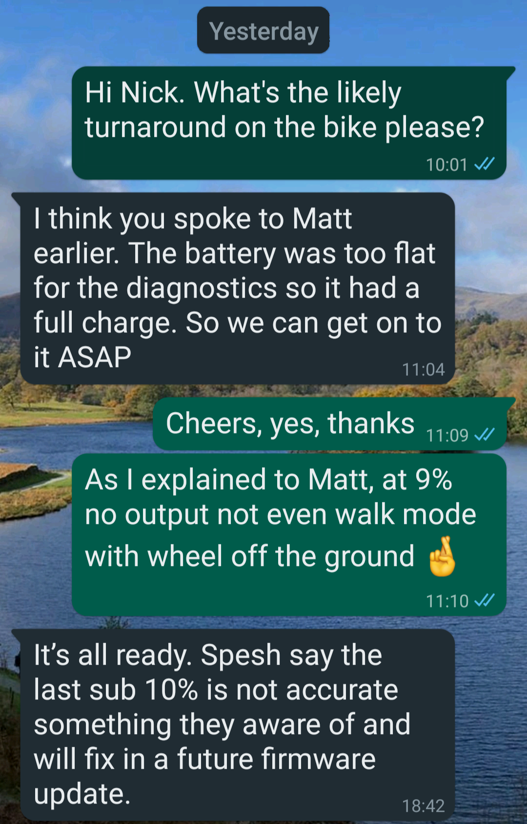

I'm wondering why bike died at 9% left on a ride. Display working but no output. Turned it on and off a few times. So pedalled it home
Looks like there is an issue for some that needs a software update
