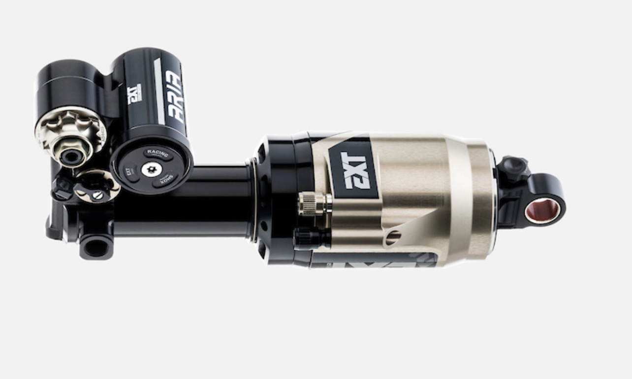

I assume Mojo tried rotating the air can to see if it would clear with the valves in a different orientation?
The can itself is quite large and wouldn’t have much clearance, the air valves can only go up or down on an angle but would foul anyway.
In saying this I have not tried it myself but my eye measure says not even close.

Did he say what aspect of the shock makes it a no-go?
sorry i took so long. we measured the space of the tunnel on my bike on the phone and he confirmed the valves wouldn't fit through the tunnel. Chris was a gent and gave me a little bit of compo as it was he who recommended me the shock. i now have the E-Storia Fitted. cant ride it yet as got knee injury.
I was having a good look at my bike and I think part of the problem with the Aria is that both valves are together, making that area more bulky. If they redesigned it so that the valves are on either side of the air can then it would fit more bikes because it wouldn't be any wider than the air can itself, with the valves at 10 o'clock and 2 o'clock, if you follow me?
I don't think the valves could be on top of the can or they would probably foul the damper head when into the stroke.
I was gutted when he phoned me. Even more gutted I have knee injury. If they bring out a v2 they should redesign those valves as you said.

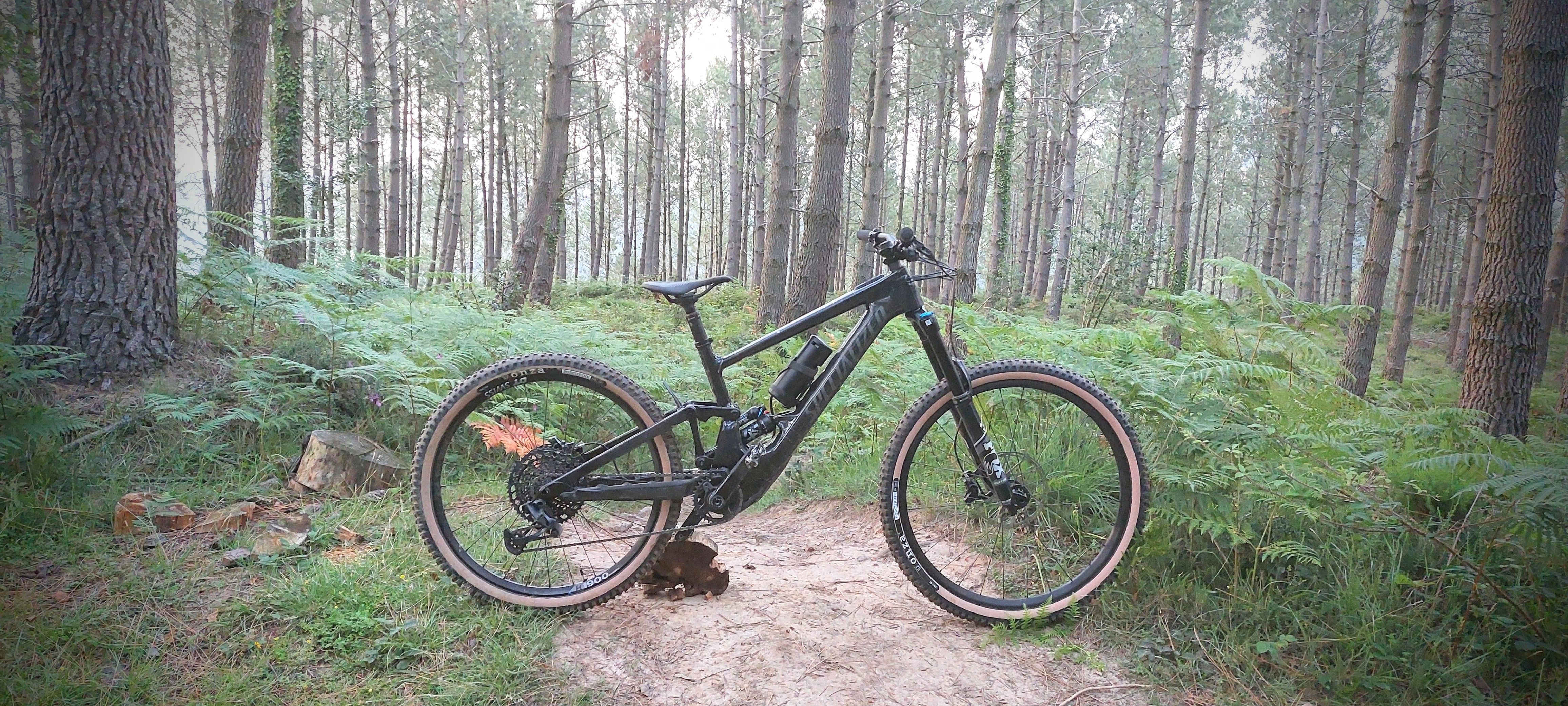

Hello, this is my KSl, converted to a mullet, Dt 1900H 27.5 wheel and Onza Porcupine 2.40 tyre. Other changes from the original are the front tyre changed to Onza Porcupine 29×2.40 and a 30mm Race Face stem.
The geometry in "High" position: 33.5cm Bottom Bracket and 63.2° steering angle, the behavior is a little more like a DH, which is what I was looking for.
The next thing will be to install a 180mm air shaft and change the direction to -1°, changing to "Low" the BB should be on 33.3cm and the direction on 63.7°.
The current weight with pedals is 18.60kg (41 Lbs)
The next thing will be to install a 180mm stem to the fork and change the direction to -1°, changing to "Low" the BB should be on 33.3cm and the direction on 63.7°.
The current weight with pedals is 18.60kg (41 Lbs) View attachment 120566
Nice rig! I did the same, 180mm fork helped but I also got a set of Praxis 160mm cranks, that really helped with the pedal strikes post mullet.
