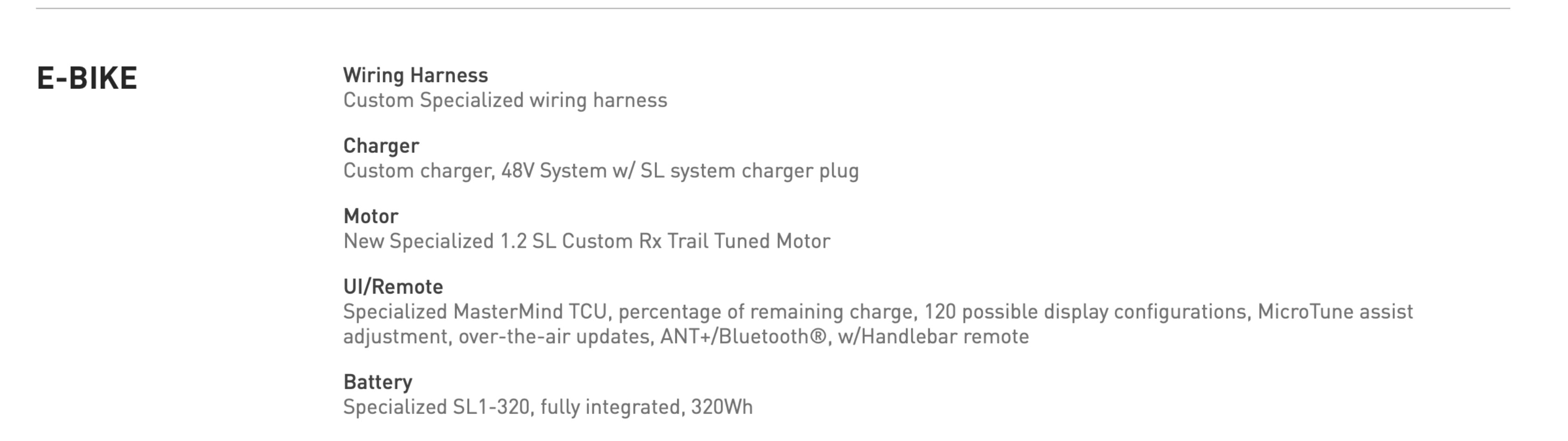

Why not just make the new motor backwards compatible for people who don’t want two spend thousands on a new bike I sold my KSL because I didn’t like the motor if I knew I could replace it with new motor I might of kept it
Because they don’t sell any new bikes

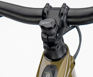

I have some problems with cracking in my headset and I figured out this is due to a design failure eg. floating headstem/headset.
Does anyone know if this concave fixed spacer instead of more ring spacers kind of solves the issue or should I look into aftermarket headsets instead?
What is the model of this concave-ish spacer?
How did you eliminate the cracking?
that spacer should be in your pack when you buy the bike. Its certainly in my levos pack
