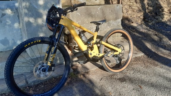

Ciao, anche la mia è gialla, io la chiamo "la banana", mi piace molto sia in salita che ovviamente in discesa, cambiati freni, manopole, gomme e pignone 30 denti.

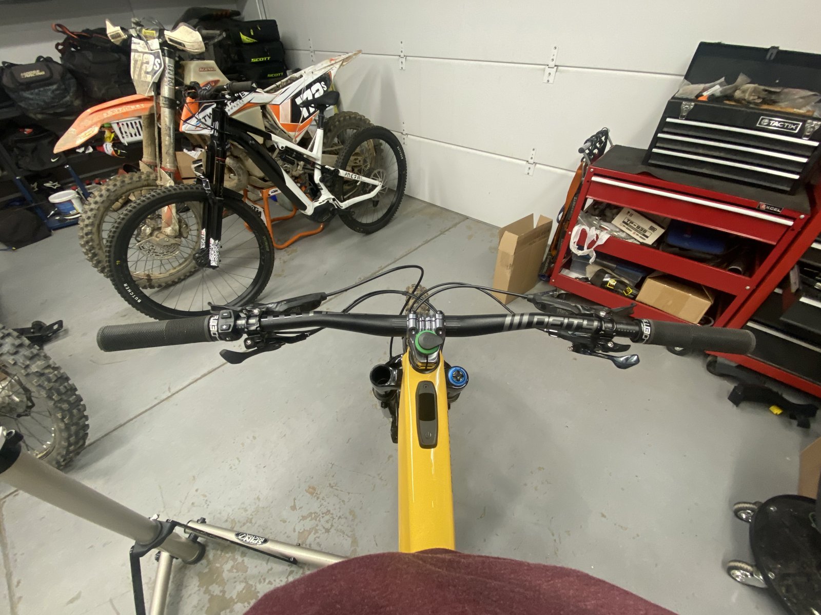

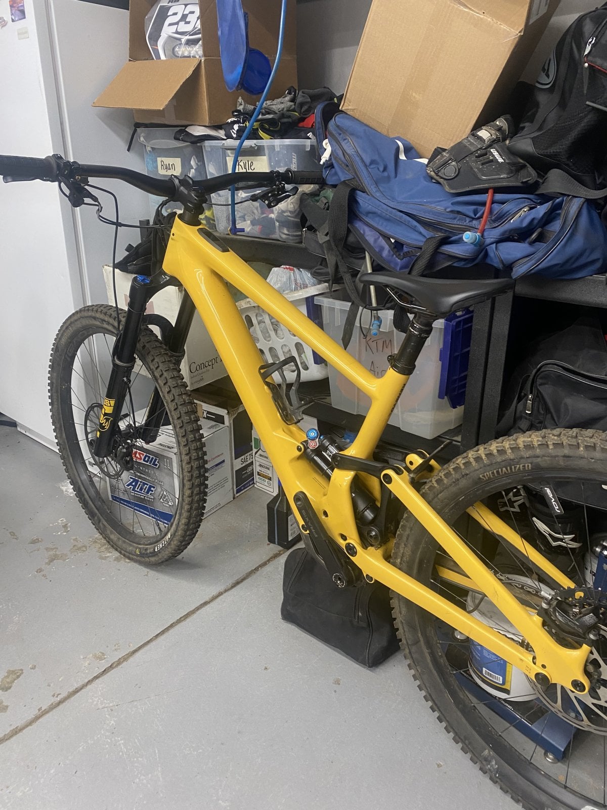

Haven’t been following this thread, but just picked up a lightly used Kenevo SL s4 Expert build. Don’t love the yellow at initial impression, but maybe it will grow in me. Also plan to swap out the wheels, brakes, and cockpit before I take this bad boy out for a test ride. (Ignore the mess in the background, Lol).
Same exact feeling, I got a used yellow S3, less than 100mi on the odo, kinda like the banana now. Swapped a couple parts, went coil Jade X and rides waaay better.

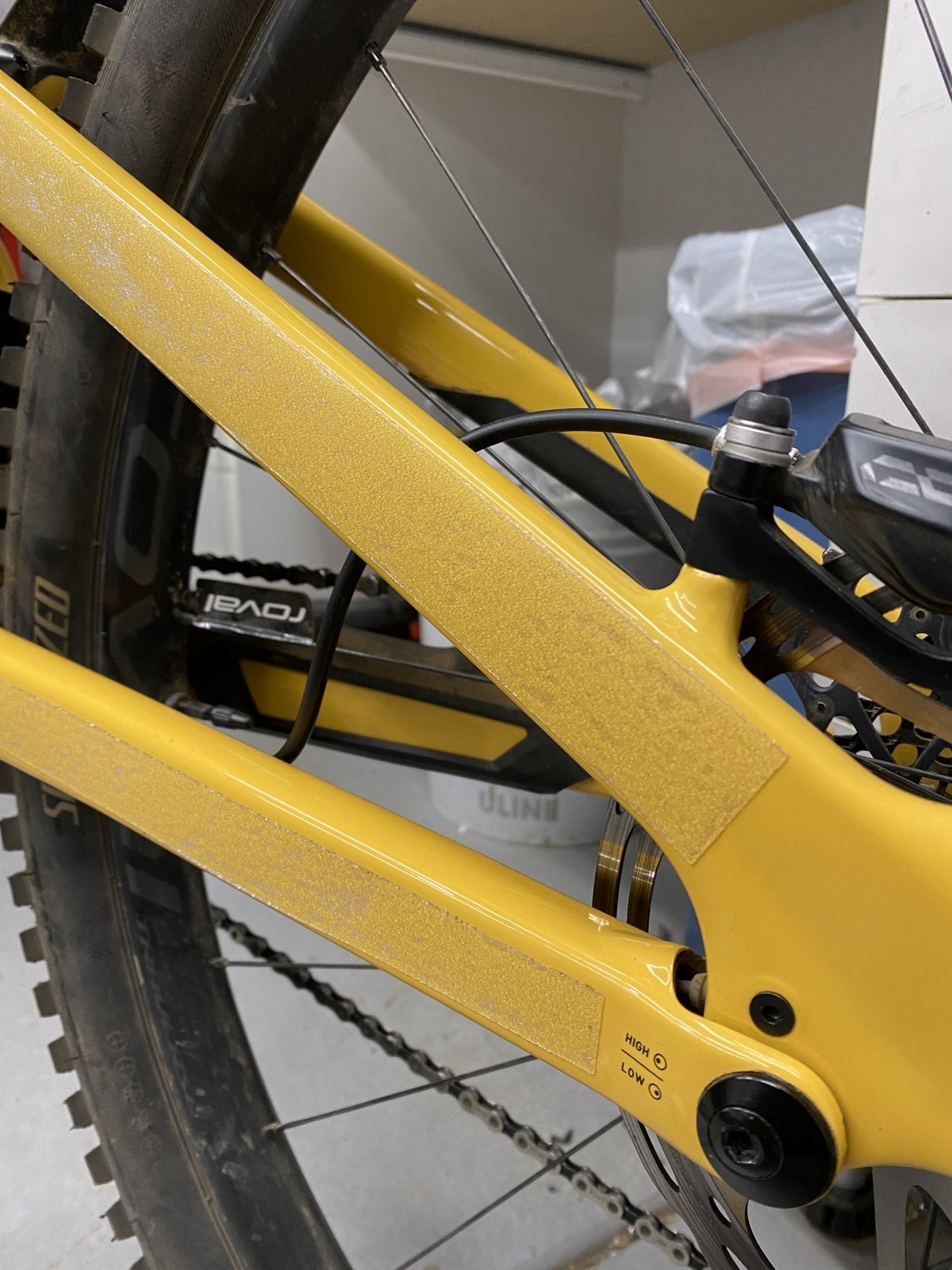

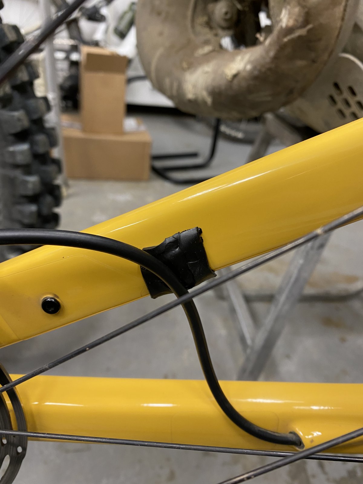

Thought I’d share my build as I go. Even though I’m starting with a used frame, the first thing I always like to do is clean the frame and apply protection tape on the seat/chain stays where my heels could scuff. I used to cover every inch of the frame with some type of tape, but now I’m too lazy and don’t care enough. Also put some mastic tape where the rear brake line is routed to keep it from tapping on the frame as I bounce down the trail. Would recommend both these product as they peel right off with no residue. More interesting updates to come in the near future.

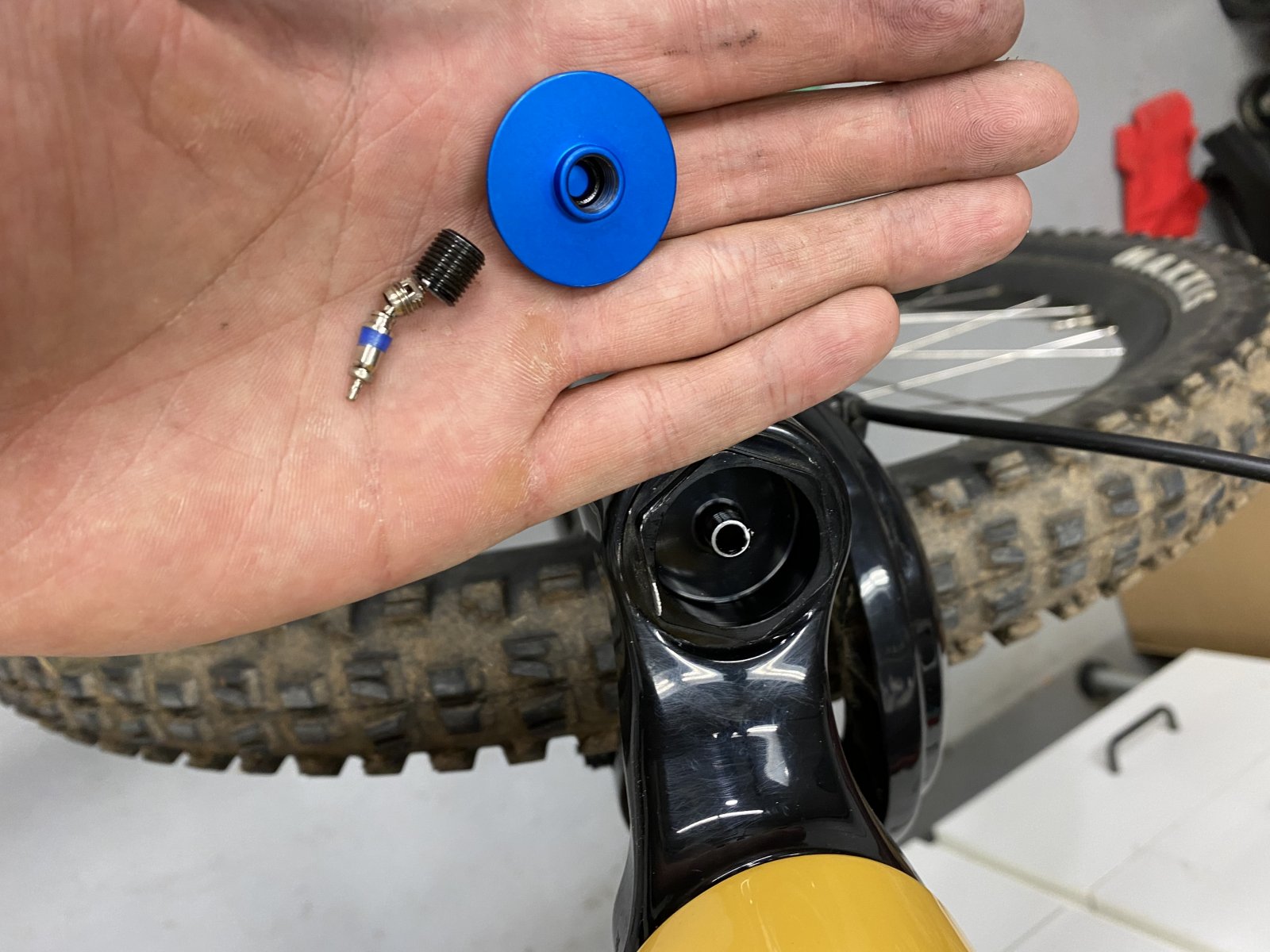

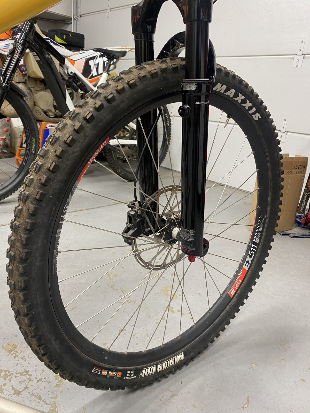

Threw on my spare wheel set of EX511’s/350 hubs. Changed out the cockpit because I dislike 35mm diameter bars. Also replaced the specialized swat tool with the OneUp. Unfortunately last week before I was gonna take it out for the first ride, I broke off the fork air valve inside the air pump. And these are not available for individual sale anywhere in the US. My bike shop if working on getting one from Fox, and if that doesn’t work out quickly I guess I’ll get the mrp ramp control cartridge which will work. Already 2 weekends went by and haven’t even gotten out to ride the bike yet.

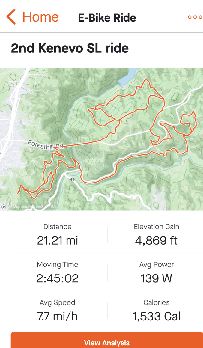

Jus got my new Kenevo SL Comp S3.
I'm coming from 2 seasons on the original Kenevo Expert and 2 seasons on a Levo Expert, which I haven 't sold yet but I will soon!
I've done a couple of changes; DVO Onyx fork, Code's RSC, BikeYoke Reverv seat post, (the stock is too long for me) waiting for a set of carbon wheels and maybe I will get a DVO Jade X, we'll see!.
The first two rides were positive, the bike is definitely a BEAST on rough DH, like I was expecting to be, everybody knows that. I did ride almost 5,000ft of climbing and 22 miles with 43% battery left without RE so if I add the range extender I will manage decent long rides. I did the same ride a couple of weeks ago with the Levo and I can tell you that my legs where hurting way more at the end with the KSL for the obvious reason of less power. If I knew that I was going to have that much battery left I would have use more power, now I know!
Unfortunately I will have to wait for the snow to melt to test a few familiar steep, rock tech uphills to see if I can clear them with this bike like I do with the Levo. I'm not really confident because the torque is way lower, time will tell. One thing I know is that if I ride with my friends on FF bikes, even though they use Eco and Trail mostly all the time, I will struggle a bit, time will tell too but I'm optimistic that it won't kill me.
Anyway I felt that I wanted to share my first experience with you guys.
Ugh. Shouldn't be so hard to get a small part like that.
DSD Runt is worth considering as an alternative: The RUNT for FOX 38 — Diaz Suspension Design

Unfortunately my local bike shop (which I have a great relationship with) said Fox was completely unhelpful and wanted to put me on a 3-4 week waitlist before they even looked at his warranty claim. So I’m just gonna buy the MRP ramp control device so I can actually get out and ride this bike ASAP. Runt looks sick, but even more money that I wasn’t planning on spending in the first place.
