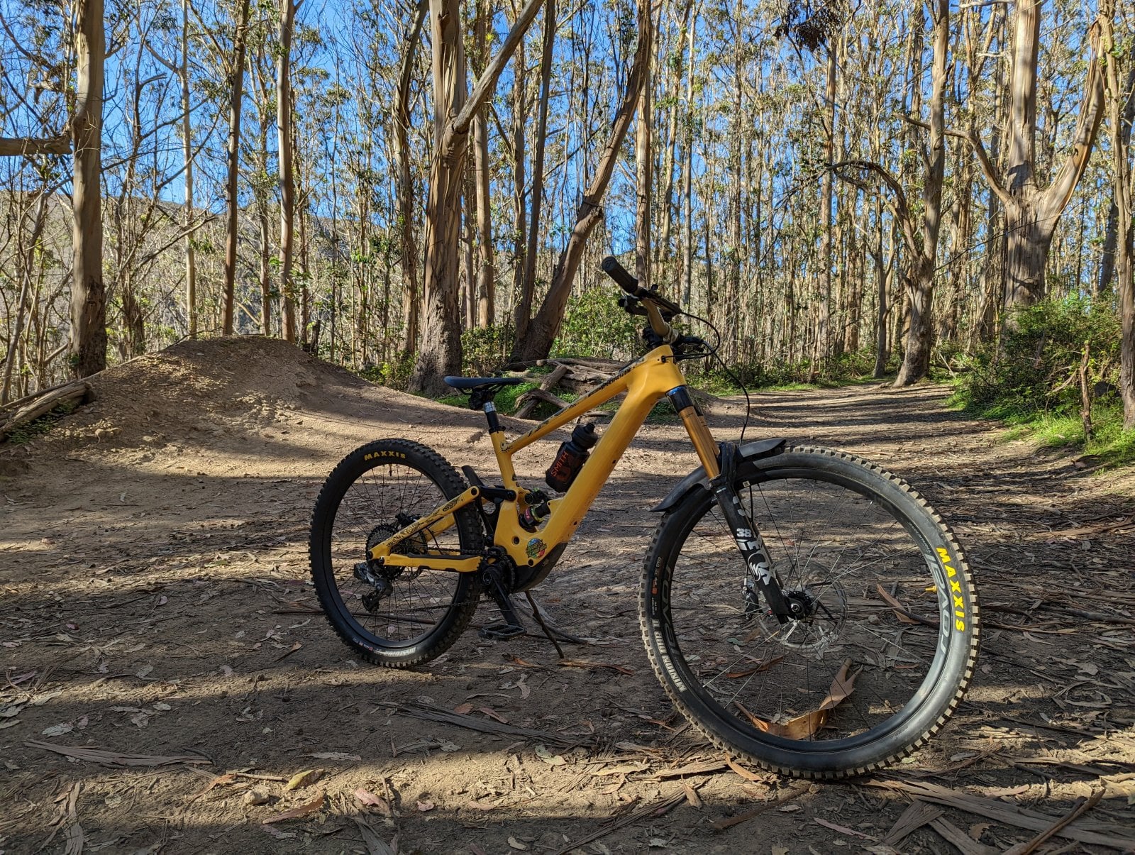

Update on my Estoria experience, I have been beyond stoked with mine after I went up in spring rate and stiffer compression tune. Feeling noticeably better than storia I have on my geometron. That combined with heavily tuned Mezzer up front + cush core makes it feel like cheating. So fun.

Lol. I've set mine up mullet too. IMO it rides better for nonracer bros like me,lol. I hate tire buzz on every ride. Waaay easier to ride steeps and tight turns.
