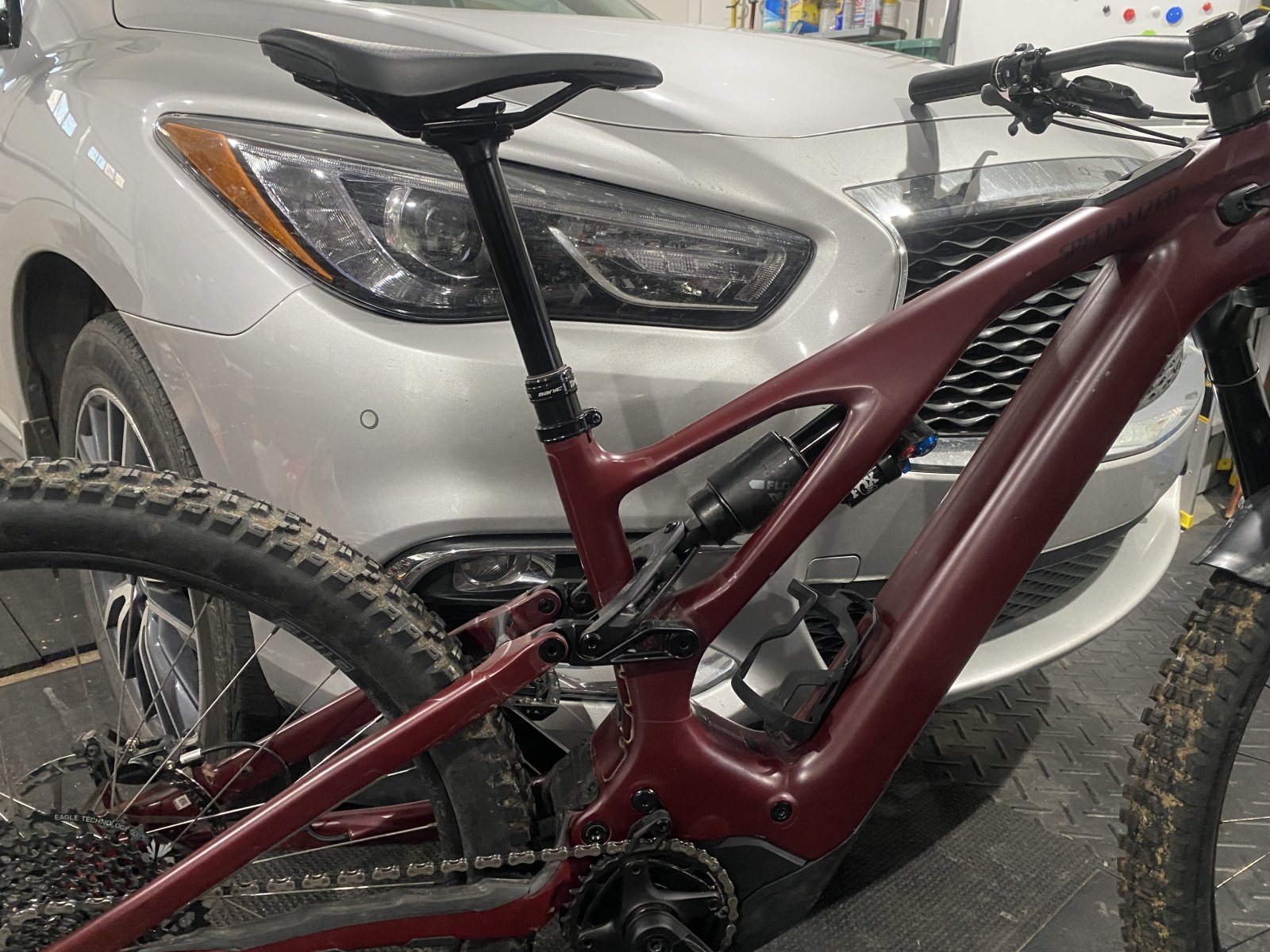

This is how the Levo post looks. Drop seems to be good, I think. I can comfortably stand flat-footed with the seat all the way down. Thoughts?
Doomanic
🛠️Wrecker🛠️
Jan 21, 2018
8,875
10,692
The KSL has a much shorter seat tube, you'll really need to try one to be sure. On my mate's S3 the seat was a fraction too high with the stock seat post fully slammed.
