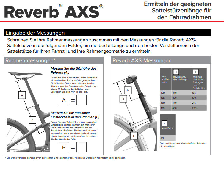

That is how I measured mine, not parallel to the seat tube. You‘re inseam appears to be shorter than mine. I would think you could get away with a 180mm dropper. The OneUp website has all the measurements on their droppers for you to be able to determine which dropper would fit. In addition, you can shim their droppers up or down 20mm. I bought the 210mm post and had to shim it down to 200mm to get it to fit. It is very easy to do at home.
For what it’s worth, I downsized a frame size on this bike and am glad I did. I would have normally bought the S4, but after doing some research, I chose the S3. I‘ve ridden the bike park where I usually ride a DH bike and never felt like the bike was too small.
Hi @Endoguru,
great explanation so far. Thank you. I have noticed that is not that easy to find a proper dropper for a S3.
I am 176 cm tall and have a inseam of 82 cm. Inseam is the most important part of finding a proper droppe. I have measured seat height of 260mm on a Kenevo SL S3. Measurement was taken from upper side of saddle clamp up to seat rails (see down below A).
This is how everybody else does the measurement. See RockShox AXS explanation:
As a conclusion unfortunately a AXS 170mm will not work on a S3.
OneUp built its droppers with a minimum of total length. Great for (short seat tubed) Kenevo SL riders.
@Endoguru
May I ask what your measurment of A (see illustration above) on your Kenevo is and what's your inseam (in mm or cm)?
Thanks

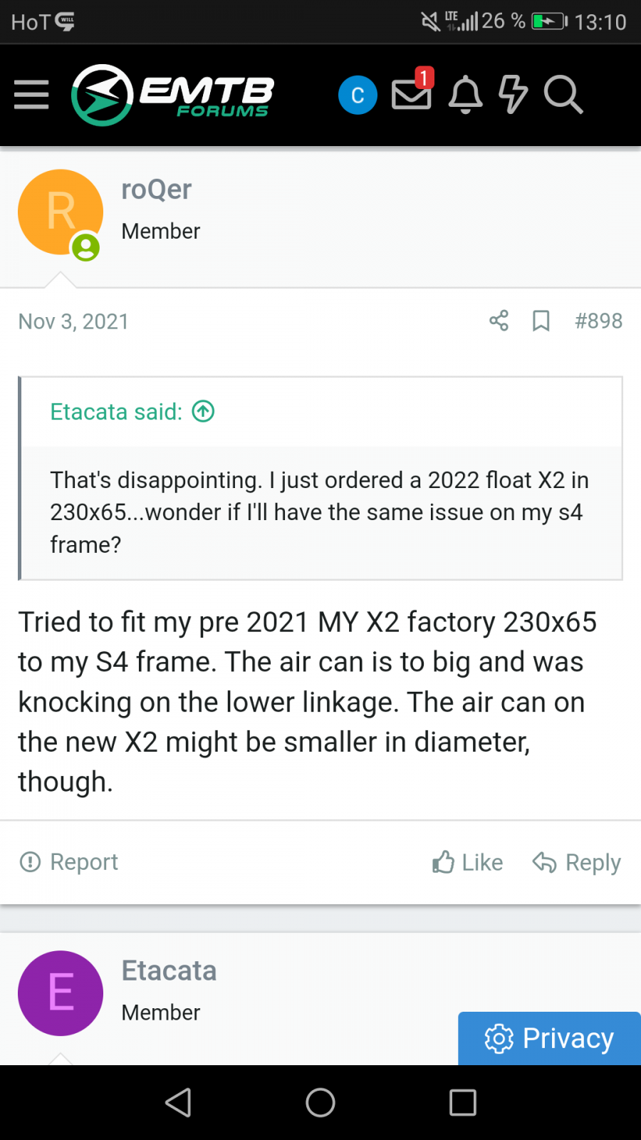

Hey guys, short shockcompabilty question.
I remember few sites ago somebody posted a pre2021 Fox X2 shock will not fit the KSL.
I have a chatdude who say in his bike fits perfect.
Pls,....is any serious mechanic here who can confirm fit or notfit?

I had a 2020 X2 230x65 that was a take off from another bike. I sent it to Fluid Focus for a custom tune and they shortened the stroke to 62.5 as well. It fits on my S3 easily. I have 3 or 4 rides on it with no issues.

Hi @Endoguru,
@Endoguru
Thanks
Tim
A measurement = 325mm. My inseam is 33.5” which is 85.09cm if I have done the math correctly.

Hi @Endoguru,
@Endoguru
Thanks
Tim
Hi, I have an S3, a 79cm naked inseam and a 170mm dropper and find the seat to be juuuuuust ok. For climbing its right up and traversing slightly down. I have modified the bottom of the seat post slightly by cutting the air cap surround by around 5mm.

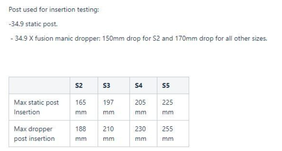

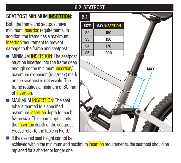

I just received something very interesting from @Specialized Rider Care. They claim that the maximum seatpost insertion depth in the Kenevo SL user manual is wrong and nowhere near the actual insertion depth.
This is from the manual:
and this was from Specialized Rider Care:
The max insertion for an s3 is 210 according to this chart.
The important info will be the "Max static insertion" as this is the depth the actual post diameter can go (ream depth). The second row is measured with a X Fusion Manic post, however all droppers have different length actuators on bottom.
If this is true, it's possible to fit a much longer dropper post than the manual would have you believe. I was a bit skeptical and double checked with them but they confirmed. That would be good news and it might explain why the Enduro and KSL have such different numbers in the manual even though they have very similar seat tubes.

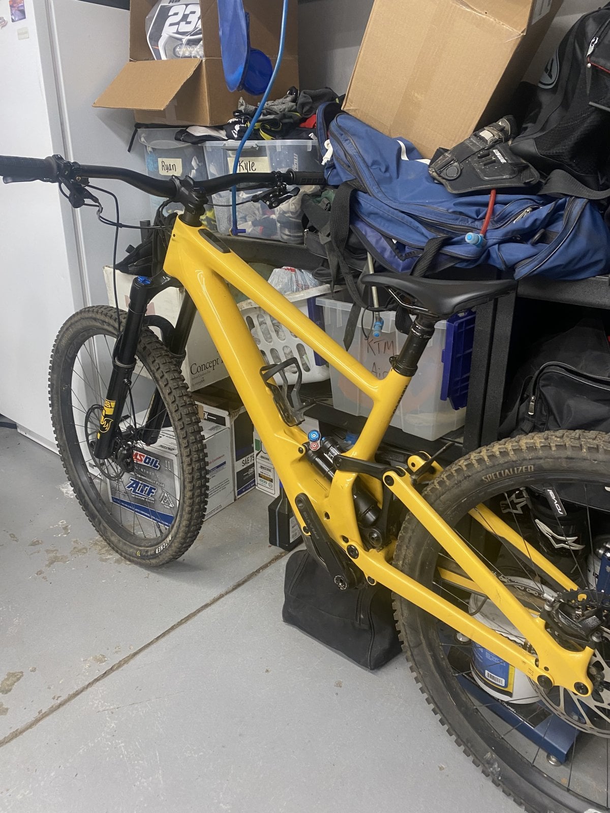

Haven’t been following this thread, but just picked up a lightly used Kenevo SL s4 Expert build. Don’t love the yellow at initial impression, but maybe it will grow in me. Also plan to swap out the wheels, brakes, and cockpit before I take this bad boy out for a test ride. (Ignore the mess in the background, Lol).
