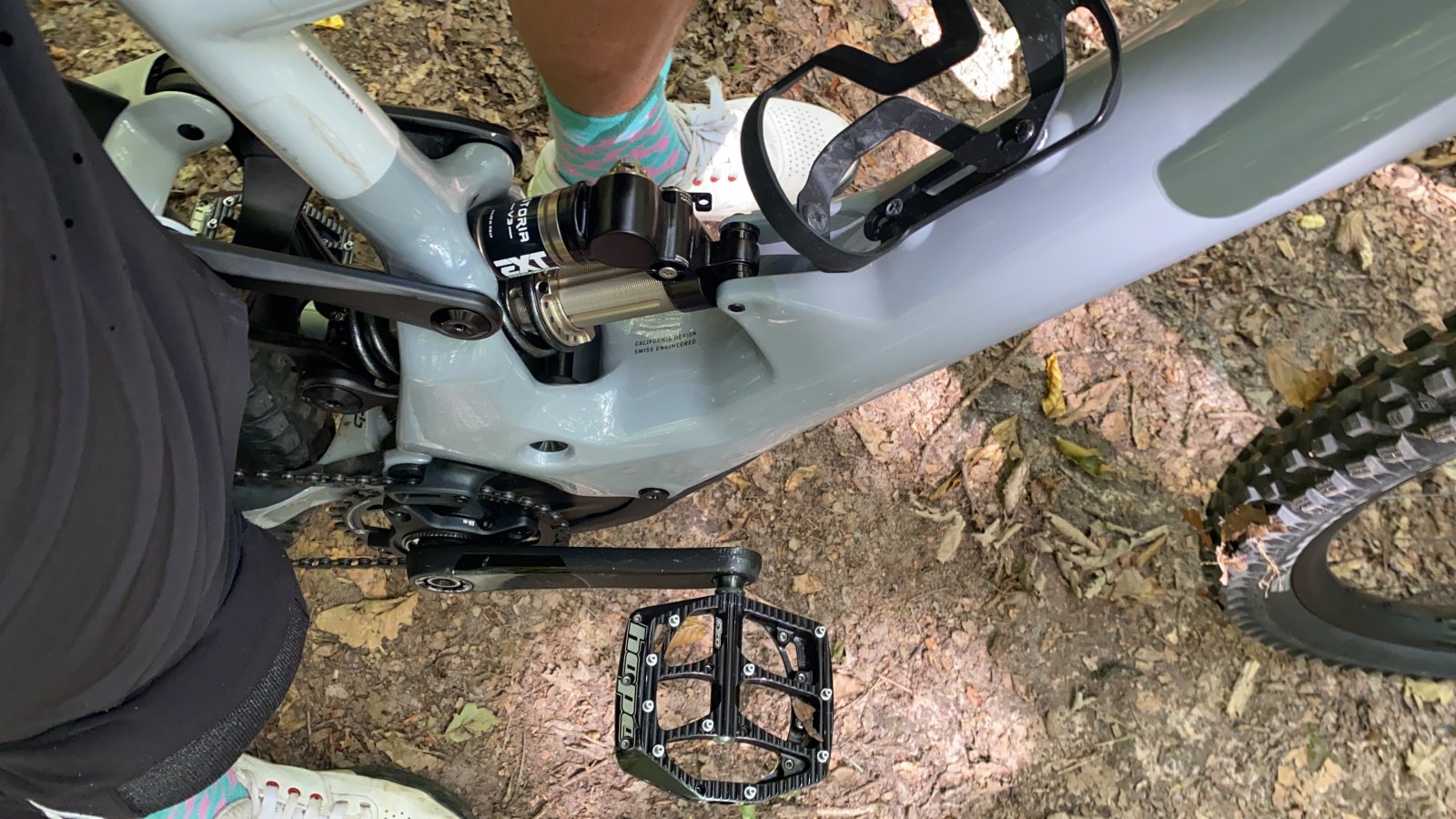

So I've got to ask, is anyone else on the preorder list for the EXT e-STORIA?
I'll admit, I'm a huge fan of AVALANCHE and worked with him a lot over the years (very stoked with the AVA-Bomber CR on my Gen2 Kenevo) but I'm anxious to see what EXT does for me and my riding style. This Fox X2 has to go, not going to work for me at all.
bepcav82
Aug 8, 2021
23
42
Italy
I had EXT on my previous bike, simply the top for me...
Now I am waiting for the KSL and I have ordered EXT e-storia, the new model optimized for e-bikes.
I'll let you know how it goes. But I'm sure it works perfectly.
In the attached photo I made a photo montage with ext e-storia mounted... the look is good :love:

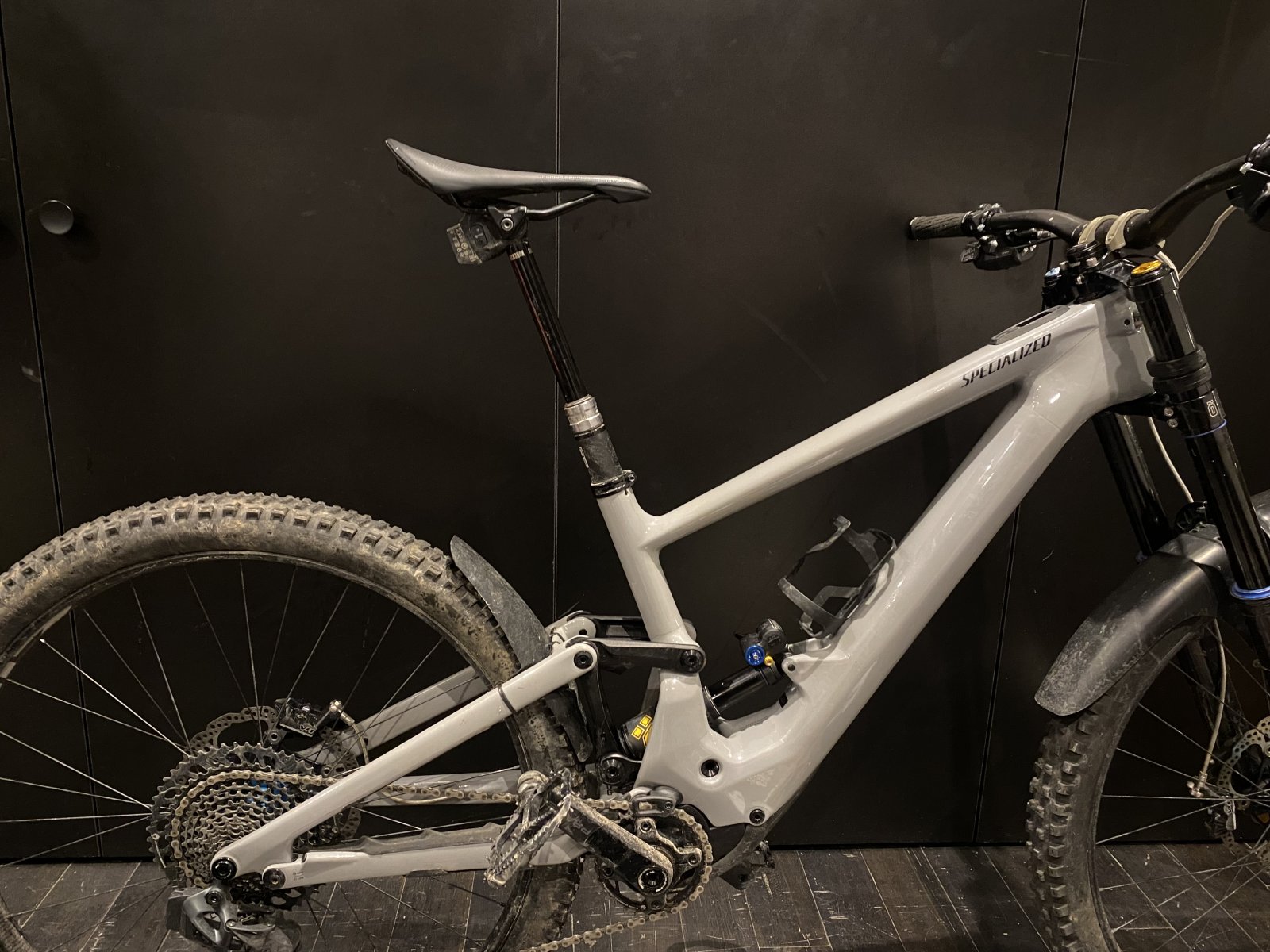

what is the max insertion depth on the S3 seat tube? I have an AXS 170mm dropper and I'm wondering if it will slam all the way down?
AdmChr
Nov 21, 2019
155
856
SWPA
It will not. I haven't measured, but I'm guessing it's about 190mm max insertion depth. My AXS 150mm fully inserted still has about 35mm to the collar. You'll have at least 55mm before the collar.
CjP
PRIME TIME
Jan 1, 2019
1,671
2,394
Everywhere
Spot on 58mm to the collar and I’ve lifted the post up a tad from touching the seat tube. At 5’10 it juuuuuust works for me. On climbs I have it fully extended. Cruising about 10mm down.
Dave_B
Aug 29, 2020
1,470
1,601
Newquay
thanks, with 170mm post, does the saddle feel completely out of the way when dropped?
The Storia is a great shock, I have one on my Enduro. I’d say you really don’t need the eStoria. There’s no yoke etc to compound the forces through the shaft as in the Levo. Storia would be more than fine, shaft is 14mm diameter, quite a bit more than any of the competition I’ve seen.
AdmChr
Nov 21, 2019
155
856
SWPA
I'm 275lbs of 100% pure beefcake :LOL: that gets rowdy... there will be some forces alright, and I'll take all the help I can get!
bepcav82
Aug 8, 2021
23
42
Italy
It's good news that EXT story fits!
Unfortunately in my case I have to buy it new. For the small price difference I prefer to buy e-storia because it is optimized for e-bikes.
