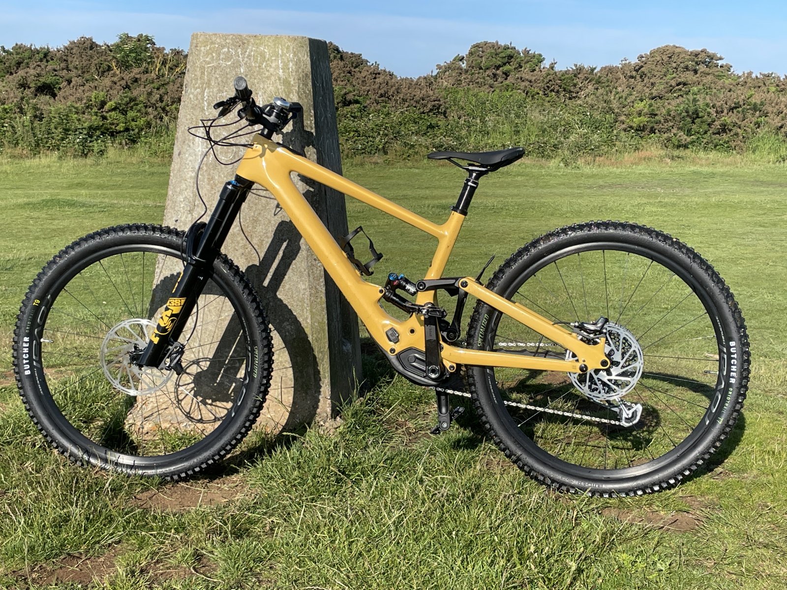

Finally got it (or I got enough money raised) size S3
This model has such a good parts and maybe the 1st time I have no hurry to change anything. Later maybe the seat post and tyres.
Can't get seat post low enough.
And oh' boy how it rides, so smooth and silence.
And it assist just right and you have to use your own legs.
The fork Fox 38. When you test it in the parking lot, it feels hard but as the speed increases and terrain get more technical , it just gets better. So smooth as also the rear X2. What a great suspension.

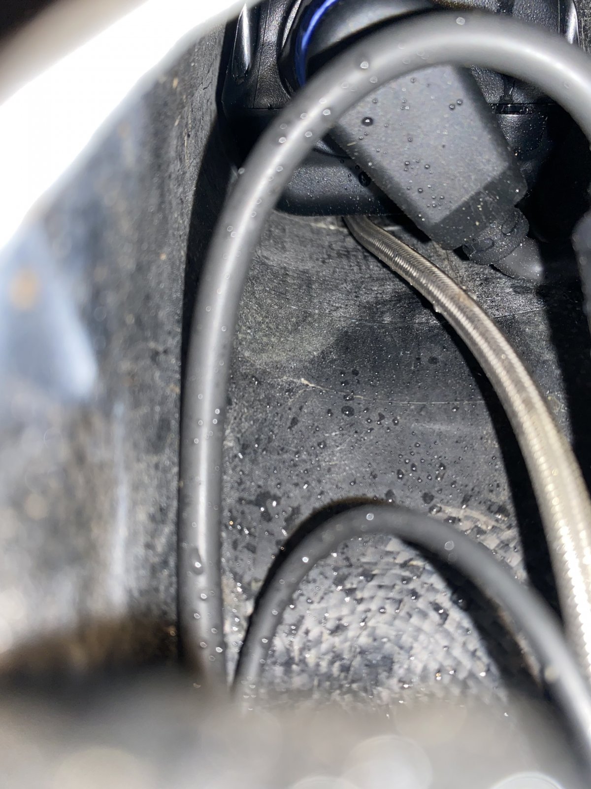

Hi, I'm looking for a picture, which is showing the way the rear brake hose has to run thru the frame.
Can anybody check inside his frame and snap a few photos?
Thanks!
Thanks!
If you look carefully you can just see the start of the “sleeve” that the cables run through. It’s part of the carbon frame and is the thickness of the cables in height and about 3 cables wide. I had the motor out when I done mine but if you remove the motor cover which is easy as you can probably re thread it all through there.
This bike has been designed perfectly.
Thank You Christian!
On which side of the motor did you run the brake hose over the motor/gearbox, on the drive side or non-drive side?

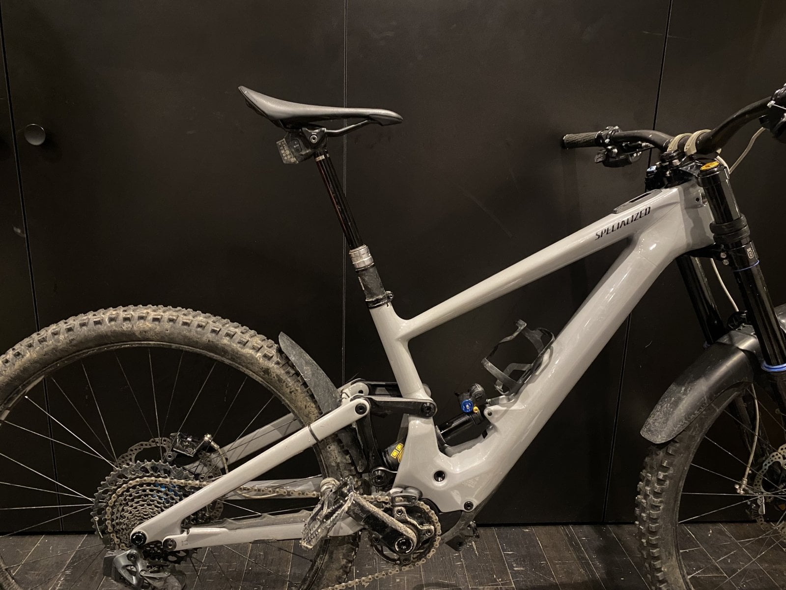

My 160mm Praxis carbon cranks turned up (alloy 470gms carbon 359gms for info) and I felt no difference at all riding the bike vs the 170mm cranks that come on the bike.
ebikerider
Oct 1, 2019
706
484
Well, at least it's a tad bit lighter now. (y)
Less chance of pedal strikes was the goal. Will now experiment with the adjustable geo. Head angle changed from the steep to the neutral setting with flip chip in high. Front centre just grew about 9mm (1290mm) and reach reduced by xx (I didn't measure it:geek:)
