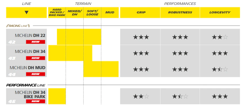

The Michelin tyres are great. The DH22 front is tenacious!
Better than the stock K-SL tires? I think the stock tires grip well, but a little flat in the profile, so they don't roll over as good as I want.
Definitely better than the Specialized Butchers. (Don’t get me wrong, these new / revised Specialized tires are pretty darn good).
The Michelin DH tires are for : set and forget / don’t bother with inserts / grip is never an issue / no worries with slower rolling / who cares about battery life / AssagWho?
…but seriously, if you have rowdy local terrain - really worth a try.
Cool. Good to know. All I know is Maxxis tires and thus far have been pretty impressed with the Specialized tread having zero knowledge of them. I do like the Yellow sidewalls on the Michelin's. I've never run inserts - ever. :)

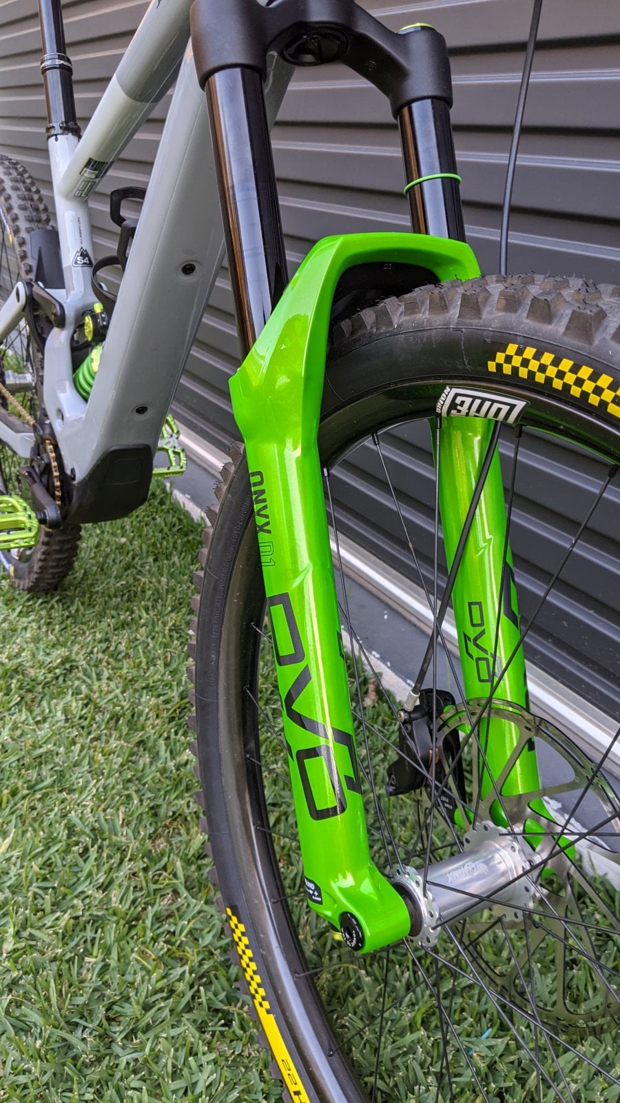

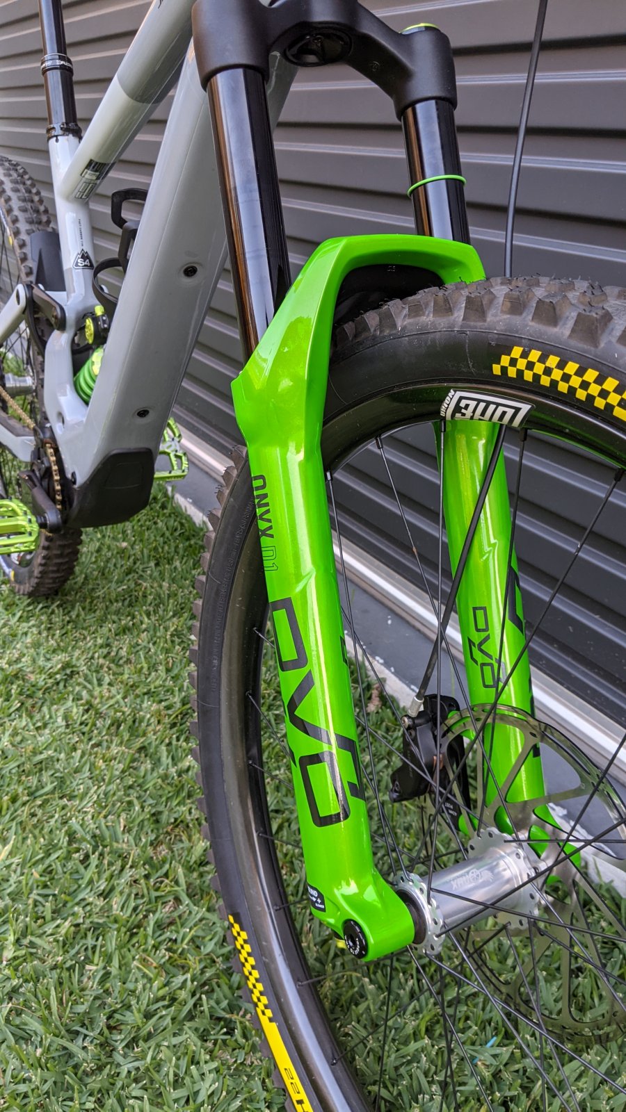

Got out for a few rides on the KSL, loving the bike!
In short the DVO Onyx fork is one of the easiest to set up and a fork that I have really come to love in a short period of time. I got the Onyx from DVO NZ, wasn't available anywhere else, and what a great job he as done setting this up.
First impressions were that it felt like the ERA. The way it held up with very stout mid stroke support was impressive. Initially I ran it with plenty of pressure and zero damping to get a feel, then dropped the pressure and added HSC to keep me from bottoming on the bigger hits and quickly found a sweet spot. The fork is really active and is super supple and very relaxed over small chatter. The Mezzer over this terrain I found fatiguing after a while as it needed the rider to be somewhat going for it to work well. Braking heavily on the steeps the stiffness seems to be spot on, with no binding or added friction when loaded, just active, smooth and controlled movement.
The biggest compliment I can give this fork is that on my last ride I didn't think about the fork once. This is super rare for me as something usually gets my attention and I start thinking about the cause and solution. This Onyx and my Hayes Dominion brakes are set and forget
Compared to the 38 the Onyx is possibly even slightly more supple on the small stuff, stiffness feels very similar, weight is also very similar (Onyx was 2.3kg with uncut steerer). Onyx held up better in its mid stroke than the 38. The Onyx feels like it recovers quicker than the 38 and so feels calmer going hot into corners with a heap of chatter. The front end grip from the fork tracking so well, not deflecting adds a heap of confidence. I'm having to recalibrate when I need to get my inside foot out in anticipation of a drift because the front is hanging on better (same tyre and pressure just a change of fork). I'm playing with pressures and adding more HSC and so far I've felt no harshness at all. No hand pain on longer runs even with the added damping. So far all is looking good!
Not all doom and gloom for the 38 though. In fact I did a complete 180 on that (I was going to sell it). Decided to keep the 38, Smashpot it and put it on my other bike:D

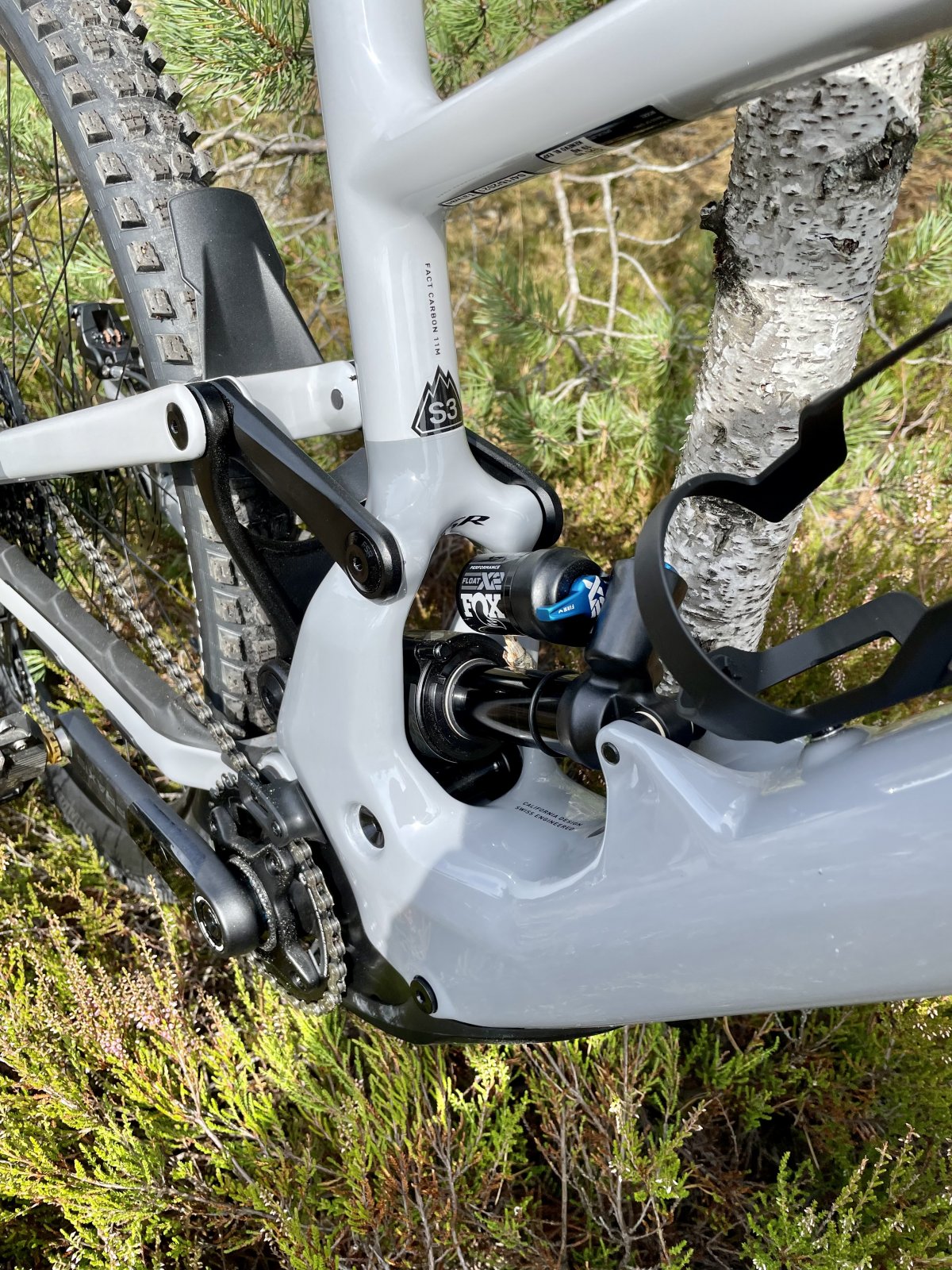

I got a bunch more ride time on the RockShox SD Ultimate Coil.
I really prefer it to the Float X2, and here’s why:
Bigger impacts are handled and soaked right up - just a smoother ramp to the end stroke.
I don’t feel that I’ve lost any “pop” when needed on trail. The MRP progressive coil is likely a big help here. (550+)
Sensitivity off the top. Of course.
Better high speed composure. Especially when it gets really rough.
Simple setup. Progressive spring with SAG set to 30% - no or very little compression needed and then set rebound to flavour.
Some critiques:
I haven’t needed to lock out the shock on climbs yet but I’ve thought about flipping the switch.
On pedally roots / rock littered slow trails, this 170mm bike, especially with the coil can get bogged down - wasn’t so bad with the air shock, from what I remember.
Some critiques:

on the slow , janky trails you think it just gives up trail to easily? I wonder if the progressive spring influences rebound settings that are needed. Does it have lsr and hsr adjustments?
I’m pedalling through the compressions and I think because the coil shock is so supple I feel that I need to spend more energy and effort to maintain any speed.
As soon as the speed picks up, the bike feels amazing.
The shock has no HSR tuning (done when the shock is setup for rider / bike)
Your thought on how rebound works with a progressive coil is a good one.
I’m sure it’s not set to handle the range of progression.
Given how progressive springs work… it kinda makes sense. More of the energy is stored later in the spring stroke vs a linear assuming same sag point. Meaning you probably use a bit more in those scenarios. Also probably why tuning rebound could be a bit more complicated . I ran a progressive spring on my 1st gen Kenevo . I think I found similar to you, but I was under sprung with the progressive so it was exacerbated I believe
maybe try adding a bit of lsc to see if that helps? Might negate a bit of the suppleness, but could be worth a shot.

have you measured sag? If so, how did it compare to when you had the x2?
Very similar.
Sag @ 230psi in the X2 gave approx 49mm of wheel sag. 240psi gave a few mm less and didn't give much more mid support but did become choppy at the higher pressure.
One turn of preload gave approx 48mm of wheel sag. All figures are approximate and could be slightly variable but it's in the ball park (the people I used to help measure may have built in parallax error lol).

Very similar.
Did you go with the 230x65mm version or did they shim it to 62.5mm? Custom tune?

Nice report! So, you have had a Mezzer and the ERA as well?? Assuming those weren't on the KSL at any point..
DVO has always piqued my interest, especially since they are fairly local. Good to hear it's a solid performer. Your report also further makes me think that the DSD Runt or the Secus could be a big performance boost for the mid stroke on the 38.
Now... how about that coil?!? That's the real item of interest at least to me :)

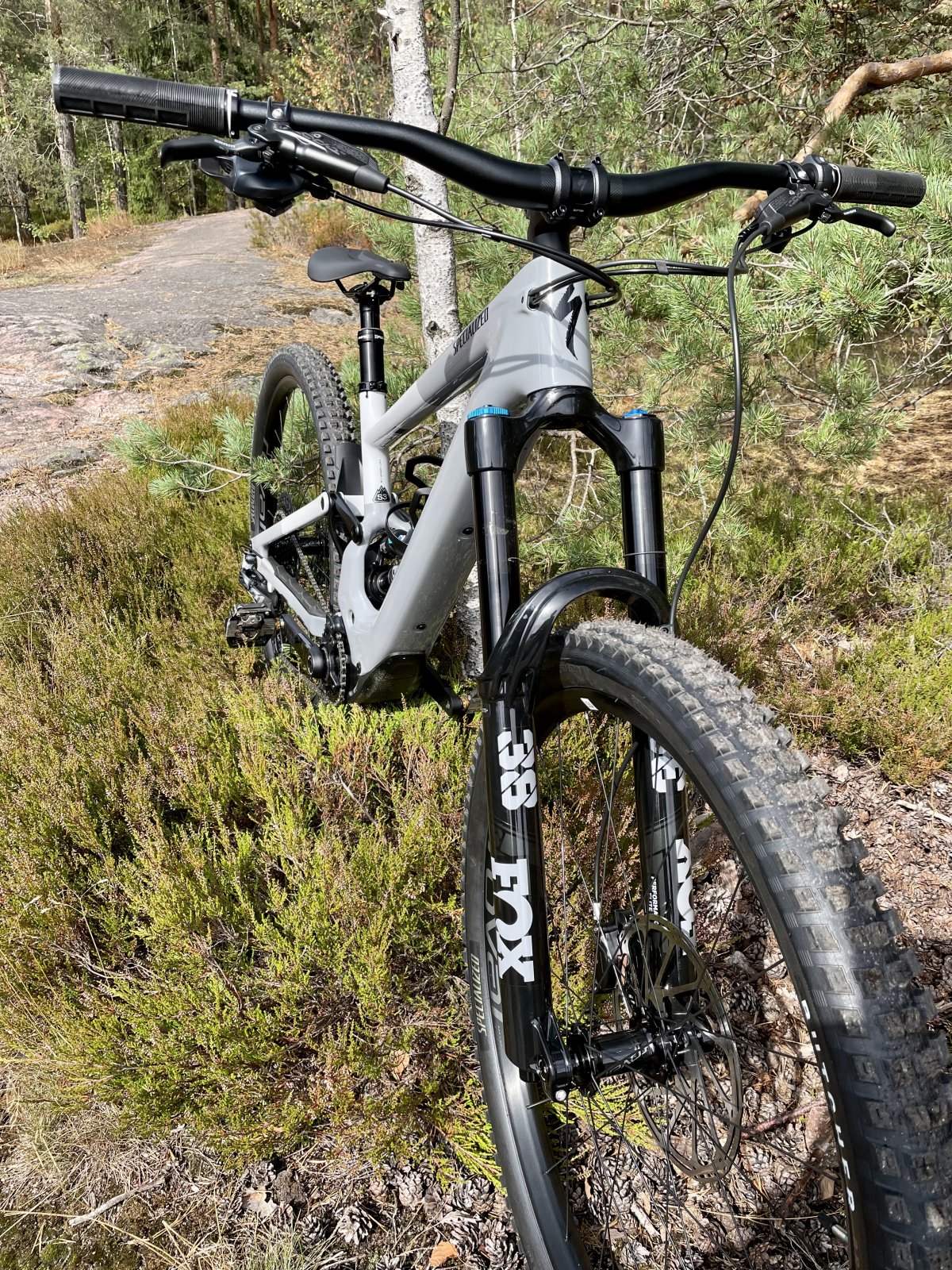

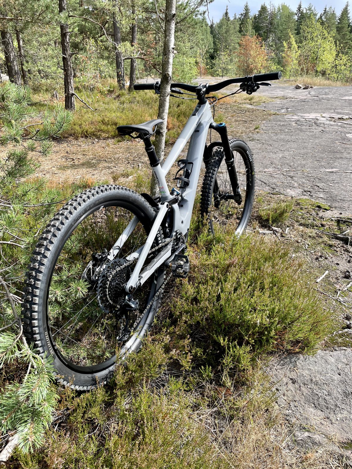

Finally got it (or I got enough money raised) size S3
This model has such a good parts and maybe the 1st time I have no hurry to change anything. Later maybe the seat post and tyres.
Can't get seat post low enough.
And oh' boy how it rides, so smooth and silence.
And it assist just right and you have to use your own legs.
The fork Fox 38. When you test it in the parking lot, it feels hard but as the speed increases and terrain get more technical , it just gets better. So smooth as also the rear X2. What a great suspension.
