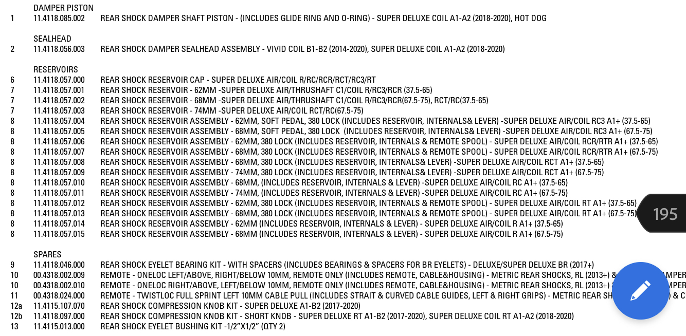

Can anyone advise me which coil shox can be mounted on the kenevo sl? I already own the rockshox but I have read that it hits the frame and it doesn't fit…
Thank you!

Doesn't the Rockshox fit if you get the reservoir swapped to the smaller one? DVO Jade X fits too.
Push 11.6 coming.

On page 195 of the RS parts catalog (linked above by @ebikerider (thanks) - you will see the part number for different size reservoirs.
My shop installed the 62mm reservoir.
Loving it!
I have yet to try the stock 550 linear spring, but the MRP progressive 550+ spring is great so far.

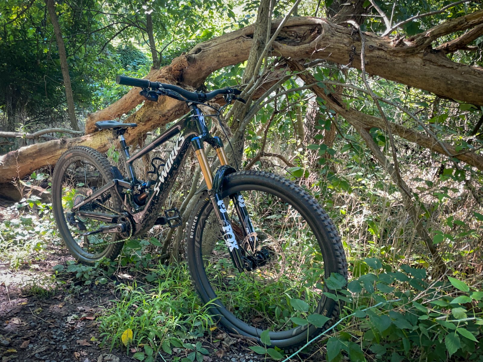

Finally got it out for a shakedown ride. Still have some tuning to do.
(Frick Park - Pittsburgh, PA)
Man, do like the blacked-out look of the S-Works. All I need is some carbon wheels and I'll have an equivalent S-Works...oh, not to mentioned, AXS and a higher end cassette. ;)
On a side note, I'm completely impressed with the Butchers. Stick like glue! A pleasant surprise.
After yesterday's ride, that's the first thing I thought of... order new tires as soon as I get home. I wanted to like them, figured I'd give them a chance with the new rubber compounds, but the first corner I leaned the bike into they washed out (front and rear) and I almost went down lol. The rest of the ride I was sketched out from it, so I dialed it back, and they still slid on out on roots. Granted I still have the tubes in them but still running my normal air pressures, so maybe I should set them up tubeless and give them another go.
interesting that we are getting polar opposite results. I'm running tubeless, but hard to say how much difference this will make. I've been running 24/24 PSI - frt/rear. I've run Maxxis for years and the Butchers seem to grab better, but I've only run Maxxis on analog bikes.
