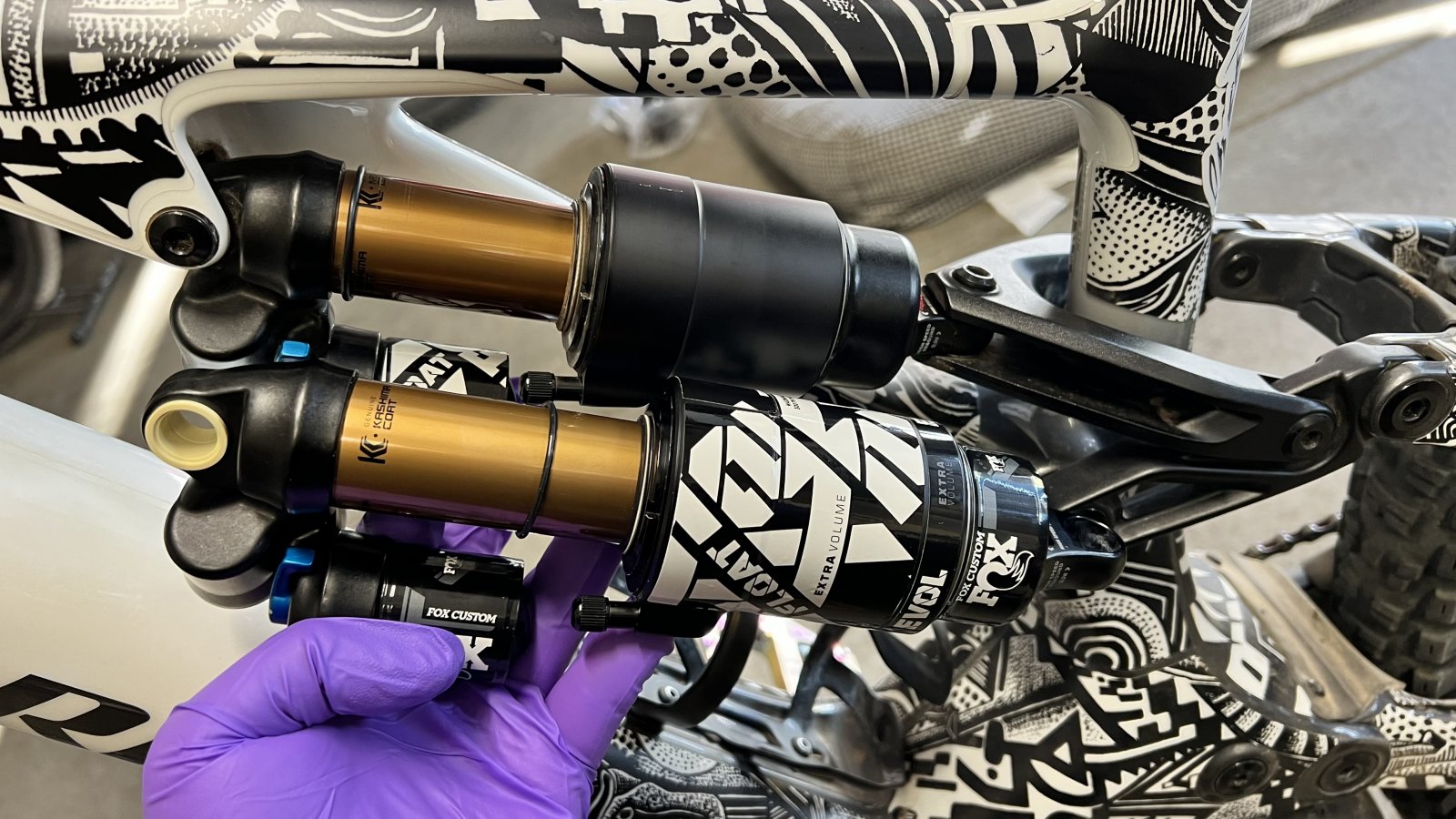

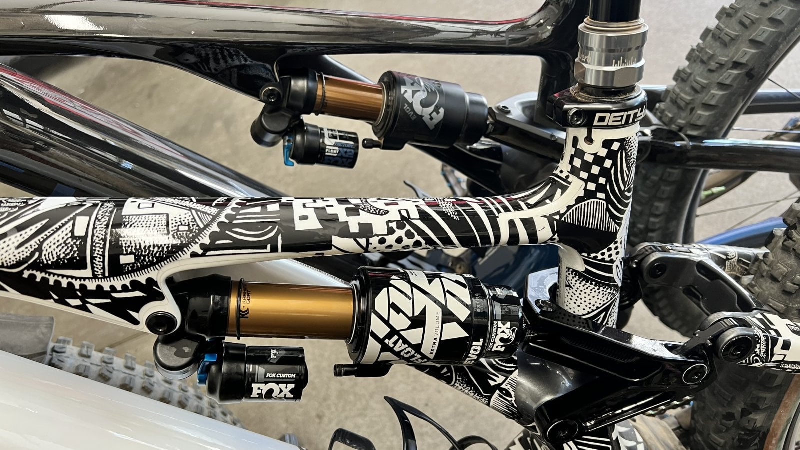

Bye bye 210x55
say hello to 230x65

Is the 200lb limit on the linkage? And where is that info from? I know the frame limit is 240 lbs.

Uh oh….well i’m 230lbs geared up……oh well
I believe what he means is if you choose the cascade link and stock shock size configuration, then there is a 200lbs limit. The extra travel makes you bump up the air pressure or spring size too much to stop bottoming out.
You did it the right way with the 230mm shock and link! Can’t wait to hear a ride report!

Yeah
That longer link sounds like the way to go.
Genuinely interested to know how it rides.

It makes the rear have the right amount of plush. Made sense for my bike since I upgraded the fork. The front suspension felt real good which made what the rear was lacking more obvious. So now i feel the front and rear suspension performance is balanced out

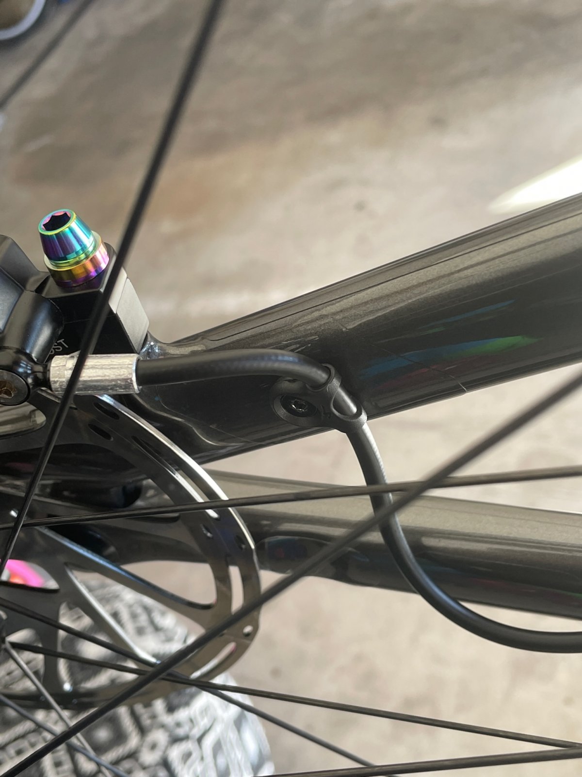

Anyone know the part number and/or proper name for the small nylon clip on the seatstay used to keep the rear brake hose clear of the spokes? It's missing from my build kit and doesn't seem to show up in the small parts schematics except in photos.
Edit: Turns out to be part number S206500009.

My Gen3 Expert was also missing this when delivered. I worked with Specialized Rider Care and they did ship me a generic brake line routing clip that would work, but it was a little different than the one pictured. I visited the Specialized store and confirmed it was present on a Gen3 Levo S-Works build and pointed it out. The shop found one gave it to me. Never did find a part number.
The consensus from Specialized Rider Care and the Specialized store is that most Gen3 Levo's were being delivered without this brake line routing clip. If you have a Specialized store or dealer near...pay them a visit and see if they have a spare. I wanted it so that the brake line did not rub the frame and wear through the paint over time.

Hello, I think any bikeshop has it, you don't need a specific product, you just need the diameter of the hole to allow you to be blocked by the screw

Agree, you can get a generic brake line routing clip at most shops. The nice part about the Specialized brake routing clip that is supposed to be on the Gen3 Levo is that it has a gap in between the two areas that hold the brake line. This allows for the arc in the brake line to remain. Very minimal feature...but on a bike at the cost of these, I expect all the parts to be present.

Yeah, local Specialized dealer doesn't have one, shame about the part number.
S146500017 is the nearest I could find
Thank you very much. Not the kind I'm looking for but it's good to have a alternative reference.
