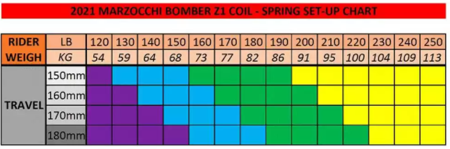

Any fellow chunkers, I'm 112kg and even at 280 psi the rear shock sag was 20mm where as the fox site said it needs to about 13mm for 25% sag. What are my options here? New shock or just suck it up?
