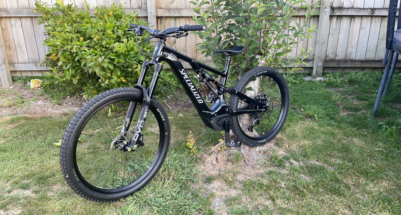

Is anyone running a DVO Topaz? I've ran one in the past and really liked it on an ibis. Not sure if there's much to gain though over the RX tuned float X. I may just hold out and upgrade to an X2 or push 11-6
Not my bike but it looks good

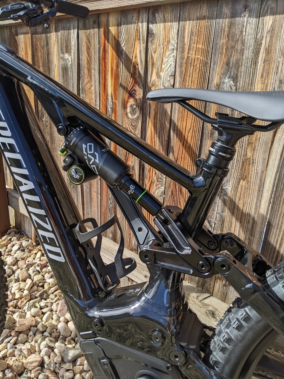

Hi, just bought the S works Frame in the blue... Has anyone out there had any success with the Cascade Components... long shock link for heavy Clydes I am 230lb or 104.7 kilos kitted up... where you can bump the rear travel up to 165mm... and/or has run a fork at 170mm or 180mm?
TURBO LEVO LONG SHOCK KIT (2022-CURRENT): Turbo Levo Long Shock Kit (2022-Current)
on my 2018 levo I had got a link from bike yoke... and it work ok until my bomber cr broke... I am using the 2022 fox dps in its place..so far so good... I don't want to break my $8500 frame...

@cbsnz & @gbarfoot
Hi, what are the reasons why you have chosen DVO?
And why not a Jade-x?
I chose DVO as I like the performance and I've had great experience with their customer service. Issue or a tech question just call and they get you sorted. I had a dvo setup with the Jade X on my Giant and really liked that shock. Only issue is it doesn't have a ton of adjustments so if you need more adjustment than it offers you need to get it tuned for you.
I already had an Onyx E fork so decided to put it on the levo and get the new Topaz.
For this bike I heard they don't recommend the Jade X, as the levo is hard on shocks. This new Topaz was designed to take the stress of yoke driven linkages like the levo so it should be a good match.
The topaz isn't even on DVOs website yet but they do have a few sizes in stock and I put in a preorder for the 230x65 when I ordered the cascade link....got lucky and both showed up within a week of each other......now I need the trails to dry out!

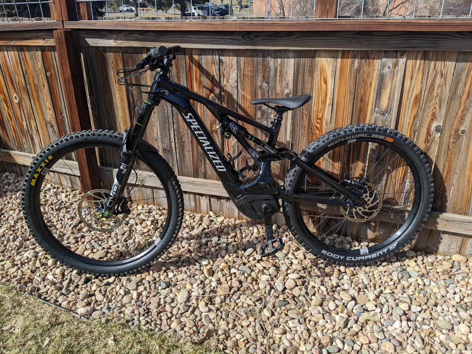

Bad news just did a full travel inspection and this new long shock link is NOT compatible with the seatstays on a S2 alloy comp....the link bottoms out in the seatstay clevis limiting full travel....I'm pretty bummed.....I will contact cascade tomorrow. I'm guessing they will need new link plates for the alloy version.
