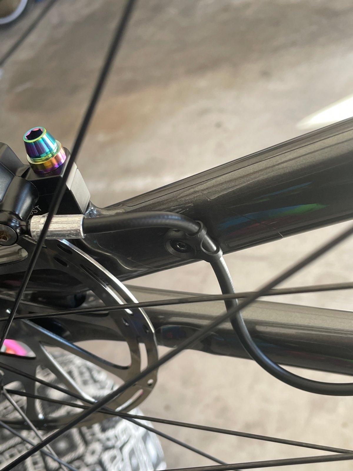

For anyone missing the brake line clamp with a 3D printer you can make on in about 10 minutes. I remixed a design for an older stumpjumper to fit the bolt that was in my 22 alloy comp's seat stay.
Contacted Specialized Rider Care and they sent me a clamp that looks very similar to the one you made.
Pointed out the missing clamp to my local Specialized dealer and they found the correct clamp for the Gen3. Said most bikes are not arriving with this clamp, but a Levo S-Works on the floor had it for reference and they had an extra one in the shop.

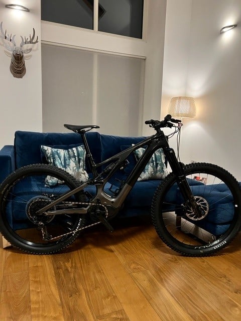

My new Expert arrived! Managed to work in a deal with Sigma Sports to honour the pre-price hike in UK, so got a deal as far as I'm concerned.
Needs pedals and the invisiframe fitted, set-up and charged and then it's out this weekend! I can also confirm no clamp. Not the best backdrop for the first pics.
Too excited, it hurts.
