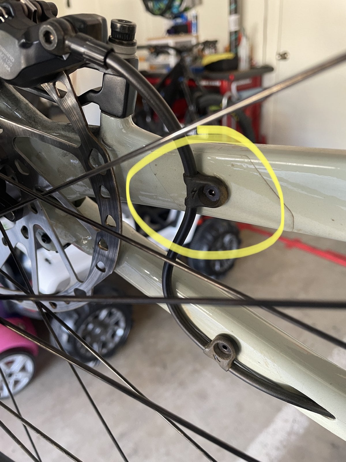

Anyone with a Gen3 Expert, Pro, or S-works have this rear upper brake line guide on their frame from the factory? I see it in the 2022 small parts schematic (see the arrow pointing to the guide), but it’s not on my expert and the rear brake line rubs against the frame. My frame has a bolt inserted, but no guide.
The photo of actual bike below is a friends 2021 Comp. You can see the brake line guide circled in yellow.
No mine doesn't have this

Just checked my 22 Expert and no bracket but does have a invisframe type sticker to stop it rubbing. Looking at the way the brake cable is it doesn’t need a clamp
