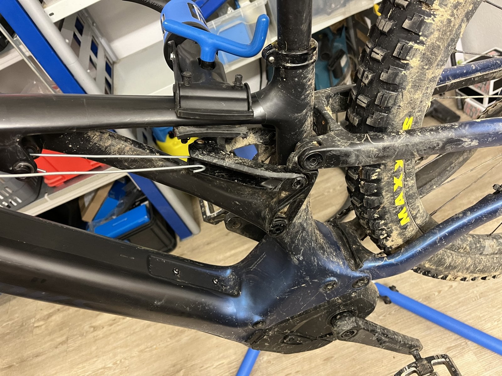

Thats should be a measurement or type error. My Levo gen3 in S3 delivers 149mm of vertical reartravel when using 55mm stroke. Measured with 2 inserted wires 210mm and 155mm mid-mid of the bolts.
Thank you for examining but please clamp the bike by the seat post (edit) and not by the carbon part 😰
