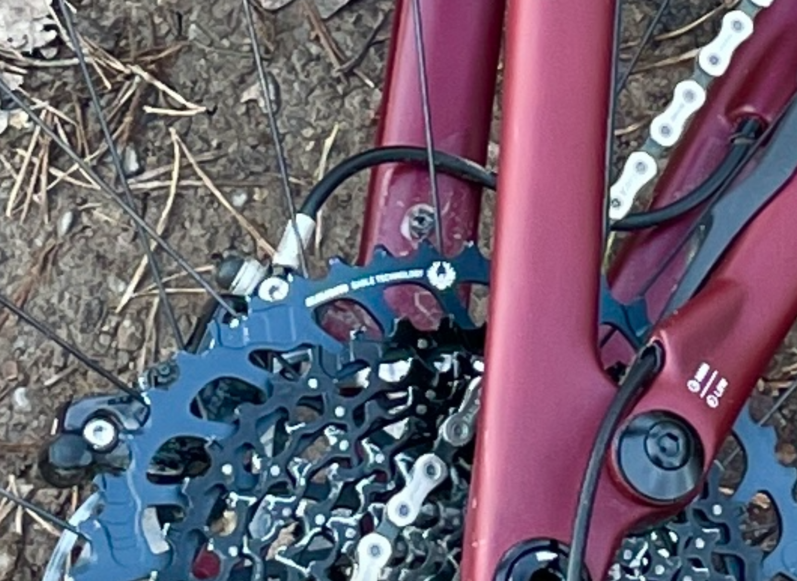

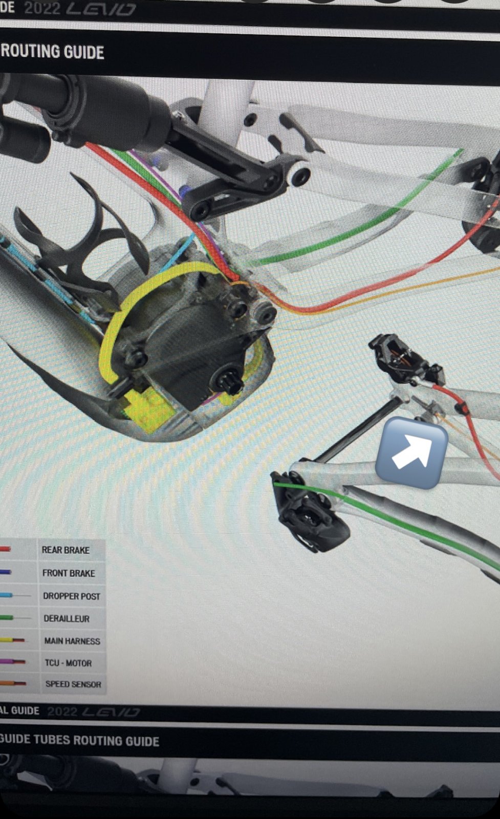

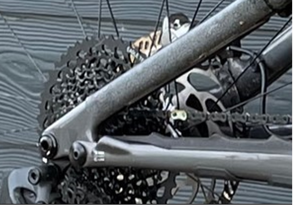

38

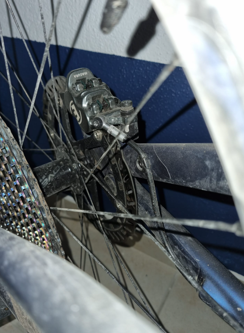

Anyone with a Gen3 Expert, Pro, or S-works have this rear upper brake line guide on their frame from the factory? I see it in the 2022 small parts schematic (see the arrow pointing to the guide), but it’s not on my expert and the rear brake line rubs against the frame. My frame has a bolt inserted, but no guide.
The photo of actual bike below is a friends 2021 Comp. You can see the brake line guide circled in yellow.
I bought an S-Works frame and it did not come with the guide. For what that frame cost I find that really disappointing.

I have it 👌

I'd guess that this guide (which was on my Gen 2, but I removed it when installing new brakes) is sometimes removed at the bike shop's discretion based upon brake calliper type and rotor size, excess cable length and frame size. The guide/clip can interfere with the cable movement and make the cable radius too tight and kink. Best not to stress too much about it and add some frame protective tape. Just make sure that the brake cable's not too loose or slapping the frame! Hate those unnecessary noises..

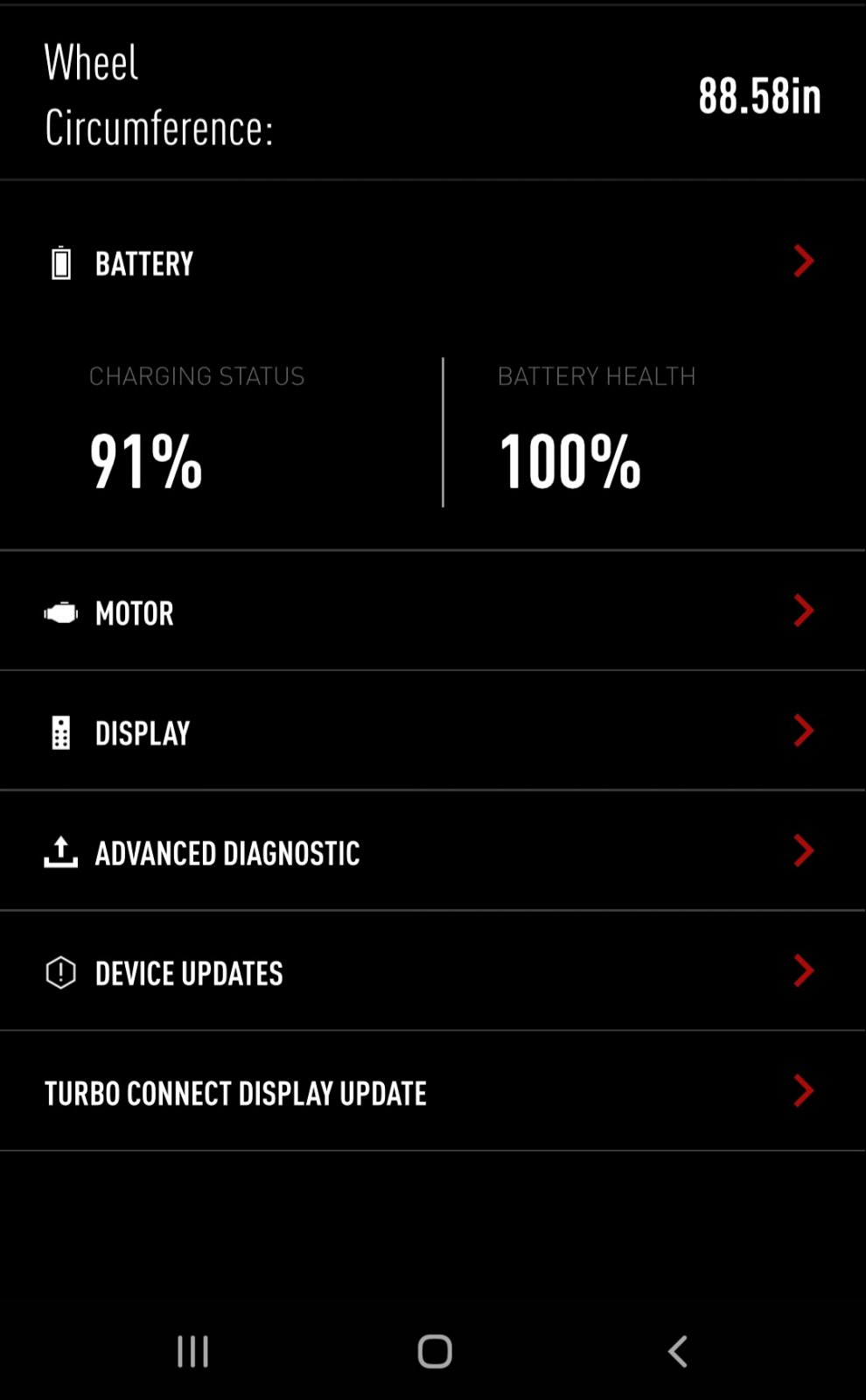

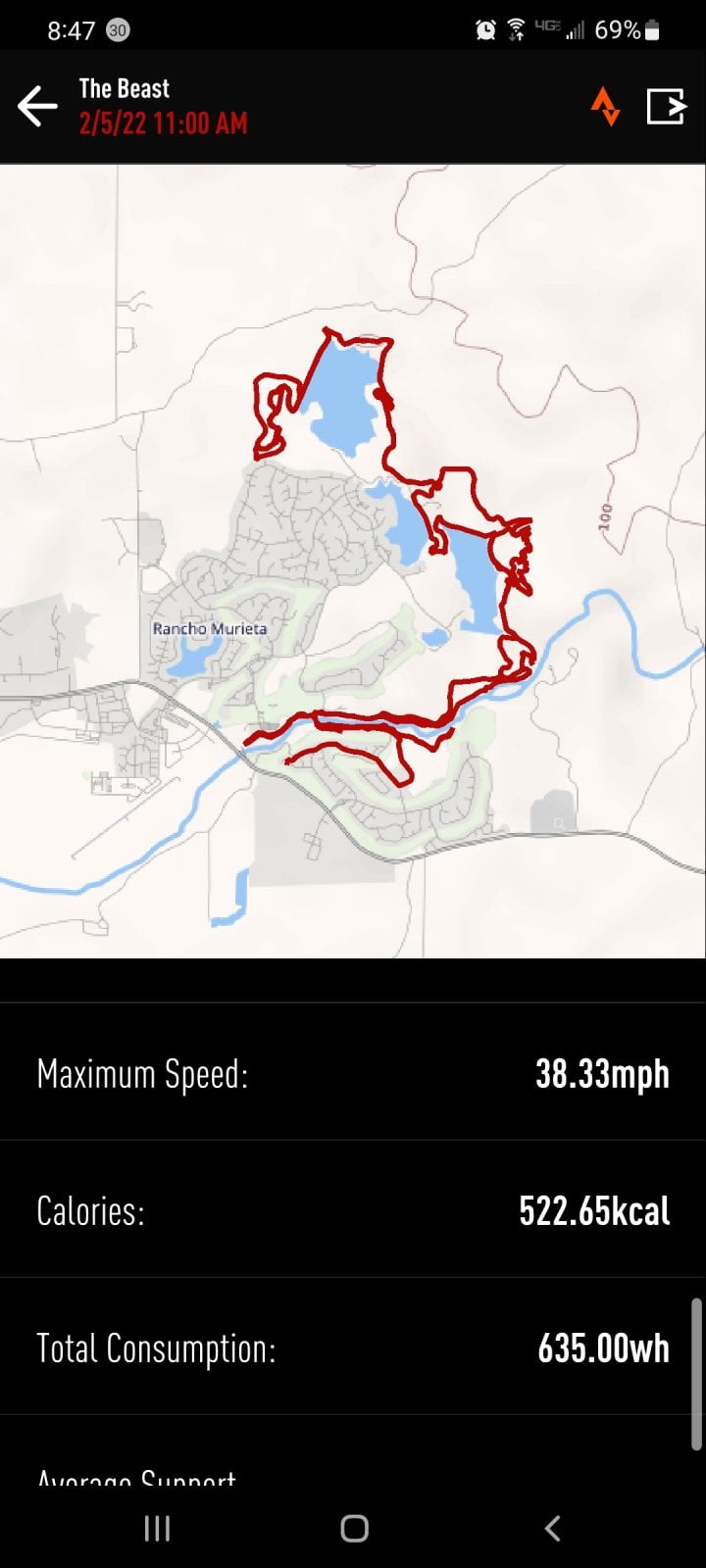

Seems like wheel circumference is off or something... As I'm almost covering twice the speed and distance on the app... comparing to the Garmin.
Can someone let me know what has worked better for them specialized app wheel circumference? Assuming I will need to take it too a shop to be adjusted.
You setup for imperial or metric speed measurements? Check in MissionControl or on the Mastermind TCU menu.

No hose guide on mine either. It doesn’t rattle and the hose runs in a nice smooth curve.
