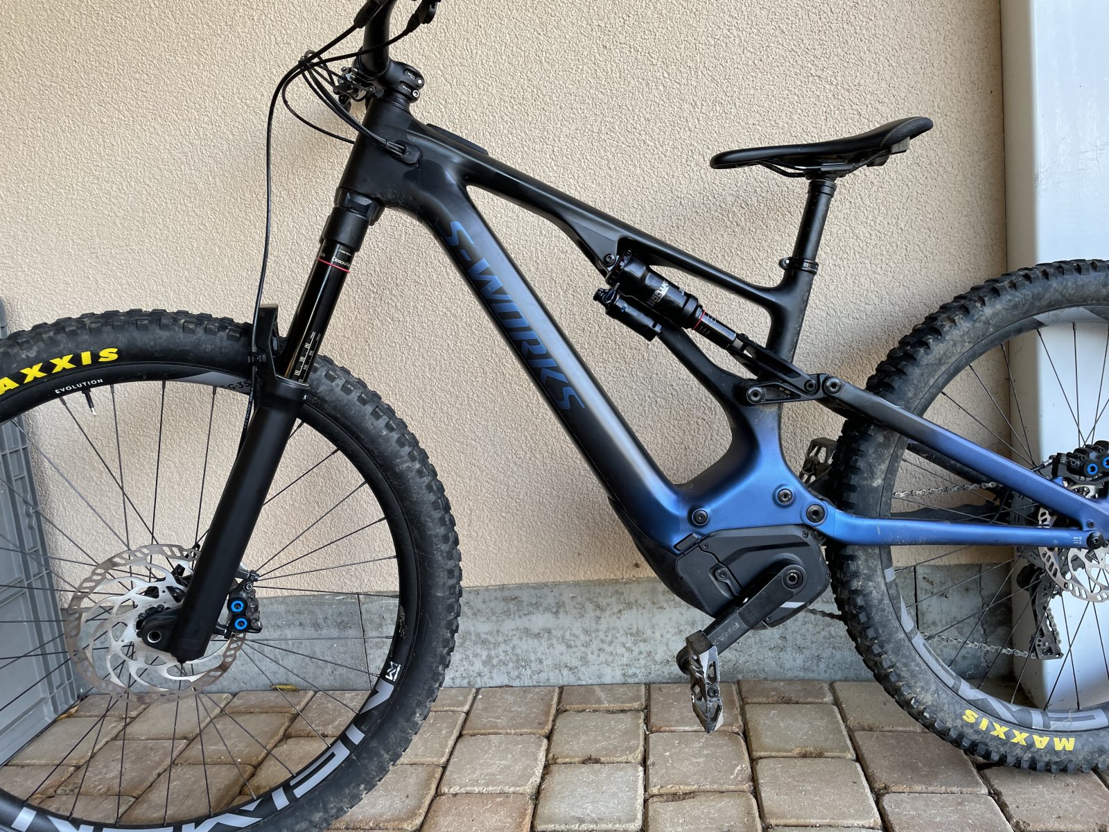

Did you buy a frame only?
but there's nearly nothing left from stock. not even the cranks were left on the frame :sneaky: But in this configuration it feels more reliable and cheap if parts wear/ get damaged. For me a Shimano 11-speed cassette with 32t steel chainring on front is enough range and is cheap enough when changing it twice a year.

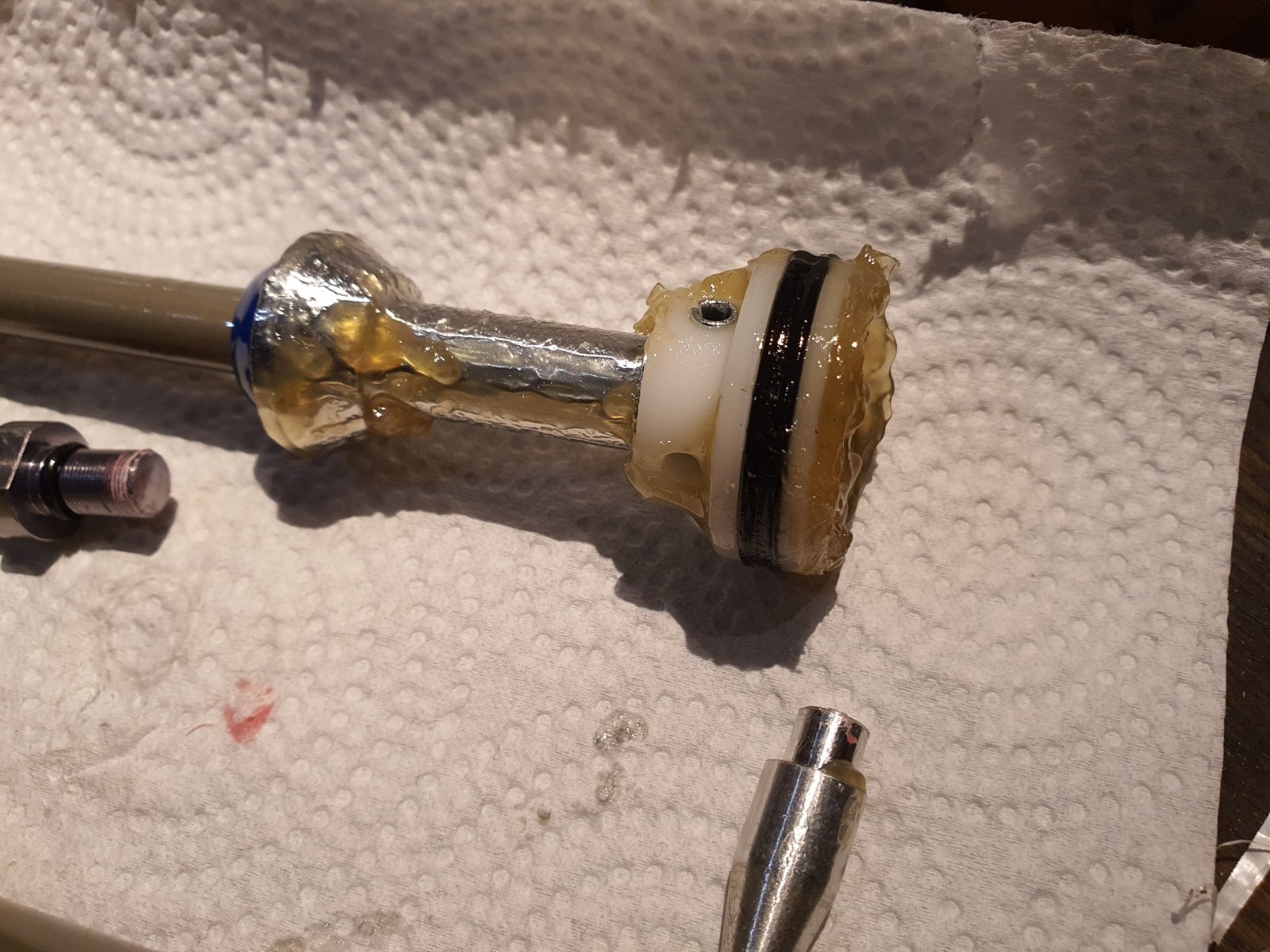

After my X2 was blown and another X2 has the same sideplay feelable on the air seal when flexing the backwheel i tried a Super deluxe. First ride was promising, little bit less small bump plushness. but i will retune from
low reb/comp to Med tunes and update with the Megneg Aircan. The damper seems to be mechanically much more stable without any visible bushing play atside loads compared to the X2.
I hope to reach the same damping performance as the X2 with a better robustness. This shock costs half the price of X2 and reduces weight by 250gr.
--> I will report after the first rides with the Megeneg Can and Med tune with my experience...

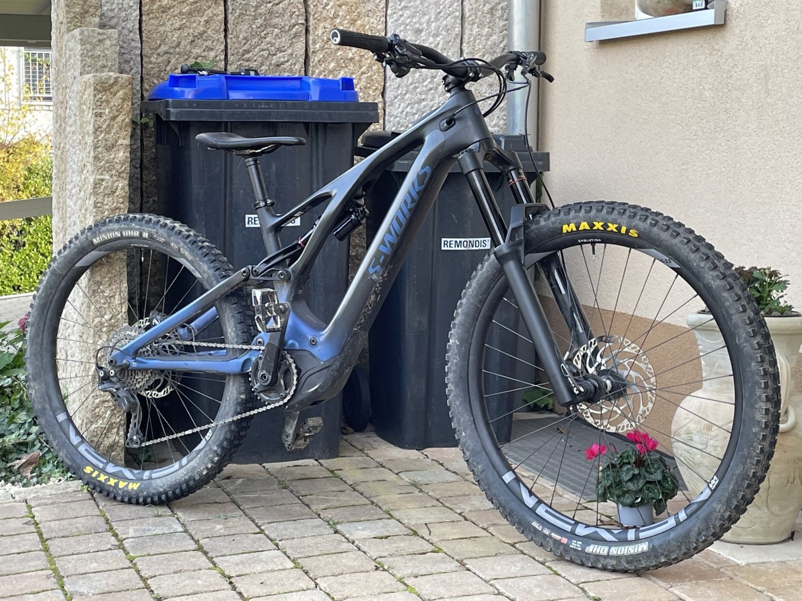

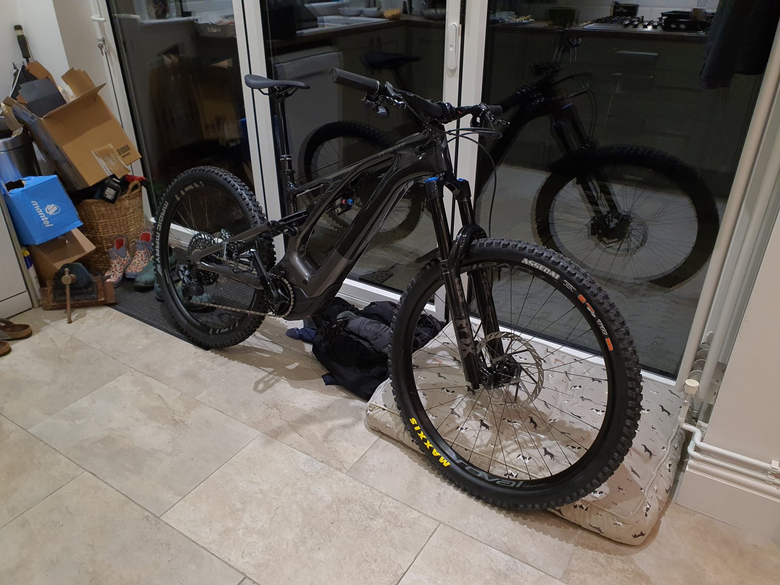

Here my robust economy build. 21.2Kg w/500Wh battery w/o Pedals:

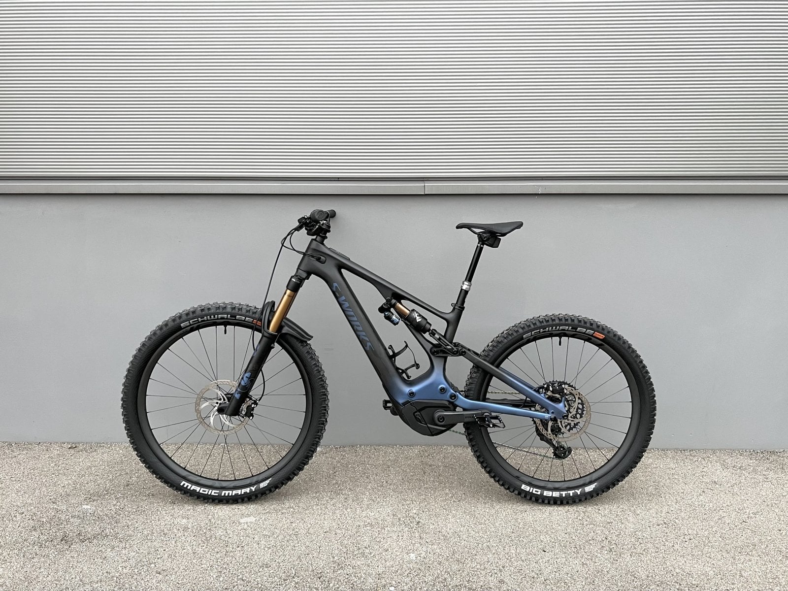

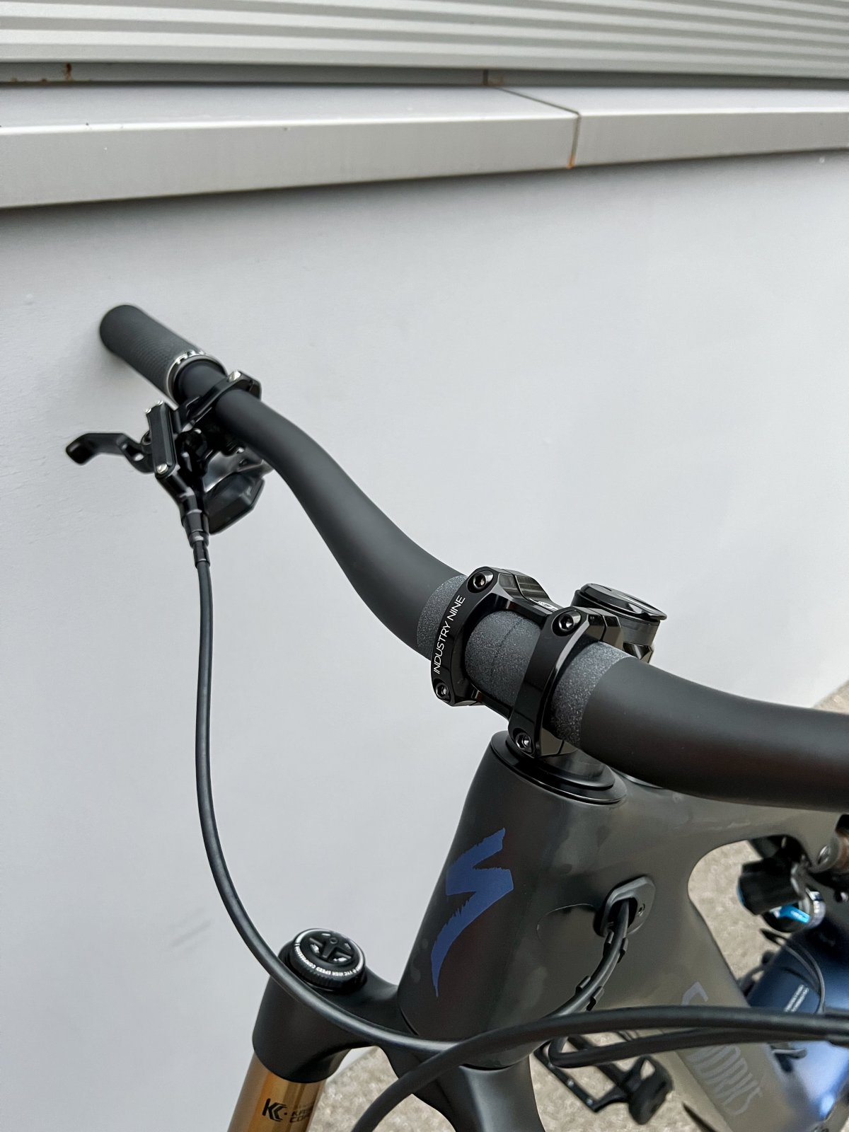

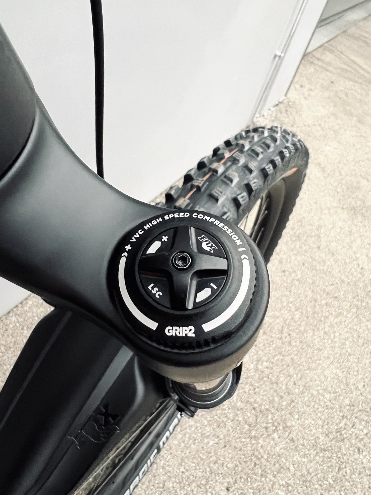

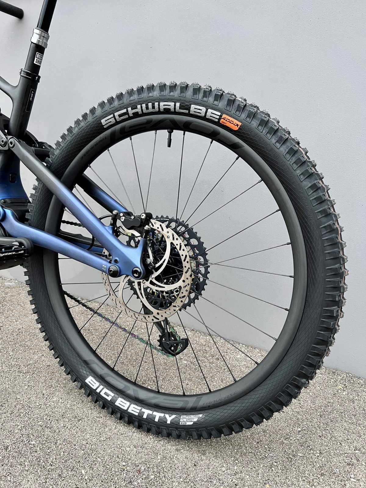

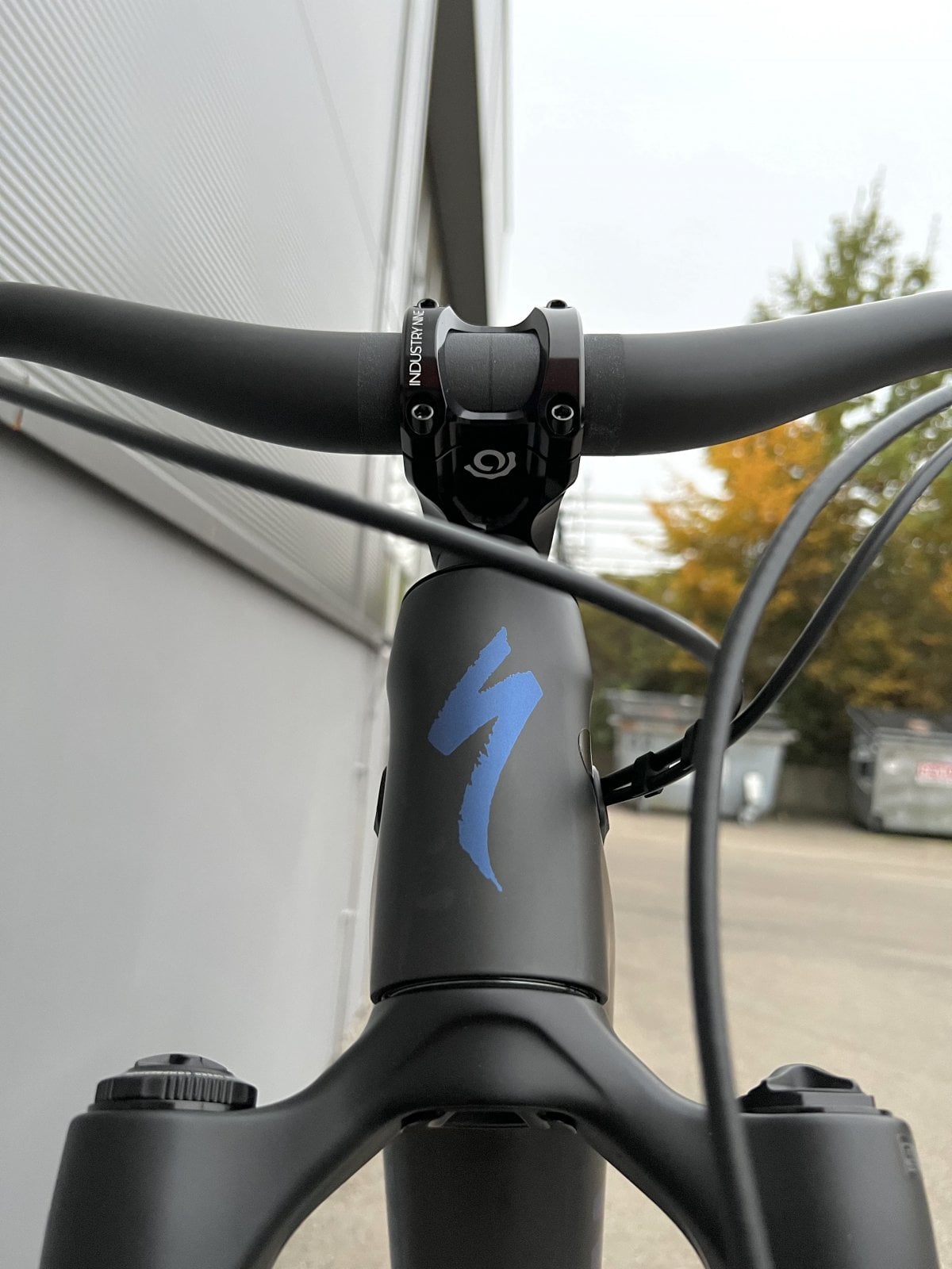

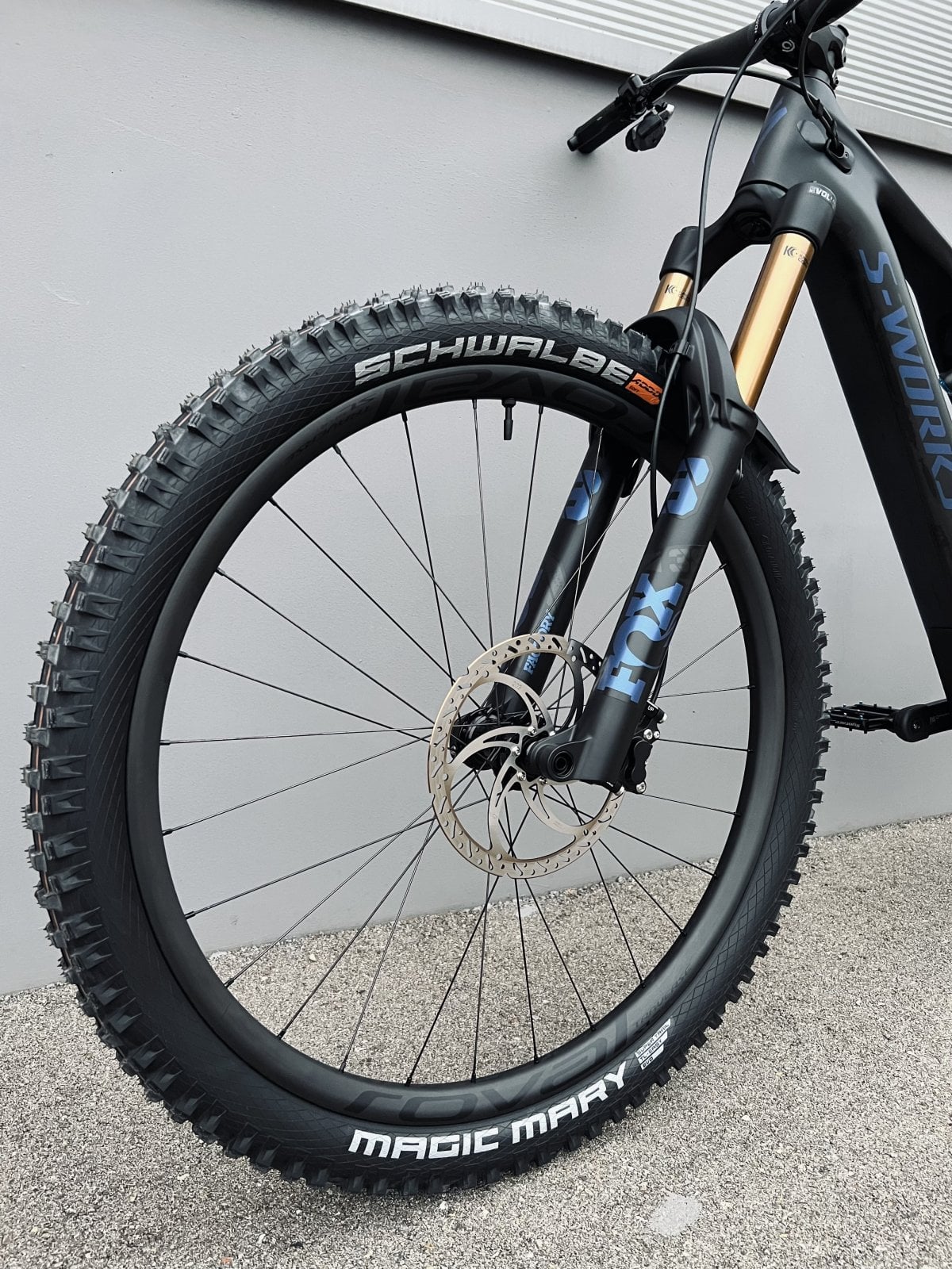

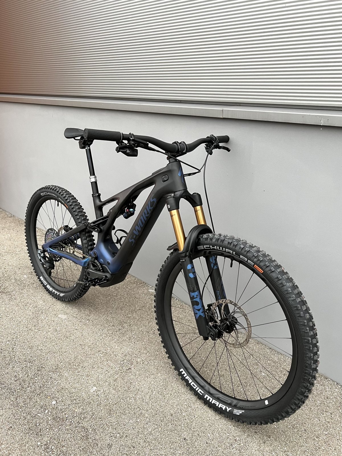

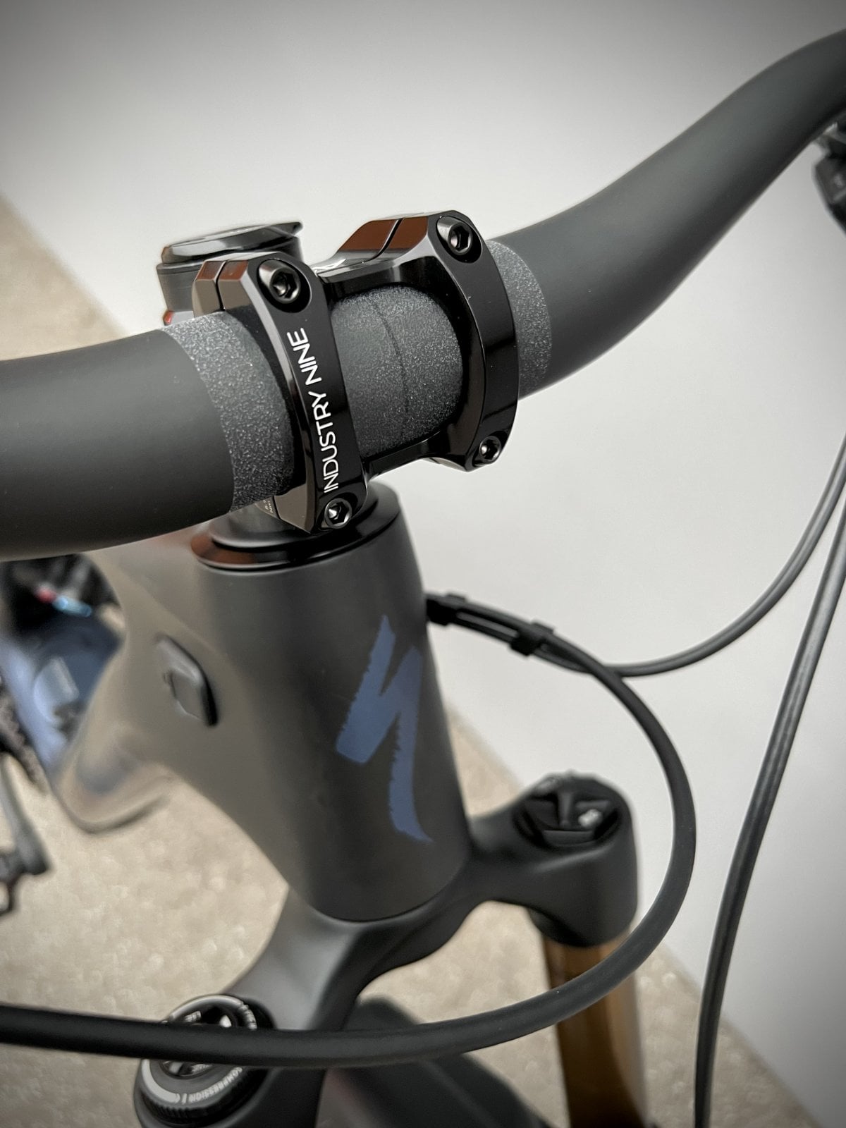

This week there were a few small updates...
- new tires - Magic Mary 29x2.6 and Big Betty 27.5x2.6, both in Super Trail & Addix Soft
- Roval Traverse SL wheelset
- Industrie Nine A35 stem with black titanium screws
- Top Cap and Grip2 Adjuster in Black
- Trickstuff Direttissima Stealth Limited Edition
Have a nice weekend while biking! 👍

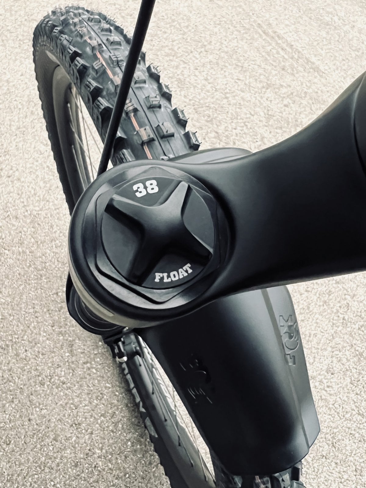

Looking great there mate. where did you source the limited edition black fox compression dials and air cap….?
