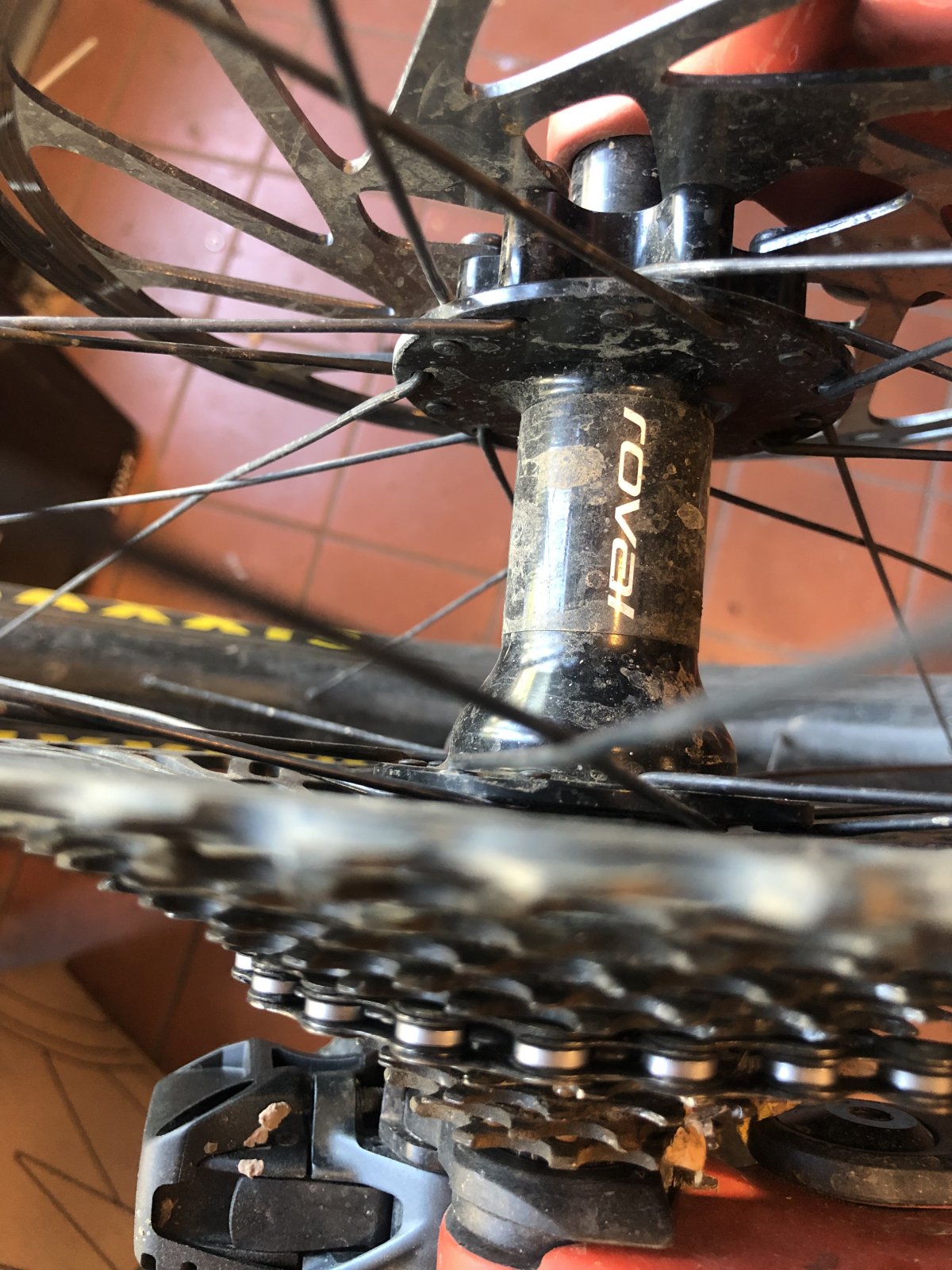

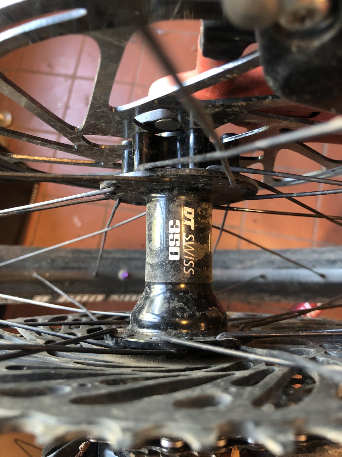

what rear hub comes one the Roval carbon rims on the Expert model?
Dave_B
Aug 29, 2020
1,470
1,601
Newquay
Ok thanks. So a DT 350 hub. Do you kow which star ratchet is in there? I’m presuming it will be 32 teeth?
