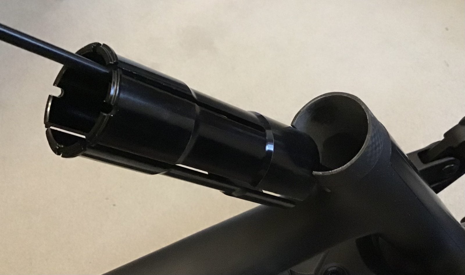

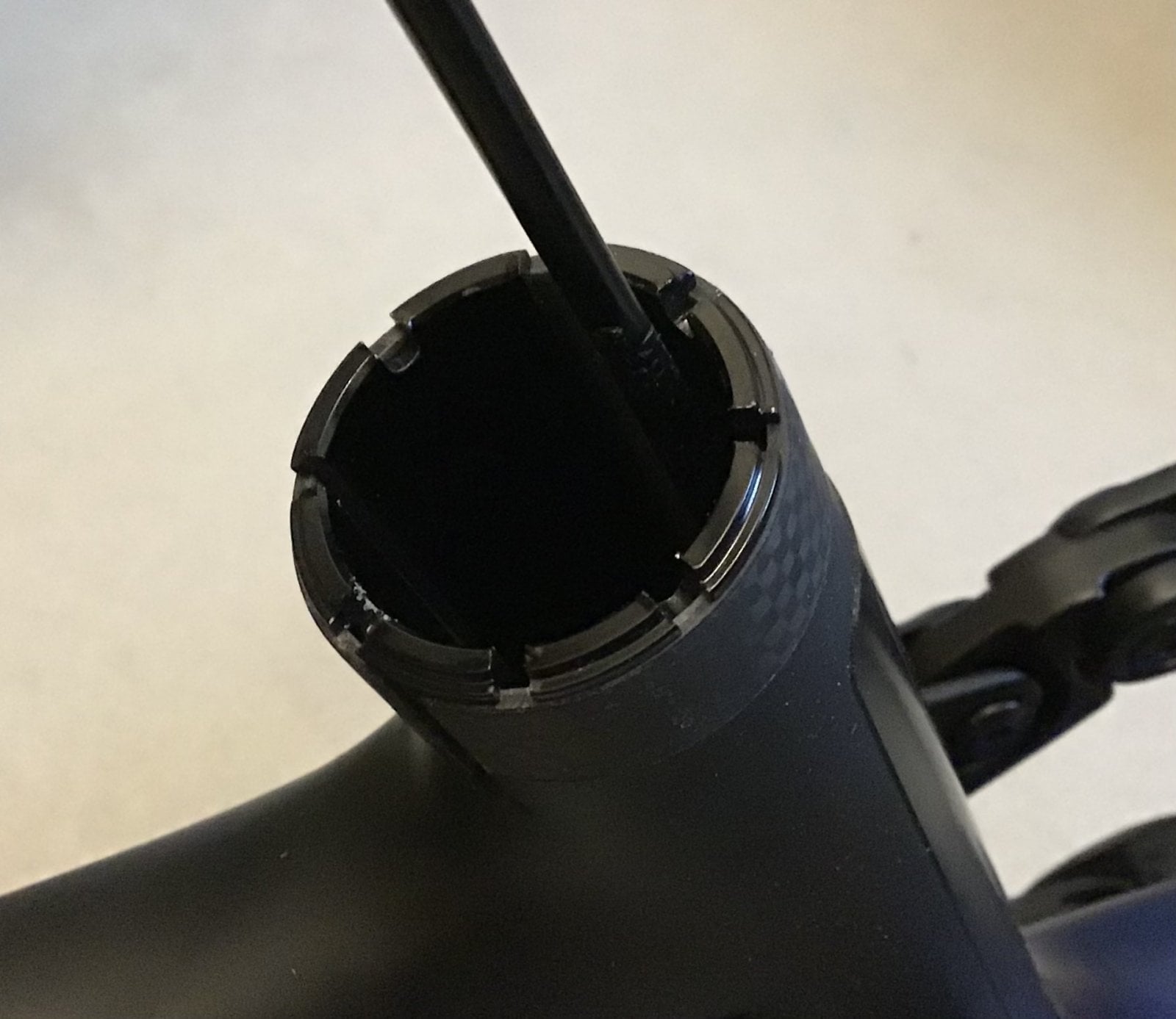

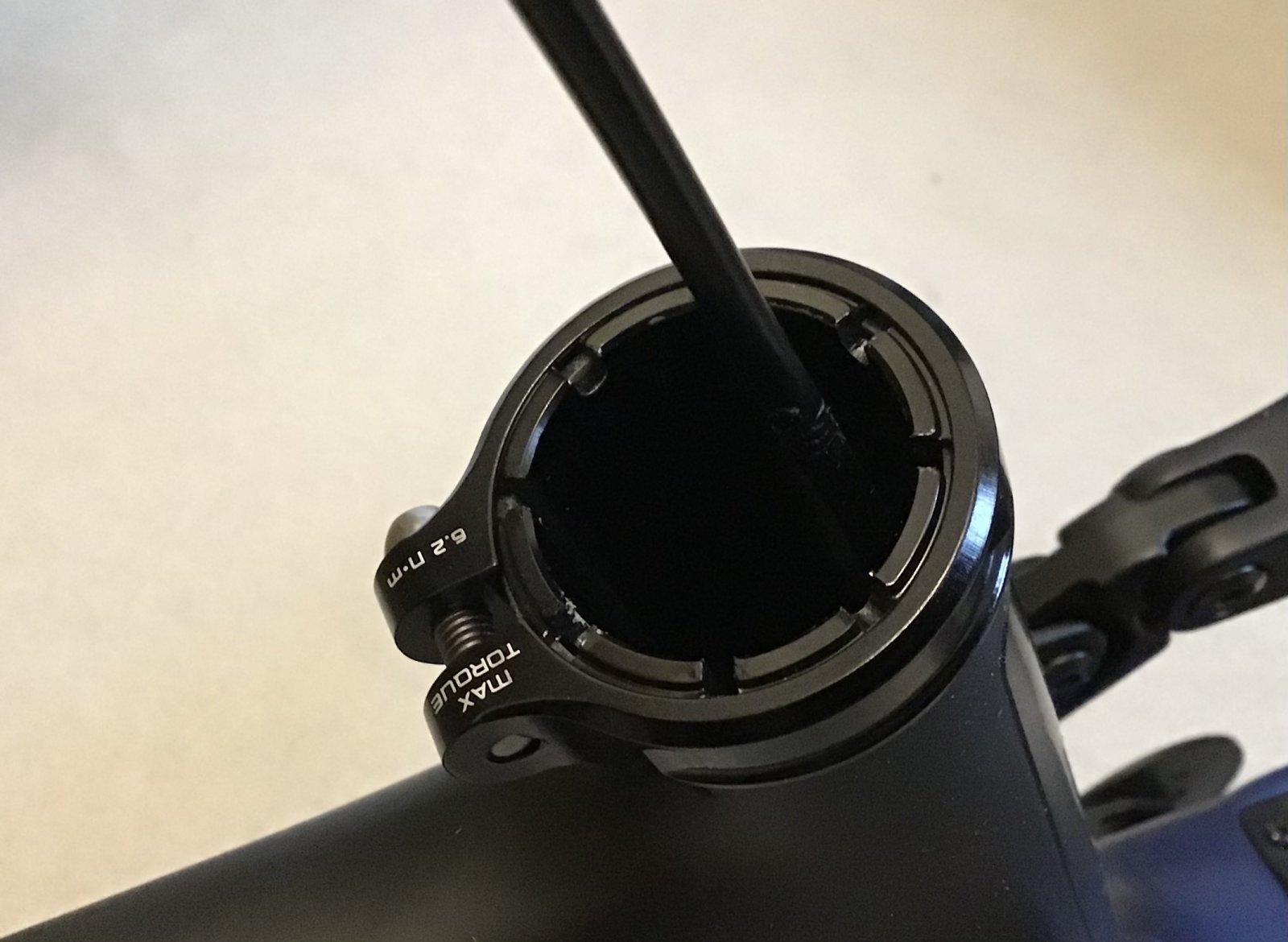

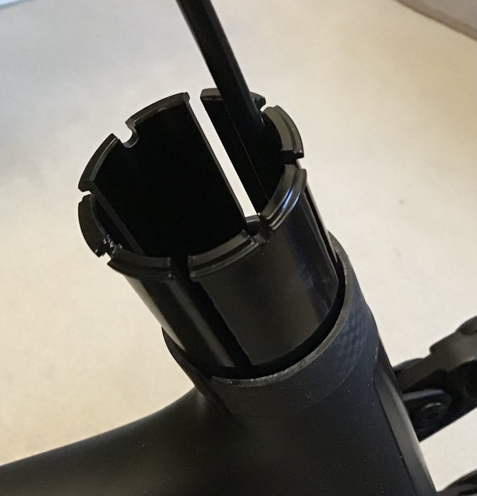

All the Shim and seat tube information was put in Post no 2 several months ago when the mods did one of the first thread cleans so the thread wouldn't be cluttered up with the same questions over and over and over and over and over and over ..
and over and over ... :unsure: :)
This is for the SWorks, not sure about the others but I would presume all the carbon models will be the same.
It is shimmed to 30.9 from 34.9 with a 100mm long shim, although it is not really obvious as the seat post clamp hides some of the top of the shim.
See the photos below.
