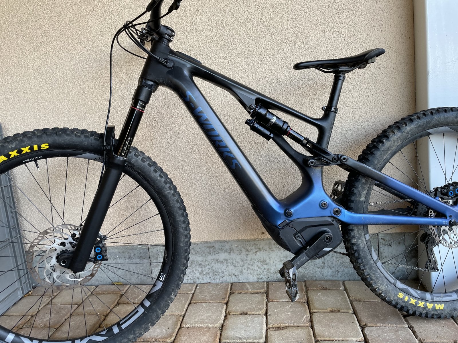

Hi !

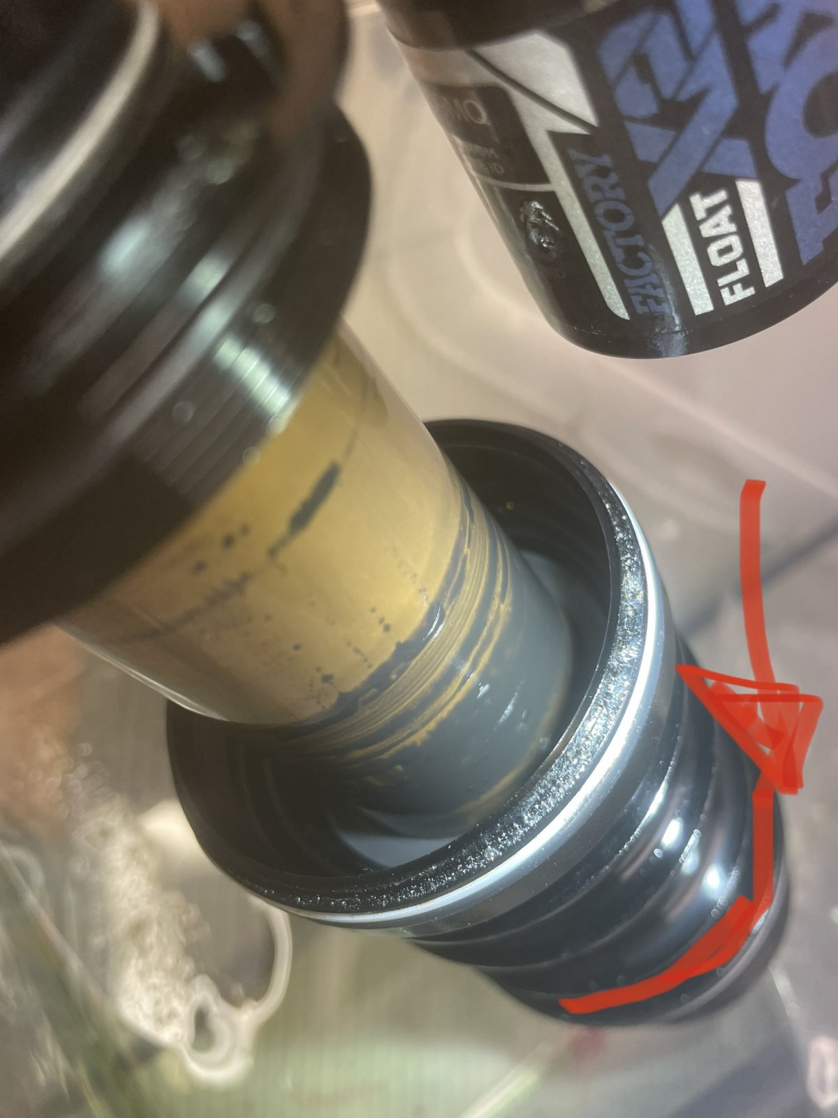

Today my X2 in the S-Works is blown. After 2 months of riding trails and jumplines i could see black residuals on the shaft. Looks like the seals were running dry and grinded away. A few rides later the shock lost 50% of the air pressure suddenly.
I‘m now asking me if a warranty repaired shock will not have the same problem. Perhaps this is a design problem of the yoke-linkage which gives the shock extreme sideloads.
I‘m runnign with 210psi/2airvol spacers/80kg
Are there same issues with your X2 ?
If the compatible coil optins where cheaper i would swap to that, but i actually only see EXT and Push as robust yokelink compatible shocks
Best regards,
Chris

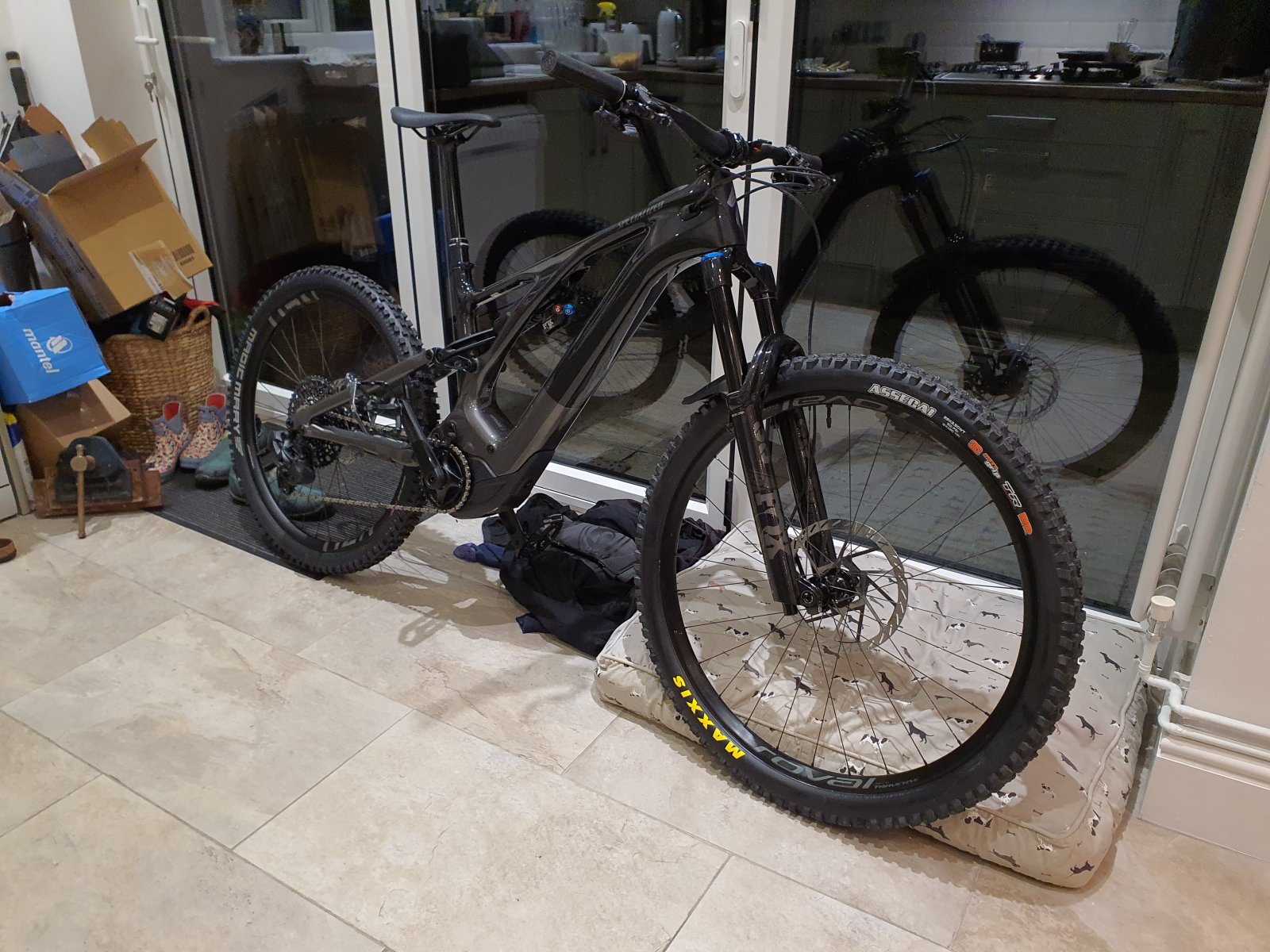

nice and shiny again after a few days at bike park wales …….. this bike is perfect for U.K. trail centres ! I had 2 riders on Kenevo SLs in front of me going down VV at BPW and they had to stop a 3rd of the way down to let me past because this bike is a machine and on tight + windy trails it leaves the Kenevo for dust. So happy with the bike !

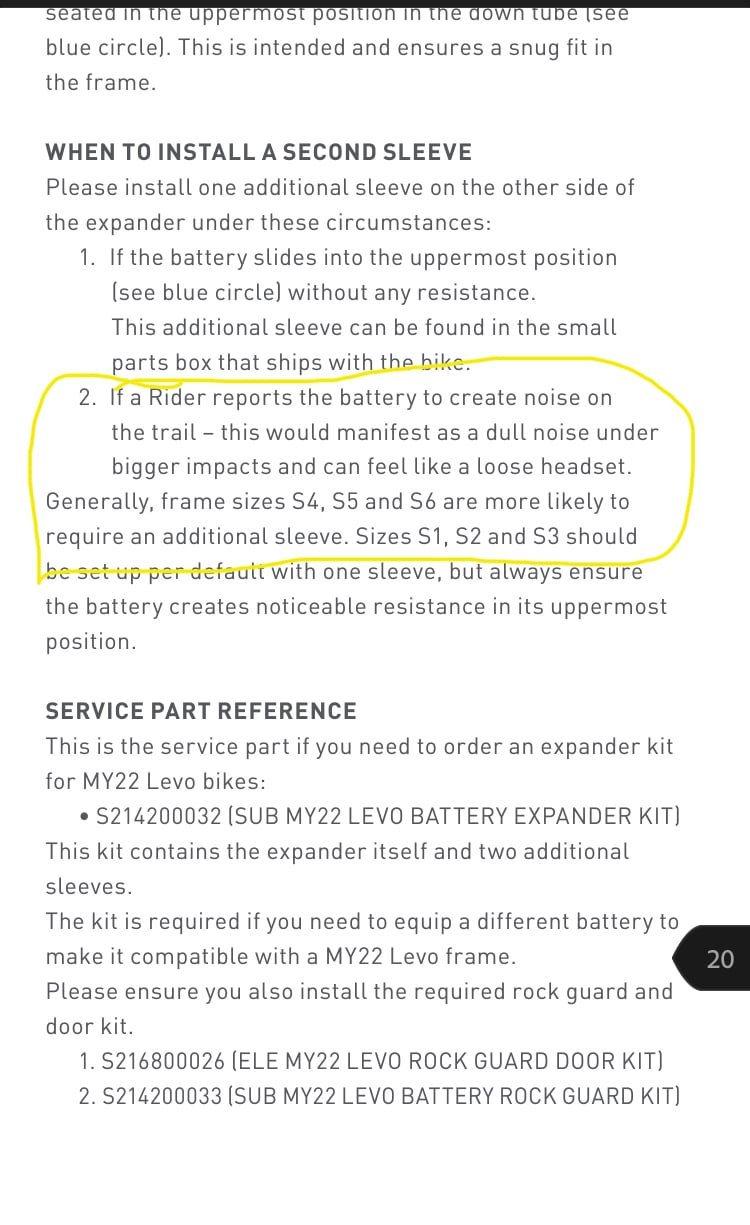

Interesting you say that. I have a knocking which sounds like the battery knocking over rough ground.
Are we thinking this is more likely to be the shock instead ?

Interesting 🧐 my X2 also had a knocking, also detected im the stand when bending the rearwheel
sideways left/right it knocked from inside the damper.
I watcheded into my blown shock:
The inner airchamber sleeve was completely loosen in the connection to the eyelet. see the marking in the pic. I could rotate it by hand and it can bent a few degrees out of the axis. Normally this should be tightened to 20Nm. This could be the reason for the sealings gotten grinded down as seen in the black oil after only a few rides...

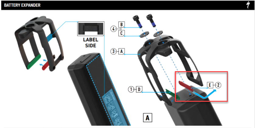

I have installed SRAM AXS in my Gen 3. the plastic cable routing sleeves have lots of potential to rattle, I did manage to pull them out (dropper and rear mech) from the tcu opening.
Also, the star ratchet on the carbon rims is not 24 tooth as stated above. I didn't count it, but looks like 52 or 36. I will get around to counting the actual number of teeth later.
and do we know what frame size needs the additional battery spacer? (E in this picture)
Is it that spacer that stops what sounds like the battery rattling over rough ground?

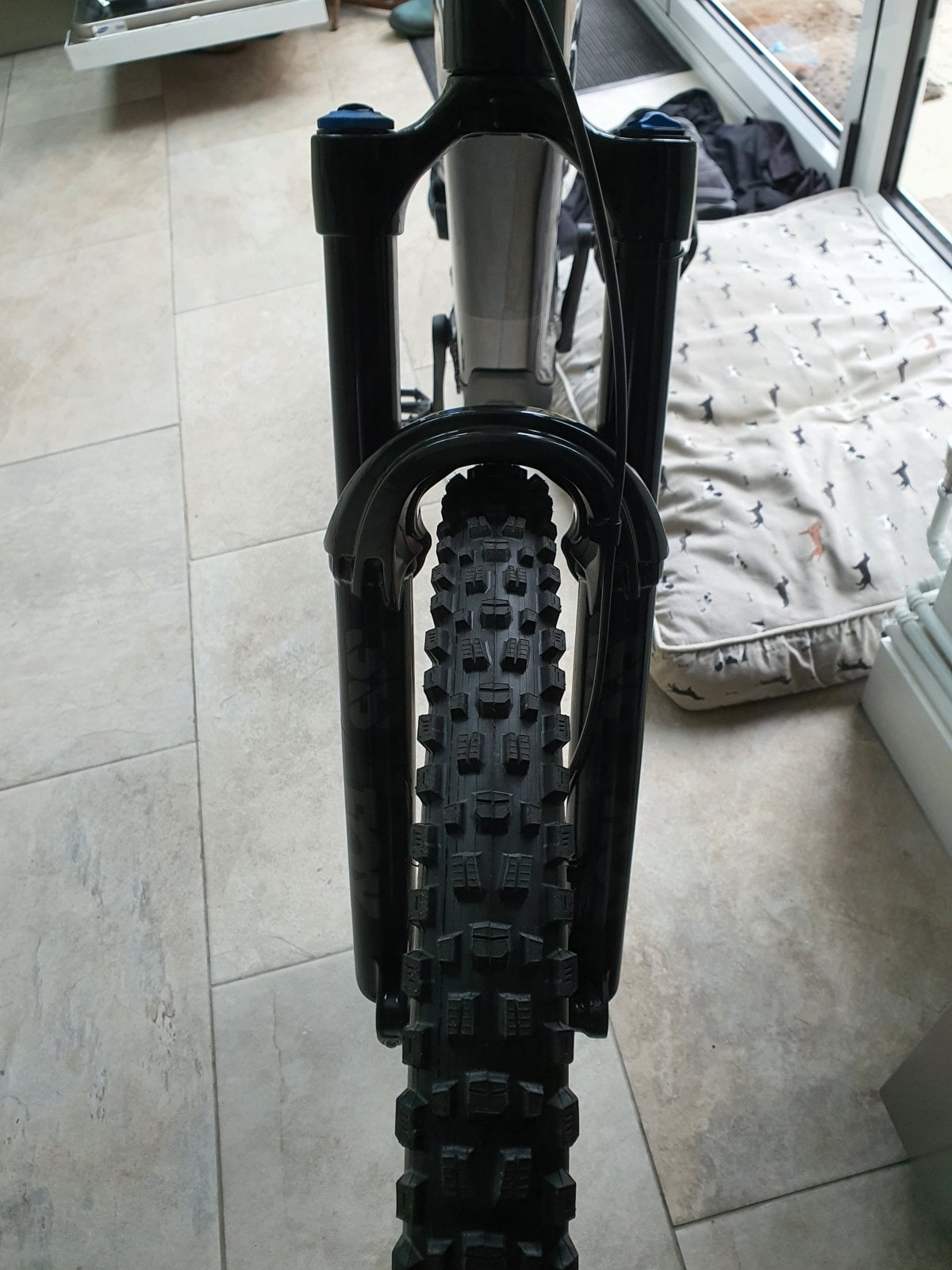

What rubber are you people using?
2.5 assegai and 2.4 magic mary looks absolutely anaemic on these things in real life. Hoping they bed in and get a little wider.
Wasn't that impressed with the butcher really I know Rob was gushing about them on YouTube but they lacked a little bite and are too wide to allow the bike to tip in as well as I'd like. Hated the eliminator. Mainly because it was a vague 2.6 again stopped the bike from being tipped into turns easily.
Had a 2.4 Big Betty out back for a month but was an oddly drift-y tire
Utterly Smitten with this bike though. Coming from a 2019 stumpjumper it's corrected everything that was wrong with my stumpy in terms of geometry, handling and sizing and build issues. Only complaint is the rear shock is a bit pants. Keep eyeing up the new 22 DHX (yes... warranty) but we shall see.
Interesting to hear you say about the standard tyres being a bit rubbish. That is how I feel about them too.
I find the there is a big gap in traction on the front tyre when leaning it over and the rear feels horrible and squirmy.
What are your issues with the rear shock out of interest?

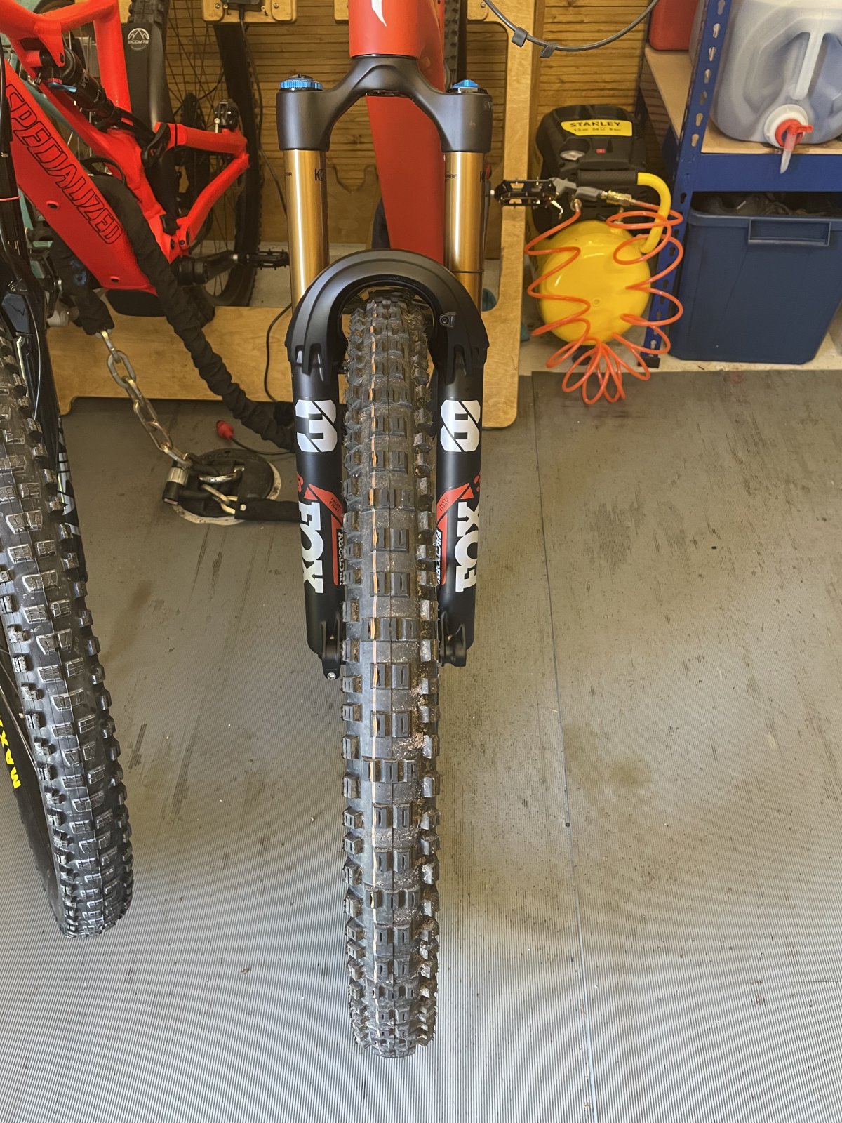

I've put a 2.6 eddy current on the front and its like sh!t to a blanket on most trails.
I used a Big Betty as a rear tyre and would do so again if I could find one in stock!
I think a Magic Mary is also a great tyre. Never used one on the rear, but might give it a try.
I wouldn't go bigger than 2.6 on either end, it could all get a little vague.
How does the 2.6 Eddy measure up? I did consider one actually, just thought it might be no good come dry hard pack.

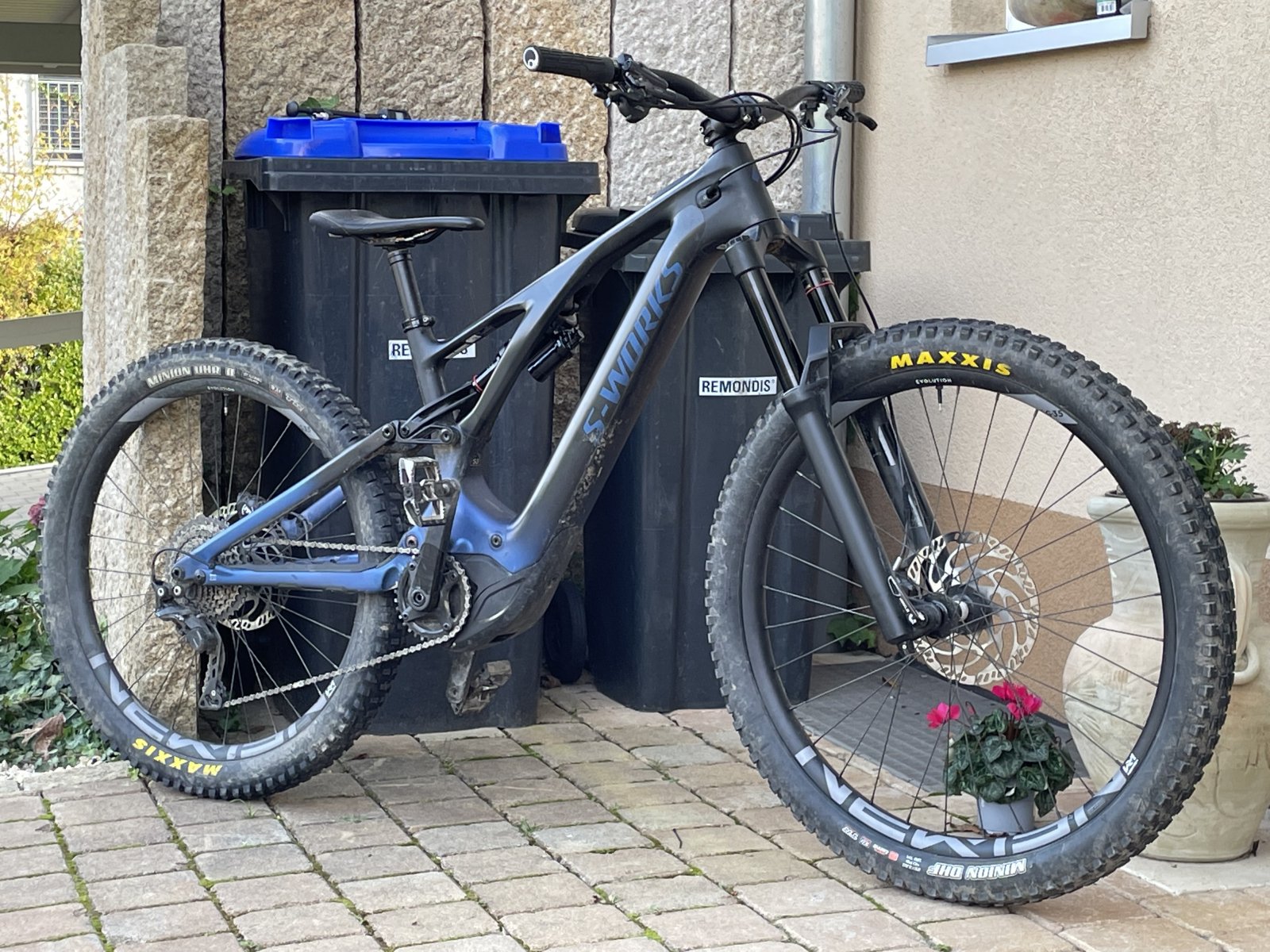

Hi !
After my X2 was blown and another X2 has the same sideplay feelable on the air seal when flexing the backwheel i tried a Super deluxe. First ride was promising, little bit less small bump plushness. but i will retune from
low reb/comp to Med tunes and update with the Megneg Aircan. The damper seems to be mechanically much more stable without any visible bushing play atside loads compared to the X2.
I hope to reach the same damping performance as the X2 with a better robustness. This shock costs half the price of X2 and reduces weight by 250gr.
--> I will report after the first rides with the Megeneg Can and Med tune with my experience...
Here my robust economy build. 21.2Kg w/500Wh battery w/o Pedals:
