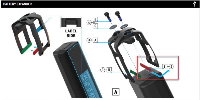

and do we know what frame size needs the additional battery spacer? (E in this picture)
has anyone else with an S4 pulled out their battery to see if they have the additional spacers installed?

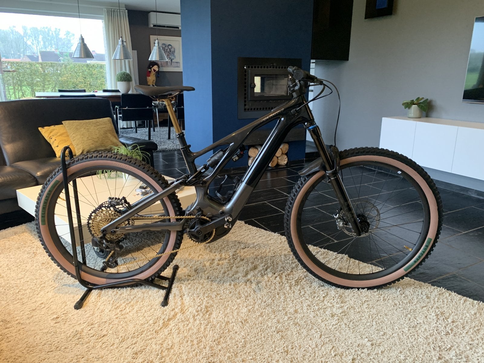

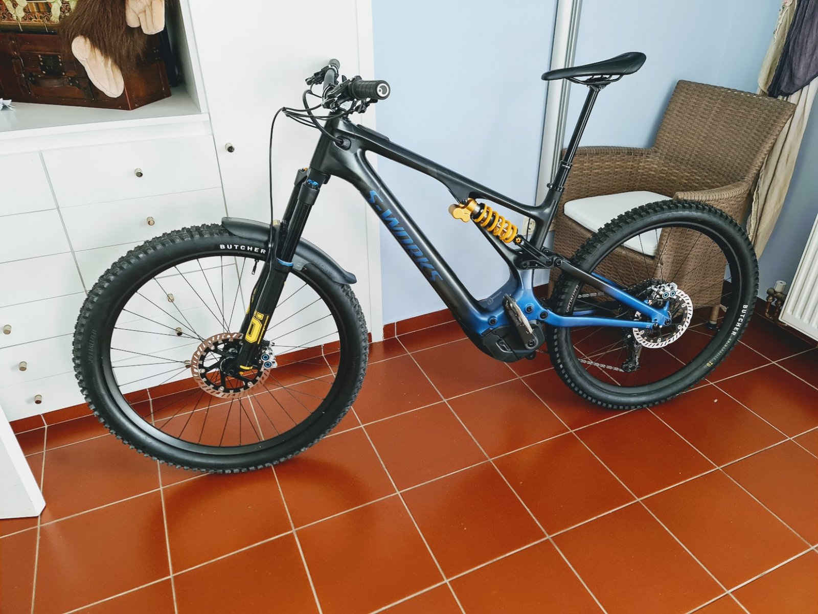

That's my new "Beast"....with a lot of changes up to the stock model (carbon Roval rims, tan wall tires, carbon Roval handlebar, Eagle XX1 cassette & chain, Fox Transfer seatpost, chainring 34, Magura MT7 brakes...coming carbon cranks :) )

What size bike have you got?
Will be interested to know what spacers are installed.
Taking the battery out is so easy as well. So simple to check.

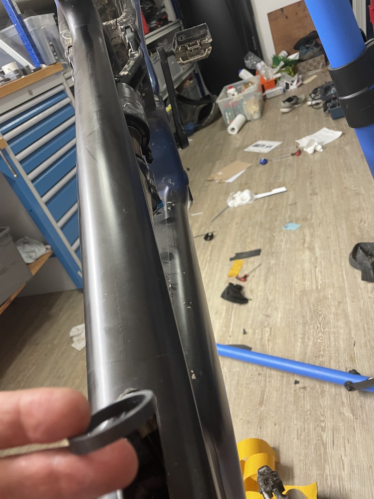

FYI
Hey there,
i had extreme knocking/ rattling sounds, always on shaking root lines. sounded like a loose part knocking from inside the frame.
But Nothing to hear when shaking the bike in the stand.
I now searched all the frame internals several times and found that Specialized imtegrated me some secret Swat spare part:
That carbon spacer was in the top tube end near the seattube and rattled as hell !
Perhaps other rattling levos also have integrated secret spare parts by speci assembly line ?
Best regards,
Chris

Interesting. I have an S4, it has not addition spacers and couldn’t re insert the battery when I tried one spacer.
Can you feel resistance when the battery is at the top of the down tube? if not I think it may need a spacer, Im not sure, but are there different sized spacers for different models?

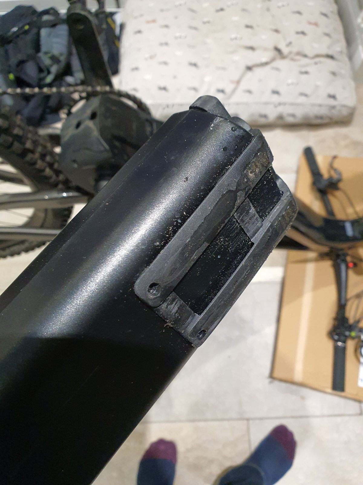

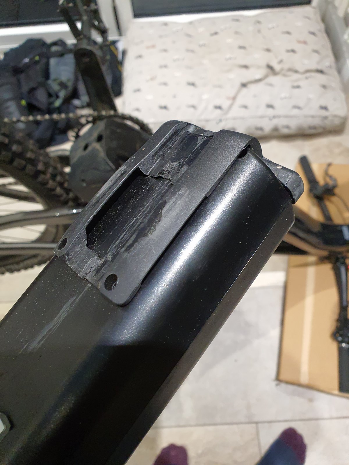

Don't think I have the spacer..... S4
Excuse the mess on the battery. I didnt know I needed to back the screws off on the water bottle to remove the battery when I first got it.
With the battery out it does feel like that chatter is gone when I drop the front end on the floor gently.
Possible to DIY this or can I buy a spacer in the UK?

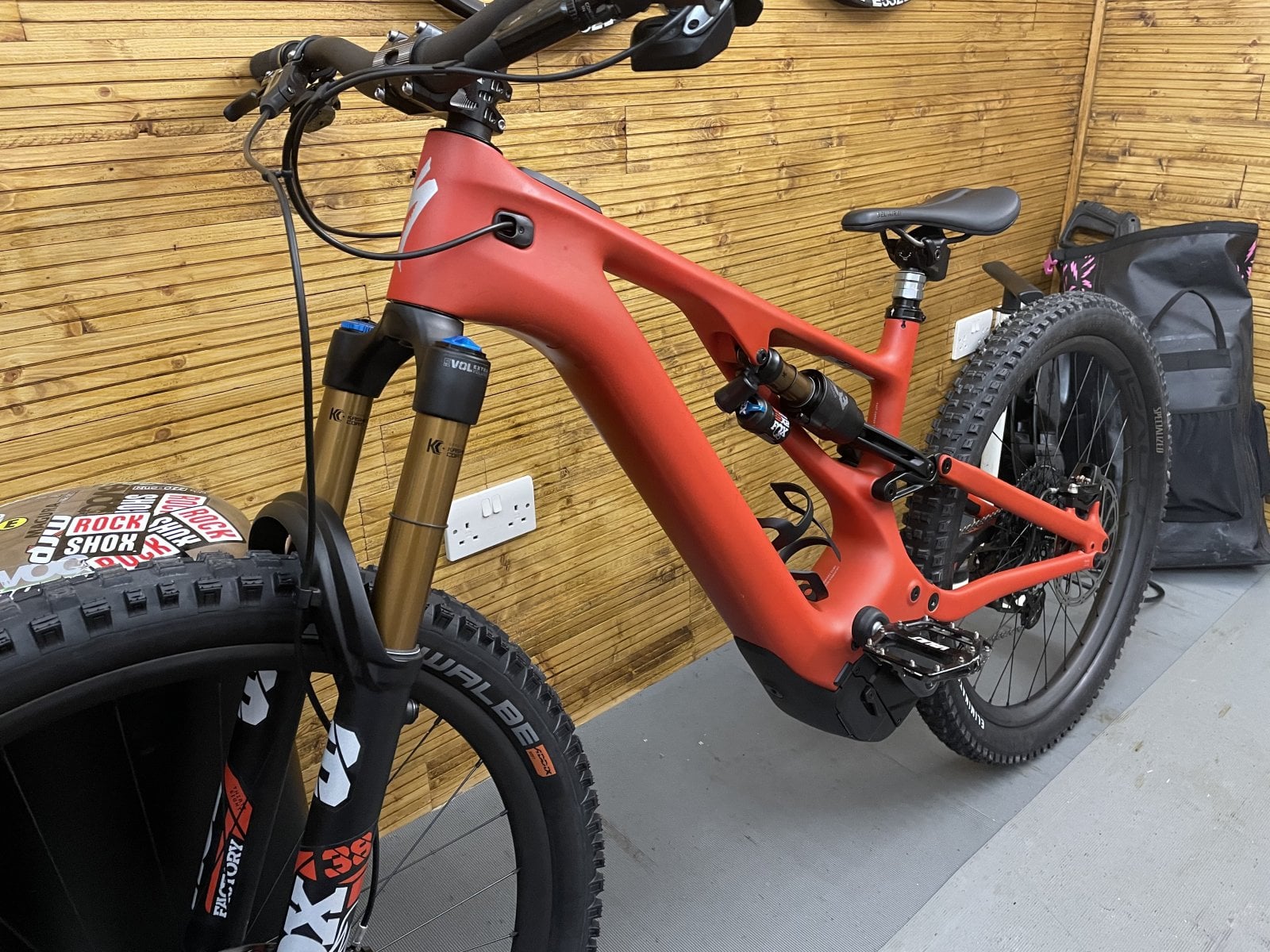

What mudguards people using on the fox38?
anyone tried the new fox xl ?
have a RRp bolt on but clearance is poor, don’t want to Cable tie anything if I don’t need to.
