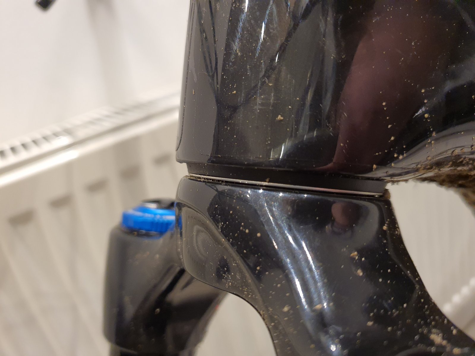

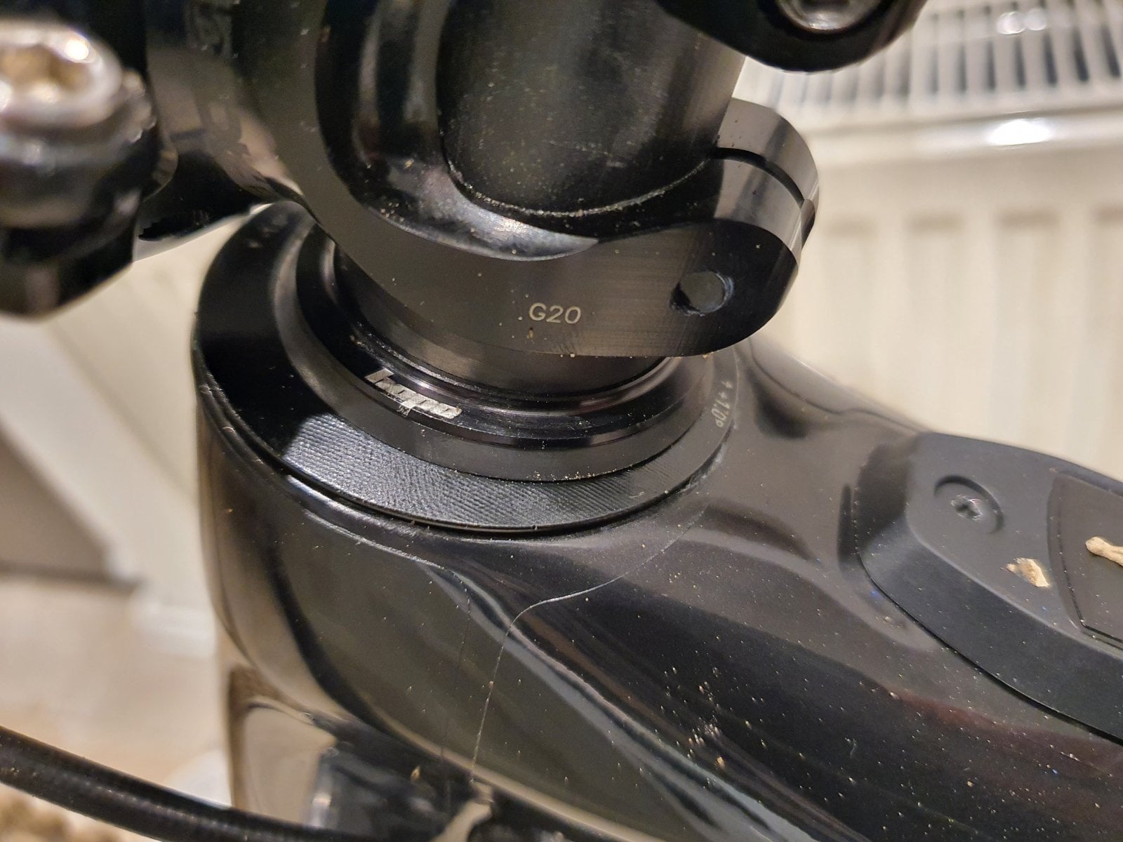

Further testing sorry
Rode without the battery. Rattle still there
Fox 38s are making a knocking noise. See video. Is this normal? (Need to point out that the above rattle is still there even when I rode with the Pikes)
Replaced the entire headset assembly hope stuff except for a ritchey gold upper bearing. No longer have any play in the slack cup. Much better water seal by the look of it too. Might also be worth me pointing out that I do know how to tighten up a headset.
There is obvious wear showing on the inside of the lowers as though the forks out of whack and its been wearing more in one section.170 air shaft is now in so my warranty on the 38s is probably done for. I think it works well but the rear end is lacking now. Still think my 38s feel harsh unless I run the pressure low and have to deal with bottom outs.
Something I've had since new. When I put it in turbo and pedal from a standstill then suddenly stop there is a knock when the motor cuts out from what I assume is the motor or the lower linkages. Is this normal please?
Thanks

Which Hope did you get? I might have to go this route, too to eliminate the play.
mike172
May 12, 2021
165
106
The pick and mix stuff. I bought from SJS cycles
3 Hope Headset Shim - Silver - 0.4mm - HS127 (sure the FSA one would be fine)
1 Hope 07 Upper Taper Ring - Silver - HS124S
1 Hope 07 Top Cover - Black - HS126N
1 Hope 1 1/2" Headset Crown Race - Silver - HS137S
1 Hope 07 Top Seal - HS125
Whatever you do don't get a head doctor.
Ritchey WCS Headset Bearing Gold 1.1/8"45°x45°x41.8 (Wiggle)

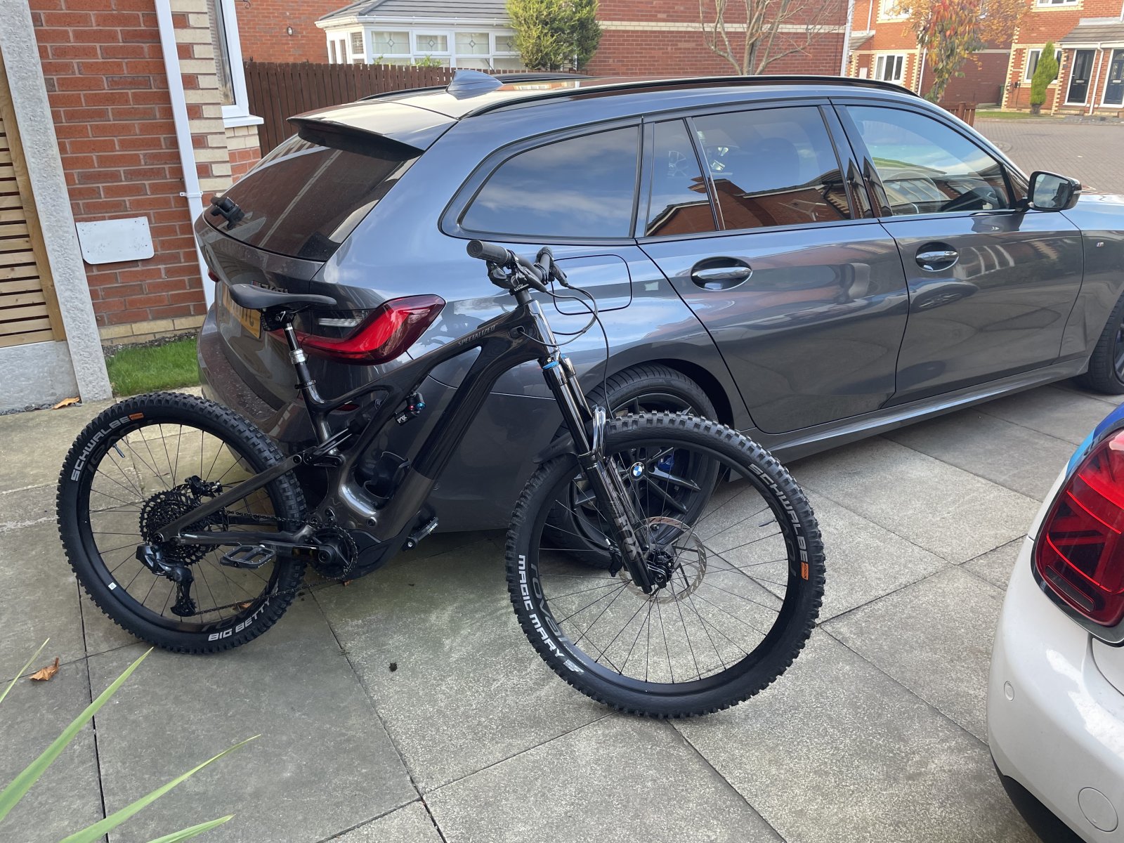

Hi
New here, picked up my Expert a couple of weeks back..
I’ve made a few changes, added XX1 AXS (with XX1 chain) and AXS dropper for a clean cockpit. I’ve run the AXS stuff on my other bike for a good year now and it’s been faultless.
Invisiframe to frame and forks
Schwalbe tyres, Magic Mary and Big Betty in Supertrail soft compound.
Sram HS2 discs.. 220/200.. I bought these for looks mainly but they have the added benefit of bringing the biting point sooner as they’re 2mm thick. I like the brakes to bite really soon and was contemplating changing the leavers to RSC to gain adjustment but now I don’t need to bother with that.
Specialized carbon bars 800mm wide, the standard ones are too narrow for comfort (for me) and Diety stem the same as the S Works model.
I’m only a couple of rides in but I love it already.
