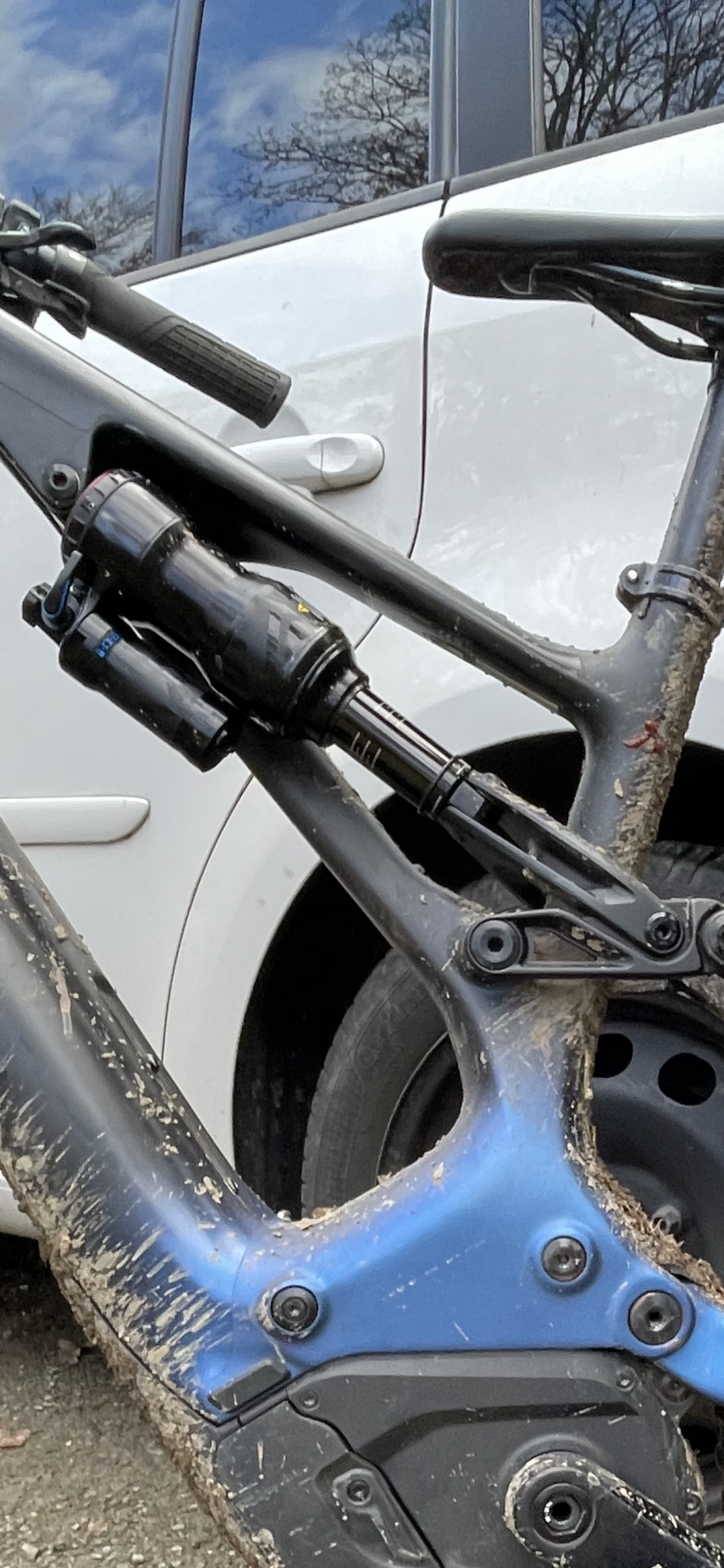

Hello Chris,
Interesting, so you replaced the X2 with an RS Superdeluxe and Megneg. Is-it a stock Superdeluxe (Midreb Midcomp) or one with a special tuning for the leverage of the Gen3 Levo?
Christox
Aug 12, 2020
88
80
Freiburg/ Germany
Yes,
After my X2 was completely blown after a few rides i replaced it. The X2 RX tune only has 1 less compression shim in the mainpiston stack compared to the standard light compression tune. This is an untypical very light compression tune for the high leverage ratio. I was not able to ride it with more than 25% sag on an enduro/ jumpline trail.
The Superdeluxe Ulti i bought had a Santa Heckler tune (Low/Low). I reshimmed it to Med/Med and with the megneg i am super happy. With 28-30% sag it now delivers a good compromise between enough plushness and enough support for jumps and hard impacts where the X2 was eating the travel too early.

Thank you Chris, it's good to know :)

Ive got one to try on mine with the meg. Not sure what the setup was though, on my old stumpy I had to keep the rebound very low and with the meg it sank well into its travel. Hard to get 25% sag at 300psi ha
Dont think much to the X2. Handles bigger hits reasonably well. doesnt have the small bump of a superdeluxe.
