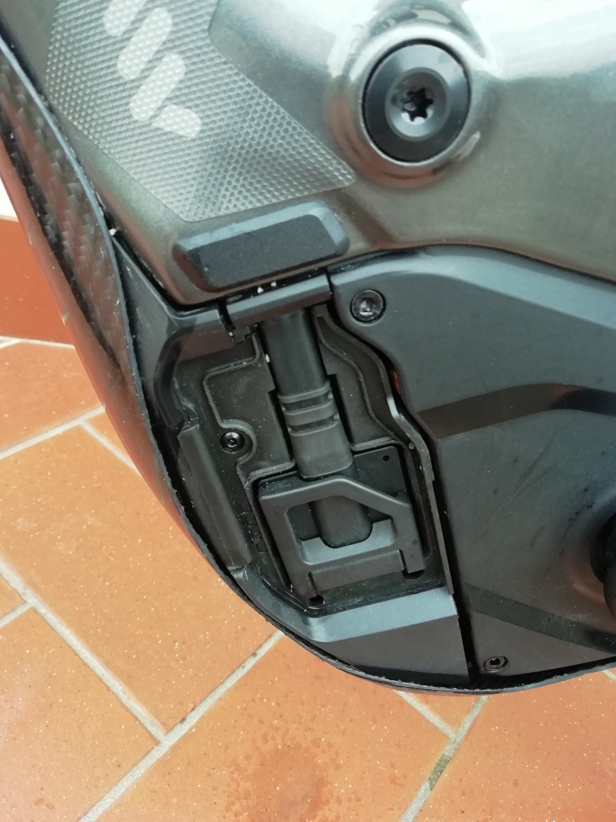

Hi All,
New to the forum and the world of e-biking. I locked in a 22 Levo pro a few months back and its been a blast. Been riding mtb and dirtbikes for years and this is an amazing middle ground. Reading through some of this thread it looks like the motor compartment door getting ripped off is becoming a common occurrence and has actually happened to mine. Already have a replacement coming in but I did want to share that apparently Spec are aware of this and looking for a redesign but is not ready for market yet. Hopefully soon b/c its only going to continue to happen.
In the short term I'm trying to figure out a short term solution where the door stays secure beyond the magnetic latch....open to ideas but think either some safety wire or fabricate some type of hook/loop for inside the door that you have to manually disconnect when needed. Curious if anyone has done anything.
Thanks all,

Hi All,
Thanks all,
Drewsuf
replacement doors are available, in the mean time I used 3m black tape for a temp fix, or a lot of folks have just run without it

appreciate the response and have a new door coming in. My question is more to do w/ how to further secure when I put the new one on so it doesn't happen again.
I would suggest some self adhesive Velcro so you can make a band to go over the door and remove when the new design comes, I have some which I got at a sewing store!! which seems to work. Mine arrives in January!

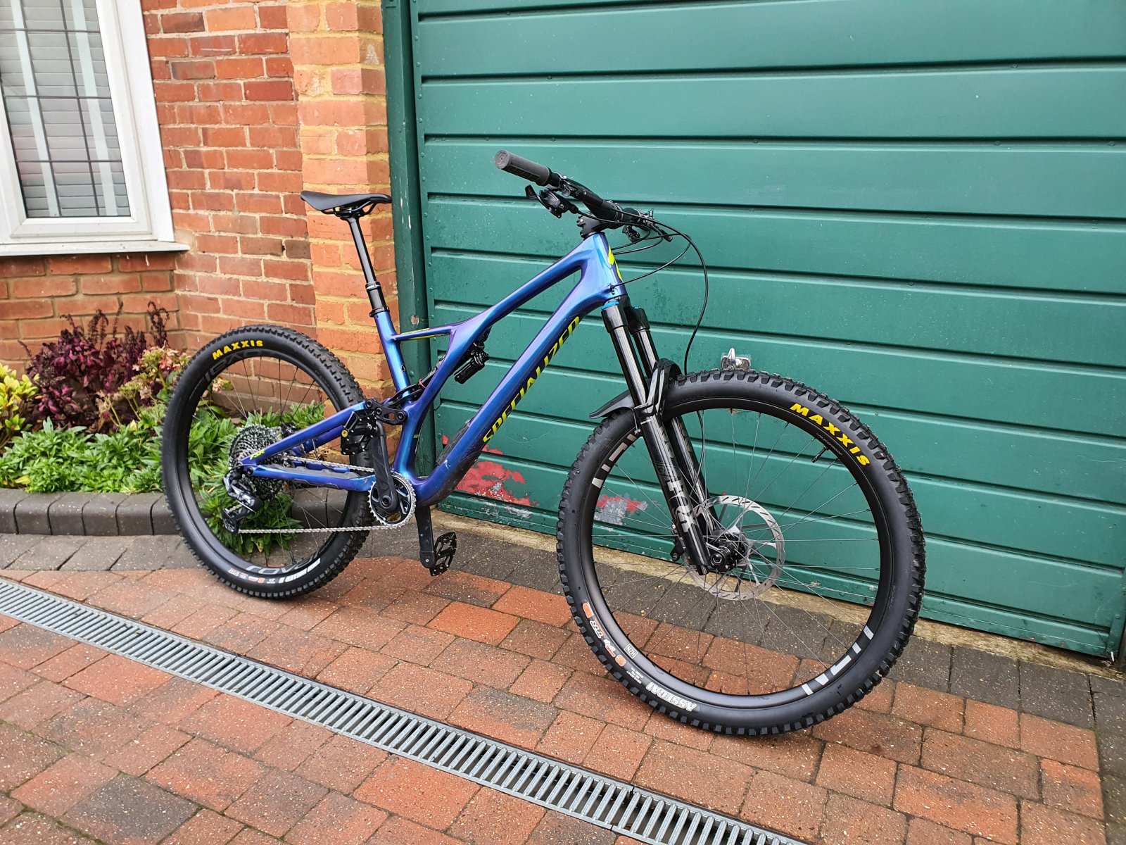

Dreadful ride today. Got my first motor cut out and motor error too. Yay. This is a brand new bike I got on 1st Oct. 2021.
I have two problems with the knocking I think
One is the fox 38 is knocking slightly. Almost like stiction is responsible for the noise but there's a video on YouTube here
My knock is less pronounced than that and only in the upper section of the travel. The fork feels pretty poor at 100psi+. At 95psi it's reasonably good but lacks bottom out support for my weight even with 1 token.
Second is I think there is play in the headset. Specifically the lower bearing cup that sits in the frame so I've either cracked my frame which I can't see or it's just defective (or maybe this is normal?) Going to try and shim this with something to prevent the movement and go from there. I've swapped out my bearings already and there's no bearing play in the cups. Pretty certain the race/compression bearings are snug too.
I swapped my 38s for Pikes (27.5 if anyone's interested in what a 27.5 converted Gen3 looks like) to investigate the fork and headset play. 38s still have the knock and the Levo still has the headset movement.
If you've ridden with even an slightly loose headset before you'll know how much chatter comes through
I wish I had never bought this bike. I swore I'd never buy carbon again after the very same problems with the stumpjumper and swore I'd never buy specialized again. Yet here I am with a levo.

Hello everyone, yesterday, at the end of the day of riding, I realized that I had broken and lost the cover of the battery plug of the Levo expert 2022, the thing that perplexes me is that I have not fallen or bumped into something, I took pictures and I sent them to the shopkeeper. I wait for an answer, if they have the spare part, if they pass it under warranty or not.
Kiwi in Wales
Short cranks rule!🏴󠁧󠁢󠁷󠁬󠁳󠁿
Jan 24, 2018
1,241
1,589
Carmarthen, Wales
I know @Specialized Rider Care have not responded on this forum regarding the battery charge door breaking........
However,
I contacted them directly on their website and this was their response.
The new doors are in production and should be available early next year. And like I said if you have any trouble with the door we can replace them under warranty.
Happy riding!

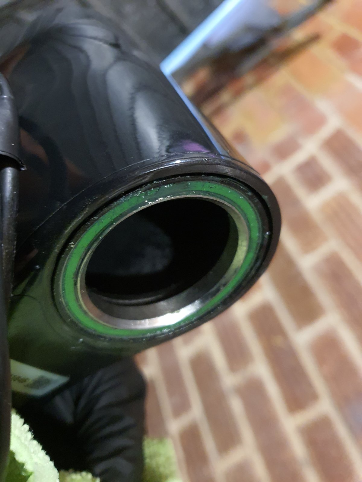

Further testing for my headset fiasco.
Doesn't have any movement with the middle/normal headset cup (tape removed). So this angled headset is an issue for me
Ordered a whole hope headset to go in I'll see if I can get anywhere with that. I can probably live with the middle headset

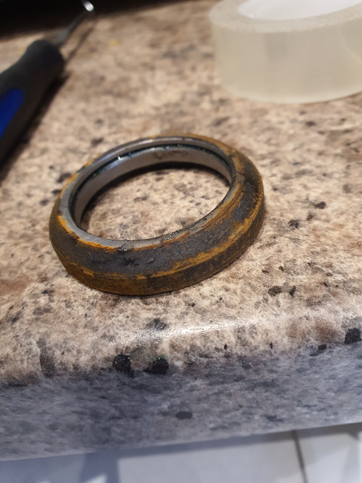

FSA bearing from my levo after 1 month attached. Fused to the bearing cup.

More rattle hunting updates (just in case it helps anyone not looking for a response)
Pikes fitted and went for a ride. Huge improvement (although 27.5 feels just like my old stumpjumper did) but still a small rattle over roots and rough chatter. This has improved since last time
I am convinced its a battery rattle which i am slowly improving with gorilla tape on the sides of the battery. I'm up to about 6 layers at the top of the battery about level with the spacer. I'll keep adding more until it goes. If I remove the battery and the rattle goes. I think the rattle is side to side rather than up and down the rubber battery cover spacer thing is supposed to stop.
Could be the internal routing. Not sure how to address that other than removing it. Also the rattle feels 'heavier' than cable routing to me. Plus the added tape seems to have improved this rattle.
My 38s are definitely harsh. I wonder if the damper is shimmed to hell with the tune we have on the levo. I may buy some new ones or an ohlins fork. See what happens with black Friday
My mode selector button no longer works. Why???
I'm regretting buying the bike. Total garbage in terms of build quality. Was utterly Smitten a few weeks into ownership until these problems started cropping up
Next step is to put the 170mm into the 38s and try eliminating any rattles or movement with electrical tape to shim the bearing cups plus more tape on the battery.
Might then be in a position to go to a bike shop like Berkshire or the concept stores and ask for help

This is exactly what I was getting on my Expert. The slackest cup gave the play, no matter how tight the stem and top cap were. Putting tension on the setup while tightening it all down sort of helped. Switching back 0 degree cup had no play at all.
