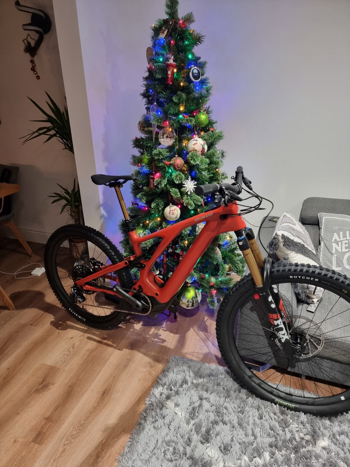

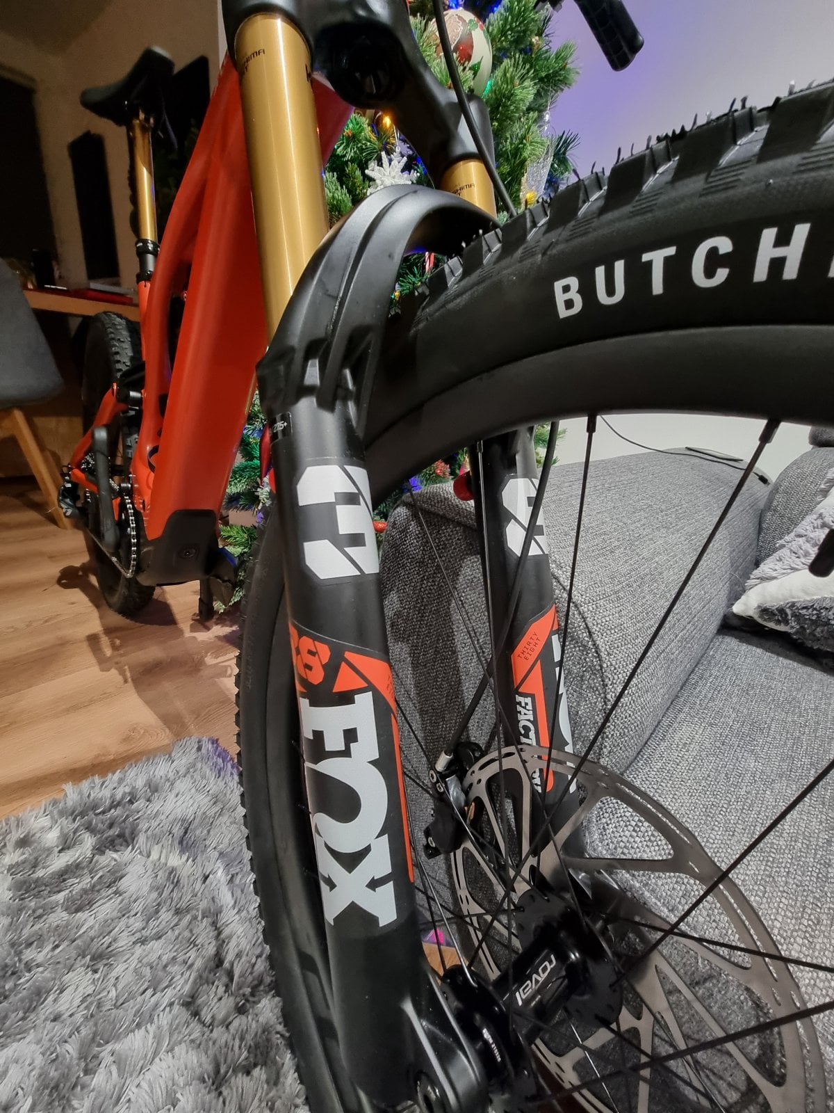

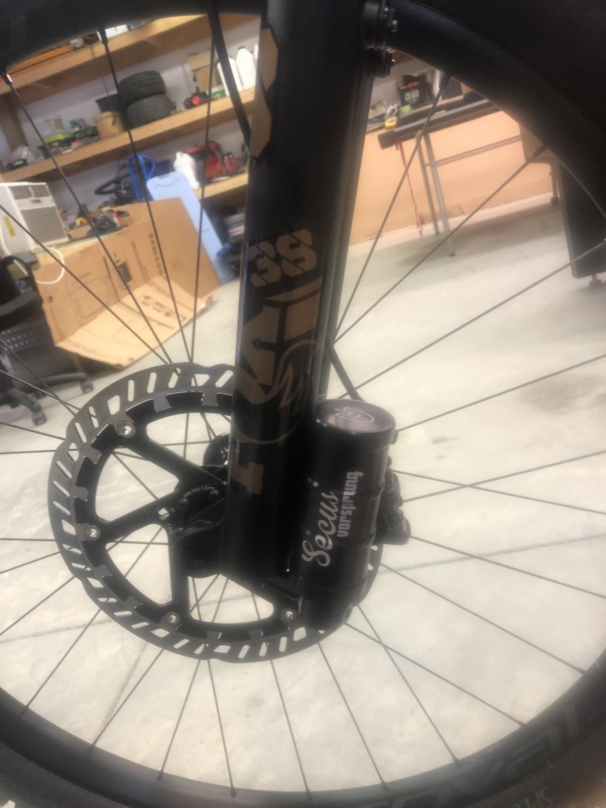

I threw a Secus on my 38, Crank Bros Synthesis wheels (waiting) and my X2 is being replaced by an 11.6 Very happy with the bike so far, but the Pro would have been the value for sure. Oddly enough, I believe my Bullit felt stronger motor wise and downhilled Better. All around bike goes to the Levo.

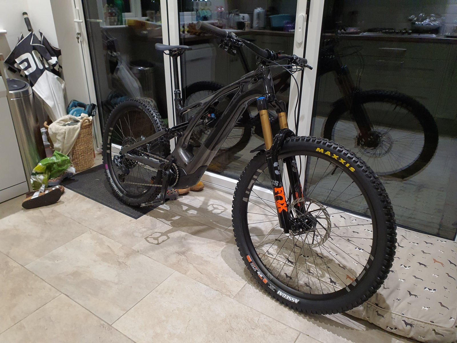

TFT have just fixed up my 38's. Posted in another thread but the bearings were too tight or had excessive play. The difference was so extreme it made me laugh
How does the shock feel? It’s OK, no strange noises and it feels smooth enough. It’s certainly not plush though but that is comparing to a custom tuned Ohlins on a longer travel bike. It doesn’t feel harsh and it’s reasonably supportive. It doesn’t blow through the travel and ramps up well at the end of the stroke.
The bike itself has some good rattles which is irritating. I have already fitted extra battery spacers and that’s quietened it down a bit. I need to do something with the internal cable/hose routing tubes as I’m sure they are source of the noise as has been mentioned previously here.
I have been lucky with my 38’s. I have them feeling plush already but I have had to back the HSC fully off. HSR is only 2 clicks from fully open. LSC about half way and LSR about 1/3 from fully closed. They feel nice but not as nice as the TF Tuned Charger in my old Boxxers. I’ll send them off to TF after the winter.
