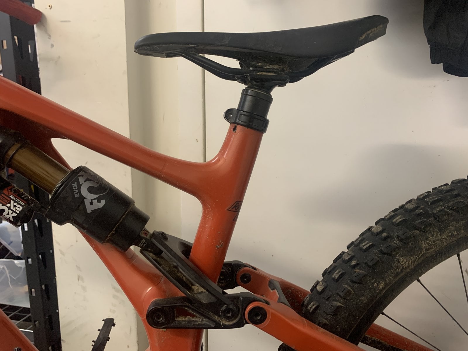

Here is the max insertion of one up 210 on my S5. 17mm away from flush.
Thanks that's great.
Inset lengths:
297mm on the 210 One Up
320mm on the 200 Transfer (inc. actuator)
I could live with an additional 23mm if the S4 I have matches up with that S5

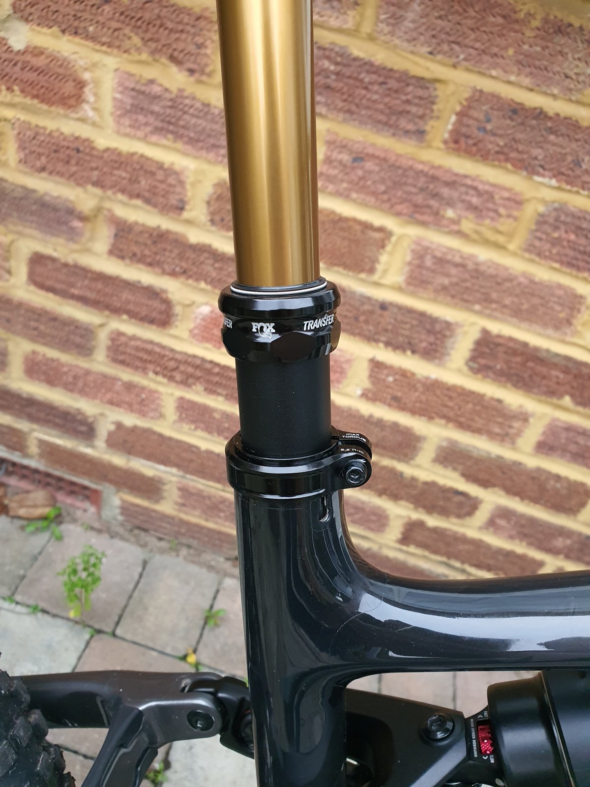

I went with the transfer to match up with the fancy gold stuff on the stanchions. Ill post up some photos once fitted in case its of any use to anyone.

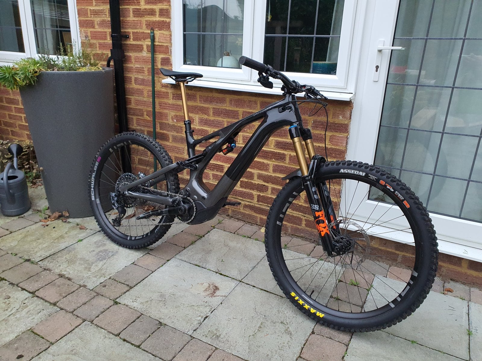

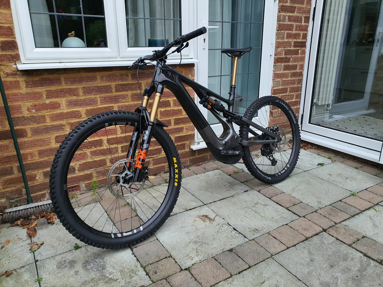

Put the Kashima goodies on it.
200mm transfer dropper on an S4.
That's as far as it'll go but needed a slight twist at the end and it dropped another 20mm or so. Pretty sure it operates correctly. Will see how I get on with it when I next ride it.
Why does my X2 knock as it breaks away? My performance and factory X2s do this. Pretty sure there's no play in the mounting hardware. Makes a slight bump/knock as it breaks away wherever it is in the travel.

That does look amazing. I’m surprised that there’s any performance difference between the Performance Elites and the Factorys given that the internals are identical. If there is there is though, the proof is in the riding! Maybe Fox have made running manufacturing changes.
The knocking will be the compression shims popping open. They get a little “stuck” (for want of a better way of putting it) together in the damping oil and will make a noise as they lift.
