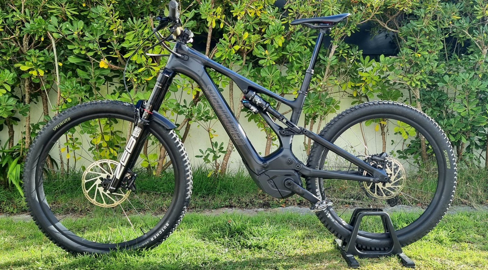

Thanks Stompweaver,
...I thought, that there is no room for a shim when going for a 34,9 seat post... this is exactly my question, because I doubt that I can use a shim... reason is that post I like to use is only available in 34,9 (for extra long, what I need)
Isn't the shim for like 30,9 droppers?
Thanks,
Tom
Our seat posts are 34.9 just insert, no room for shim. They shim the 30.9 to fit our 34.9
Gutch
Sep 10, 2018
453
242
South Carolina
SeatPost
X-Fusion Manic, infinite adjustable, two-bolt head, bottom mount cable routing, remote SLR LE lever, 34.9, S1: 100mm, S2: 125mm, S3: 150mm, S4/S5: 175mm, S6: 190mm

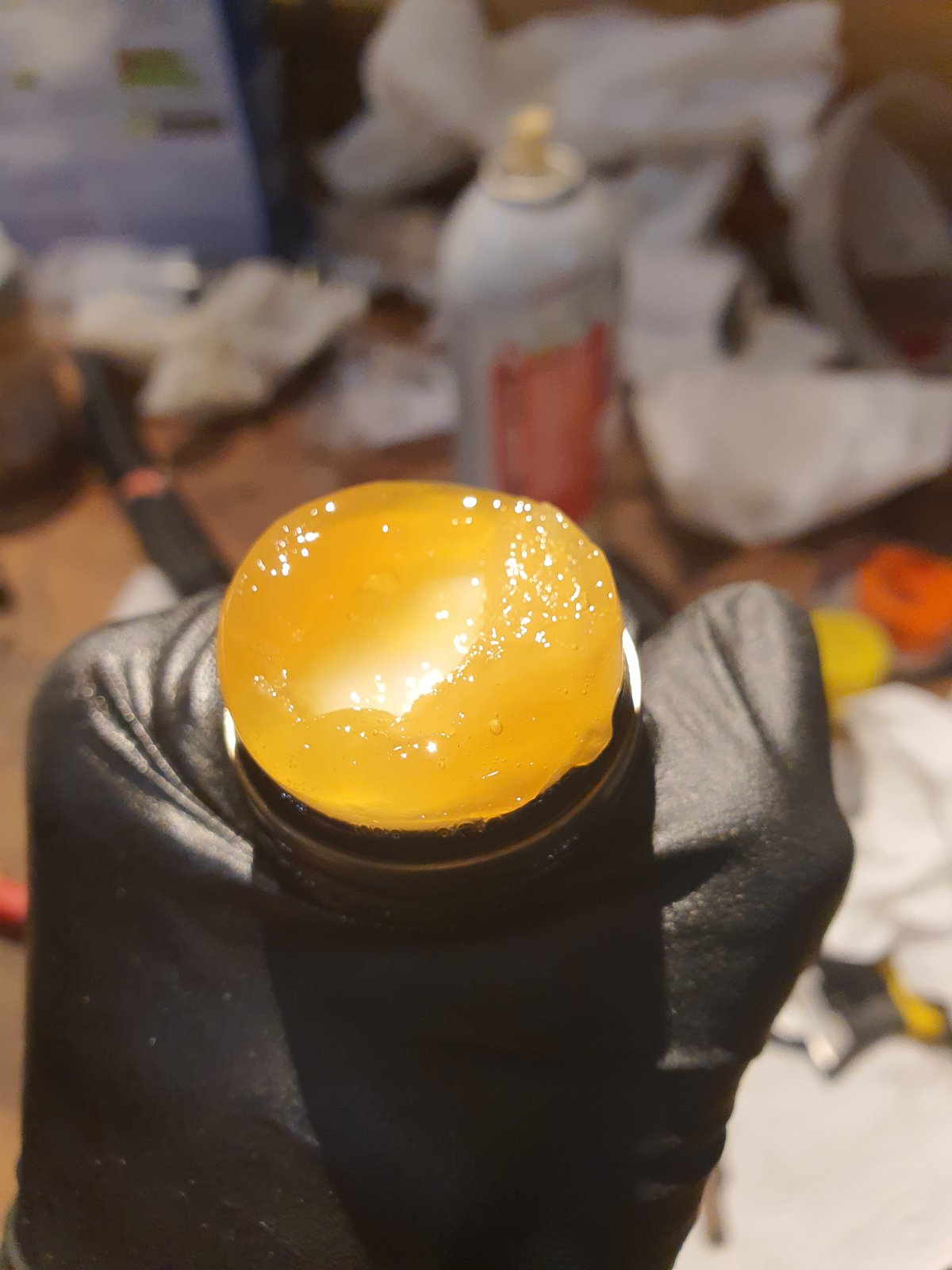

That does look amazing. I’m surprised that there’s any performance difference between the Performance Elites and the Factorys given that the internals are identical. If there is there is though, the proof is in the riding! Maybe Fox have made running manufacturing changes.
The knocking will be the compression shims popping open. They get a little “stuck” (for want of a better way of putting it) together in the damping oil and will make a noise as they lift.
There isn't really. Slight difference in tune.
The X2 factory is better in every way. I'm glad I have that now.
The 38 Factory forks did feel just the same as my Elites when they came back from TFTuned. Buttery smooth
Still full of grease when I opened them up today though.
If it feels better then it is better! Glad you are pleased and have a noticeable upgrade.
Was that grease on top of the air spring piston? That’s like having an extra spacer in it! Was there much in the negativw
mike172
May 12, 2021
160
96
Grease yeah Half that amount in the negative. Still more than enough
The stanchions had a load up in the top too
Be interesting to see what difference it makes tomorrow night
